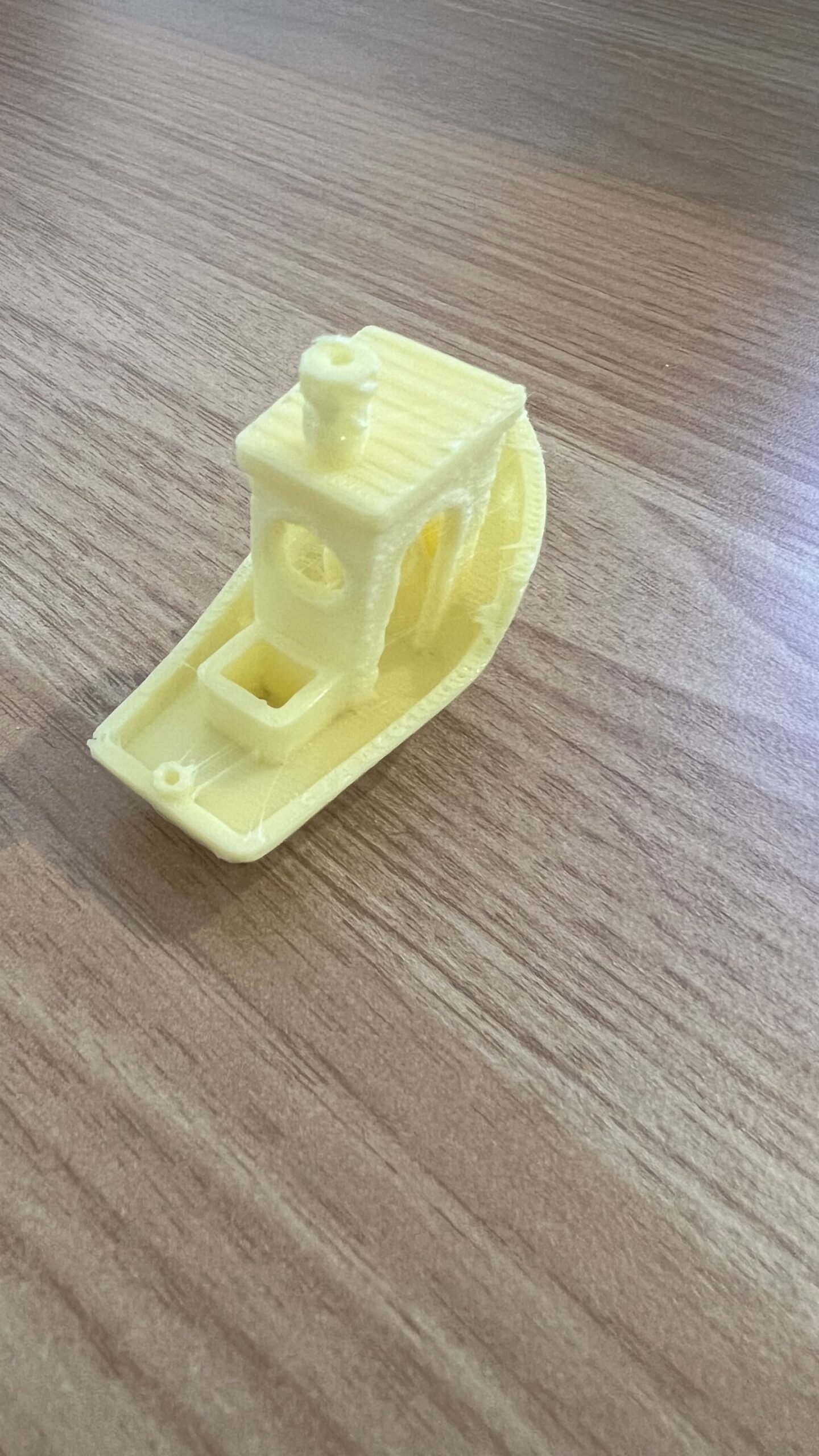

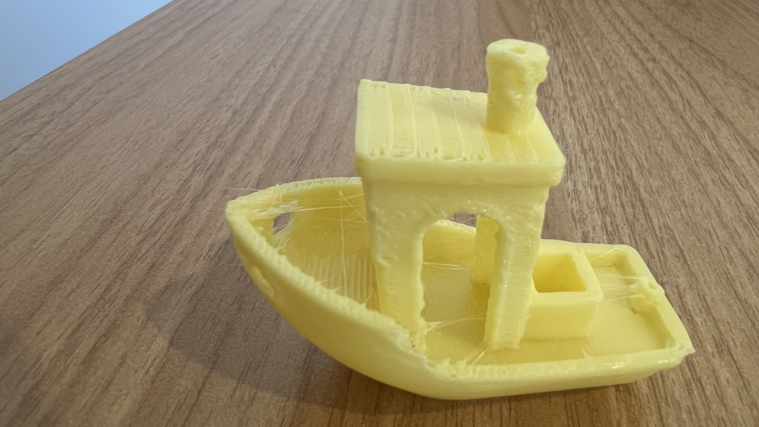

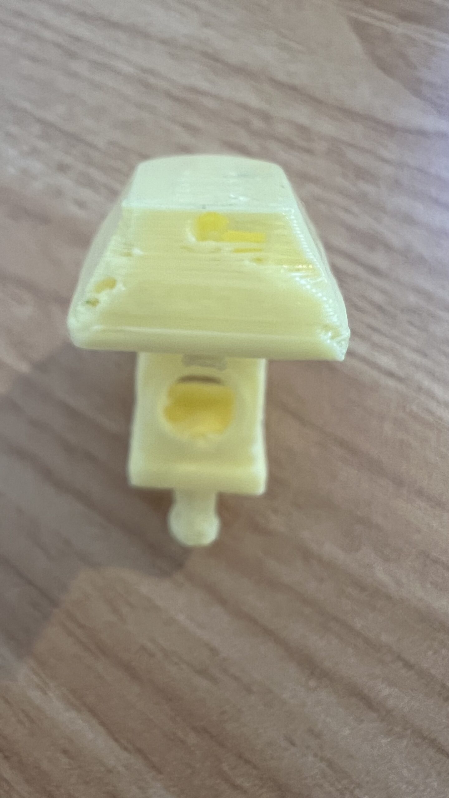

I was lazy to change my 0.6 nozzle... not bad either way...

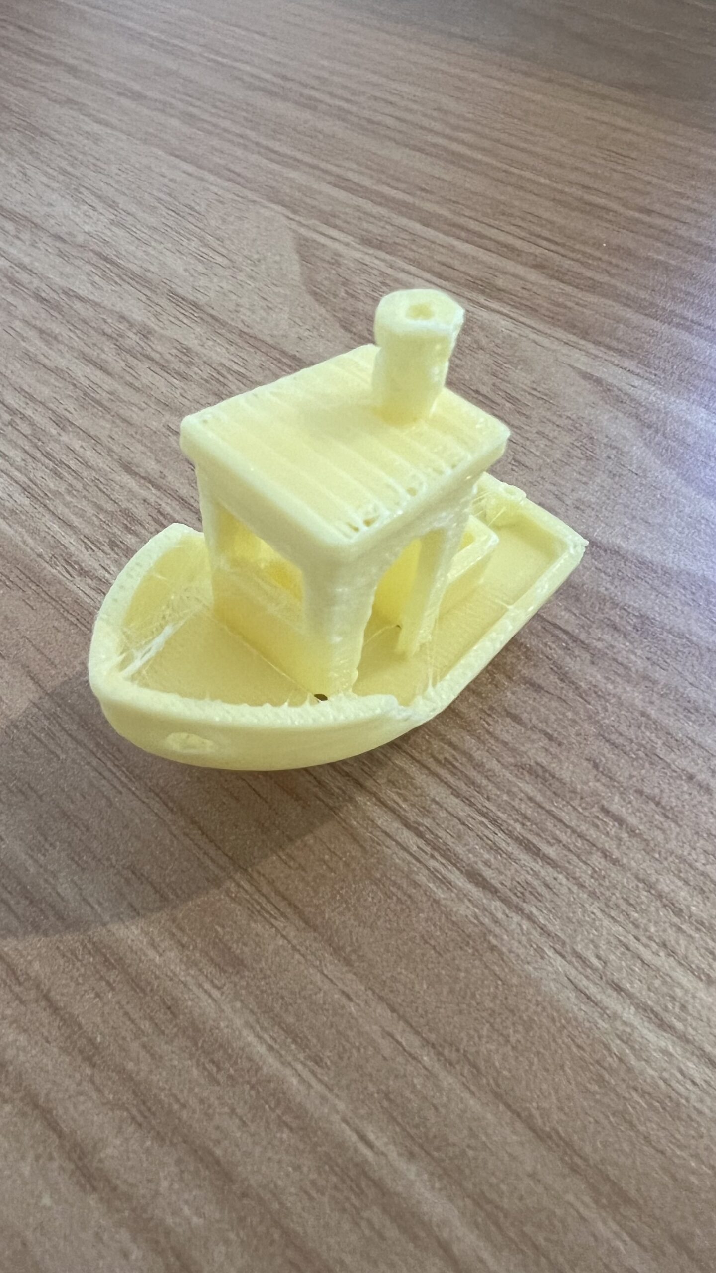

RE: 5.1.0-alpha1 Firmware for Original Prusa MINI/MINI+ with Input Shaper and Prusa Connect!
my first Benchy ever, around 16m Prusa Galaxy Silver
