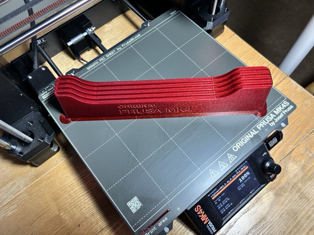

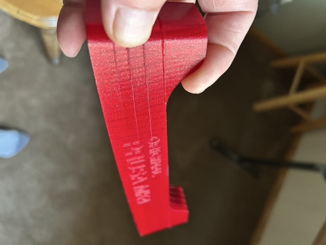

I've tried printing 2 items that have large(?) flat surfaces in both PLA and PETG. The first one is custom part for a Polaris Ranger that has a base of 14cm x 9cm (no pics) and the other is a plate holder I found on Maker World. Both of these prints warp, where the plate holder warps significantly more than the custom part. My printer is a stock MK4S that I purchased this past December.
Any hints on what I can do get these prints to lay flat? I've read quite a few posts in this forum and as well querying Perplexity. From reading the posts, it seems like this is just the nature of the beast. Is that correct or should a person be able to print large base objects without the warping?

In the original post I added images through the "Add Media">"Insert into Post" and for some reason they don't show up in the post.

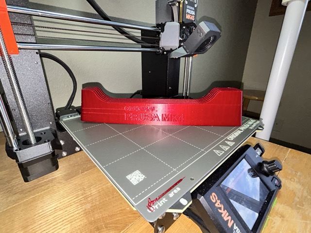

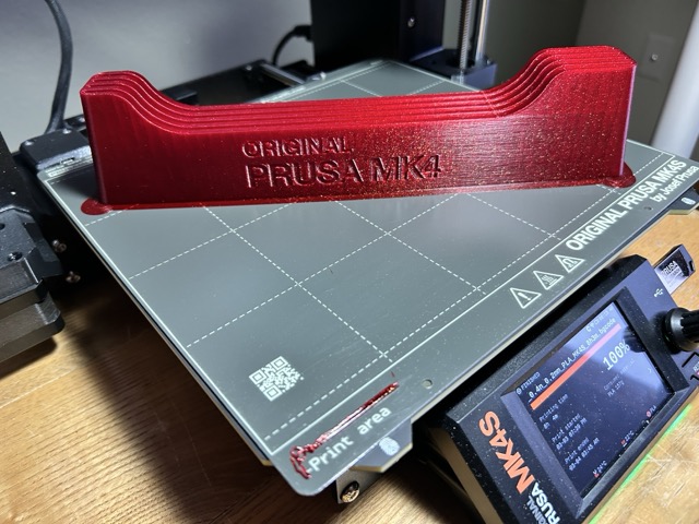

PLA print on smooth sheet. The center section was securely attached to the plate.

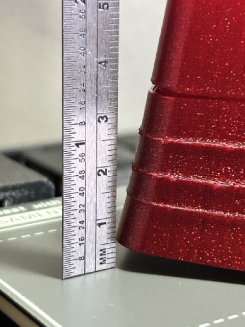

The warping on the other side was about 1/5 as much.

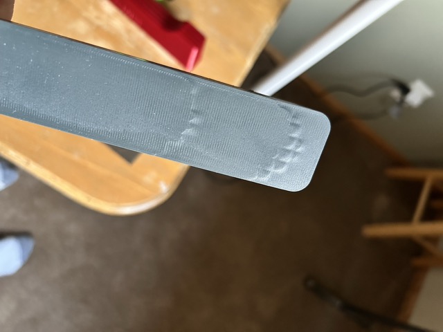

It looks like these lines are stress fractures from the warping. On PETG print one of the tops of the end just fell off.

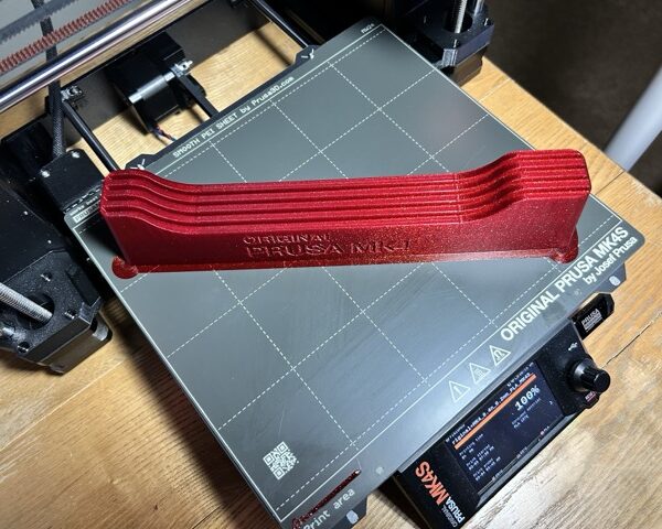

This is the underside of the PETG print. The ends were lifting off the sheet. When it cooled it was fully detached from the sheet.

The pictures are in your first post. But you managed to get some formatting information around the links. Which stops the forum from displaying the pictures. I don't know what causes this. And you seemed to do it differently the second time.

Thanks for the response. I've tried the brim with moderate success. I didn't try ears but your explanation showed me the light on how to add them in Slicer, although it took me a bit to figure out that you have to add them to the original object and not as individual cylinders. I've probably have changed too much at once but if it gets me further down the road at least one thing has worked for me today.... 😬 .
- slowed the initial layer to 5mm/s <- Slow down print speed (5-10 mm/s) for first layer(s).
- added the ears <- Add Mickey Mouse ears to the corners. There's a "helper disk" in PrusaSlicer's Add Part library but I prefer to simply add a cylindrical, maybe 10mm diameter, change height to single layer height, then place the part at the corner. Repeat for each corner.
- added the 5mm brim <- Add a brim around the model, 5 mm or more. Wider or 2-layer high brims may be needed but may not work with the size of the model or may require being added in your CAD software.
- ordered the bed weld <- Use Layerneer Bed Weld ( https://www.amazon.com/Printer-Adhesive-Layerneer-Original-Filament/dp/B079984GV5/ ), Magigoo, etc. You only need a thin layer.
- Disabled the fan for the first 3 layers
- Full fan speed at layer 6
- Moved the printer away from the wall (it was against the wall that separates my office from the garage)
Read the article, thanks.
I will research the "live Z" part.
RE: Print warping - large(?) flat surface - PLA & PETG
The print turned out much better after the tweaks. I did notice a slight warp after cleaning up the brim though. It something I can live with as I am learning which levers to pull and buttons to push. Thanks again @foxrun3d.
