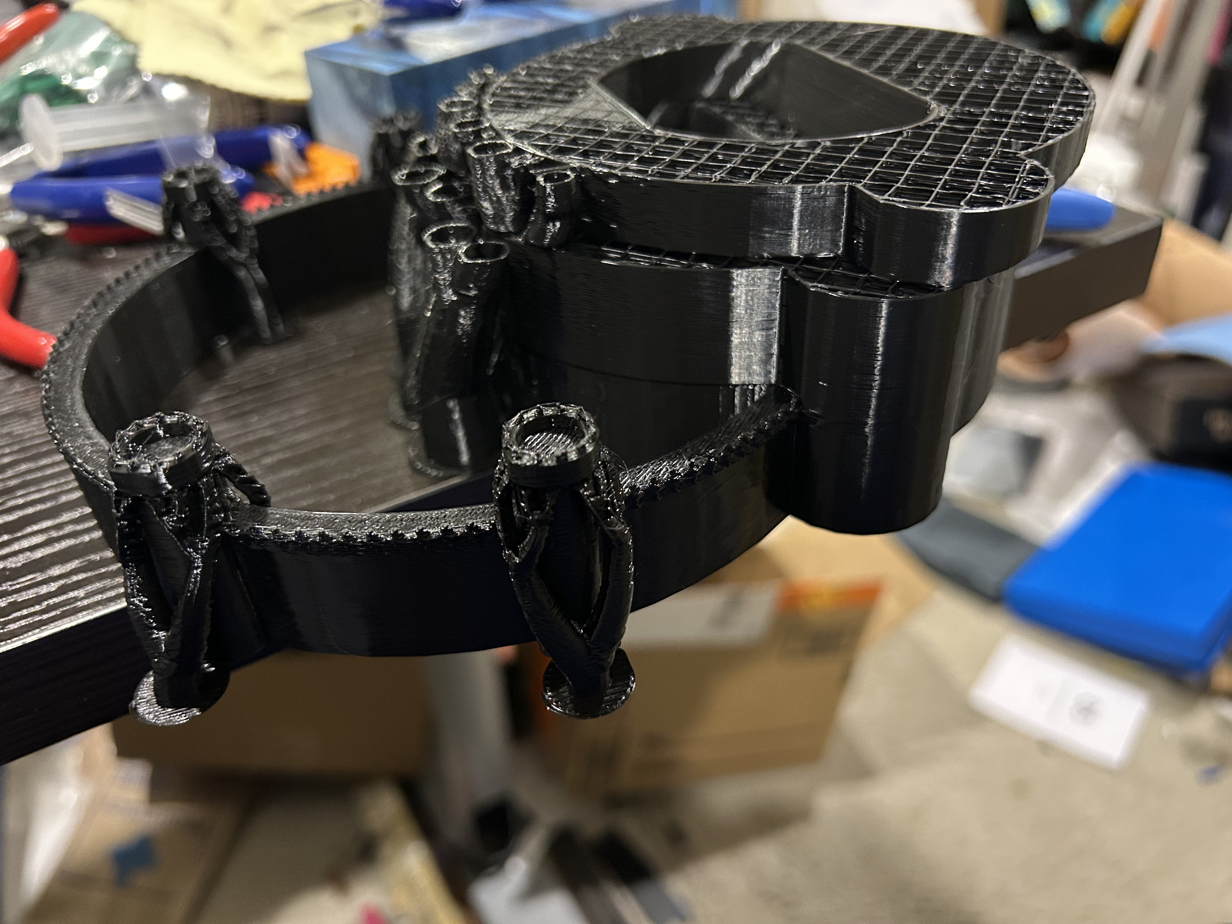

Everyone,
This is my second time attempting to print this model, and I seem to be getting a layer shift on my Y-axis when I hit about Z-1.75" -- it shifts about 1/4" towards the back of the printer. Can someone suggest where I can start trying to resolve this?
Also, my X axis seems to rattle quite a bit when printing. This only started happening when I upgraded from MK3S->MK4
Thank you!

Probably caused by https://github.com/prusa3d/Prusa-Firmware-Buddy/issues/4254https://github.com/prusa3d/Prusa-Firmware-Buddy/issues/4465
No fix at this point.

RE: Consistent layer shift?
I switched to a different infill (gyroid) and it seems to be printing cleanly.
