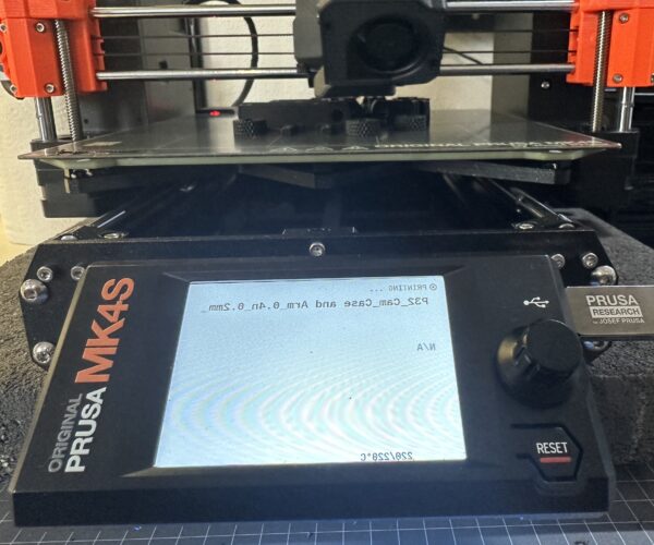

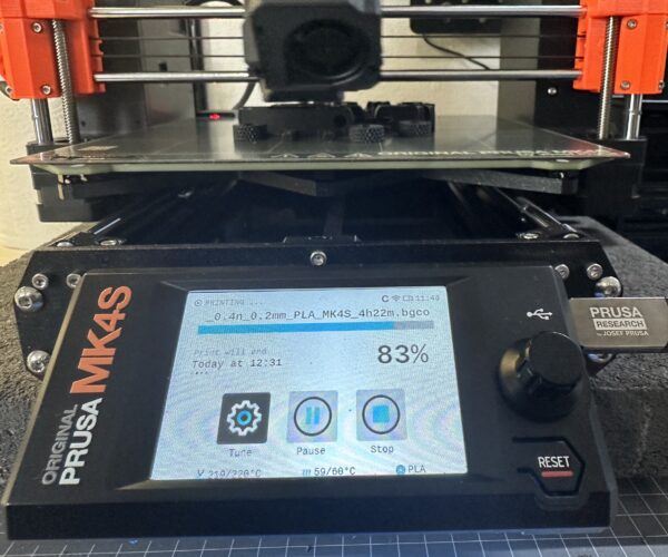

Screen just stays black and randomly flickers after connecting with prusa connect during a print. Couldn't find anything on this for the mk4s, is it the same as the issue with the mk4?

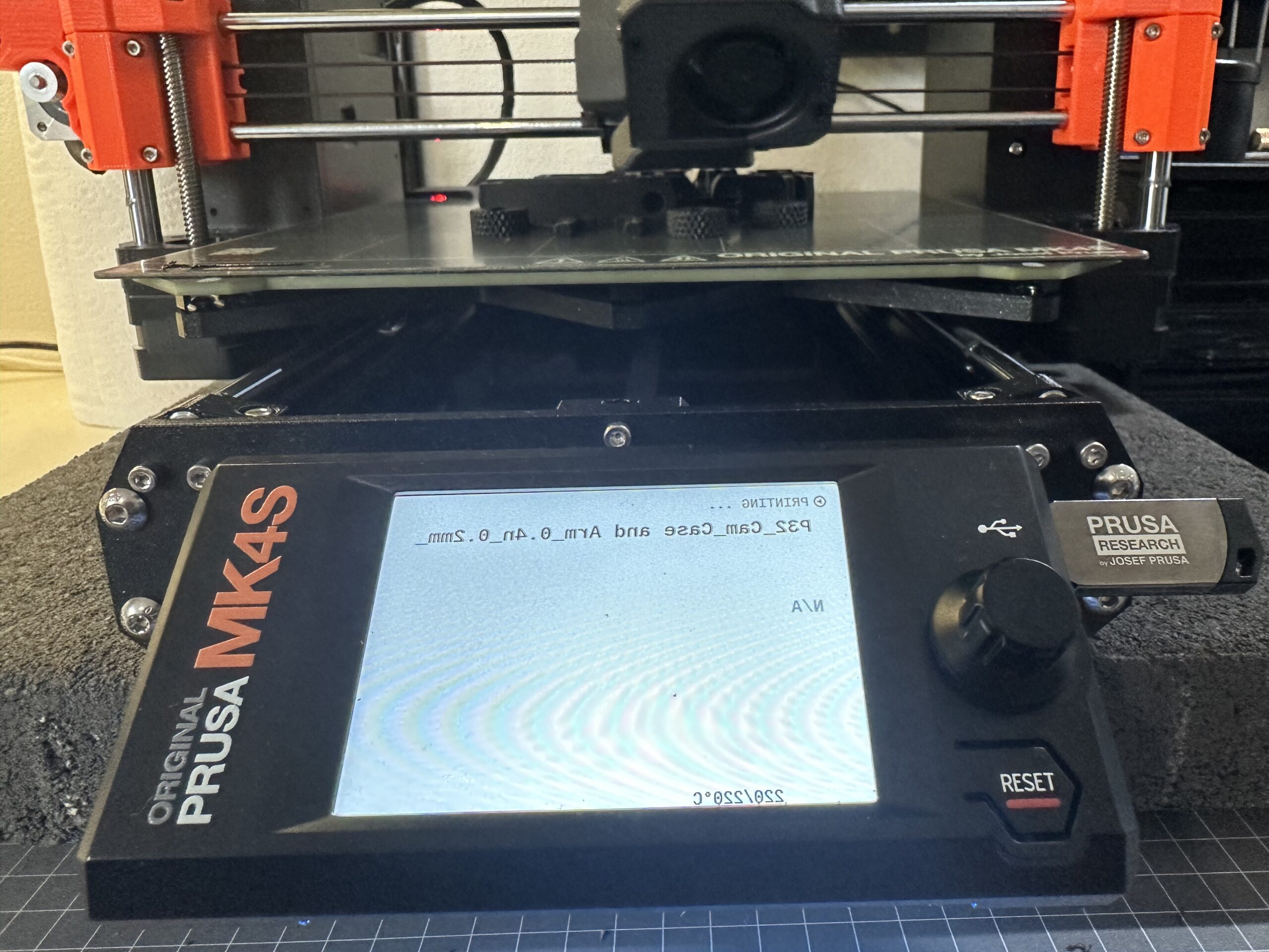

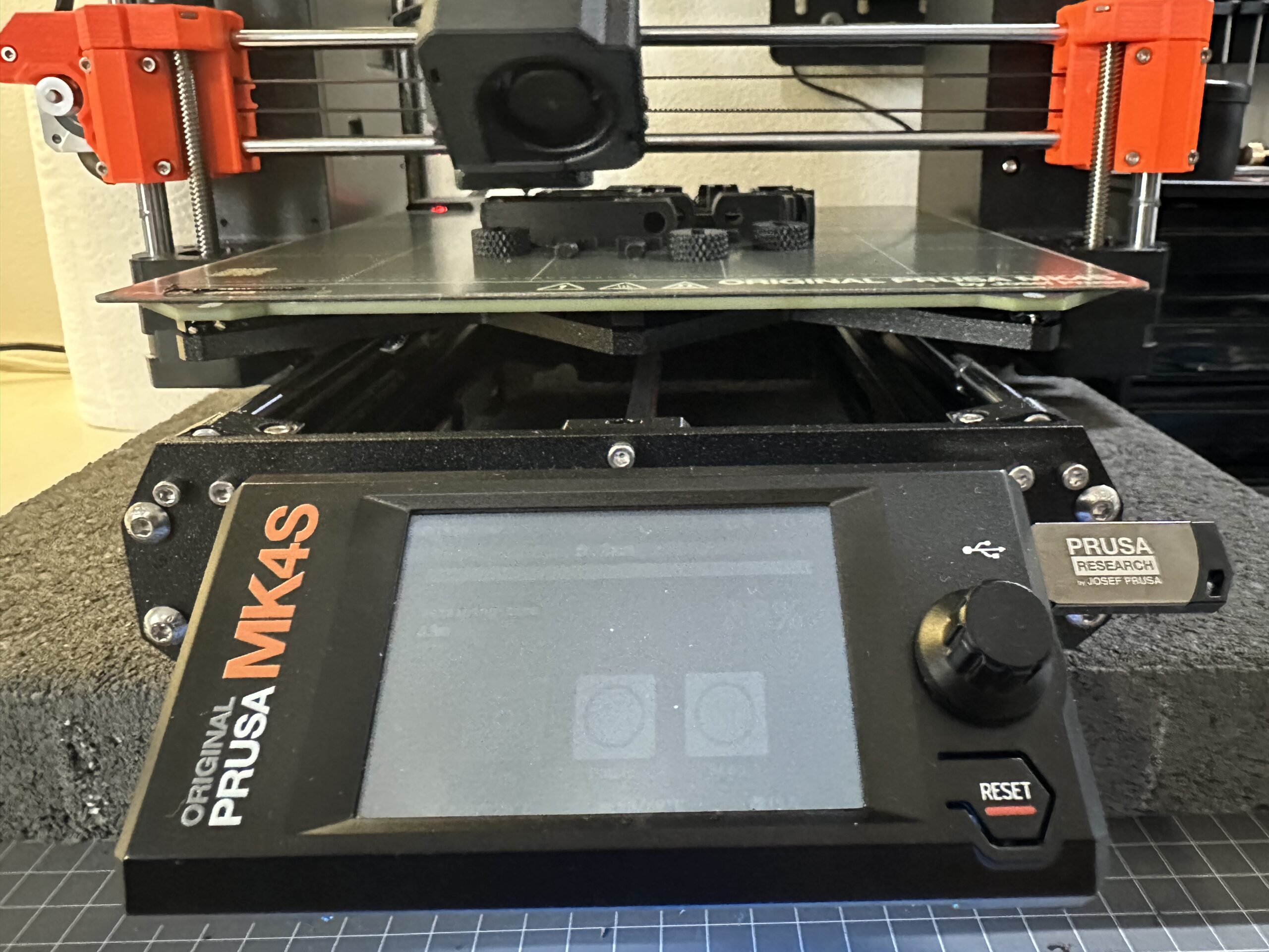

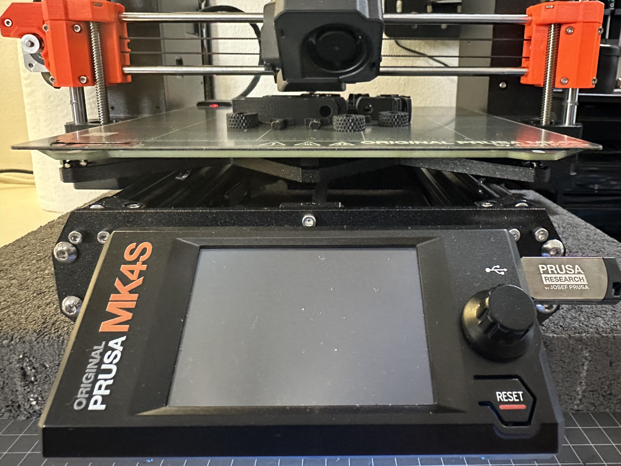

Same issue - I just get the attached. After several restarts it works normally again.....

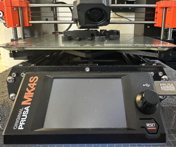

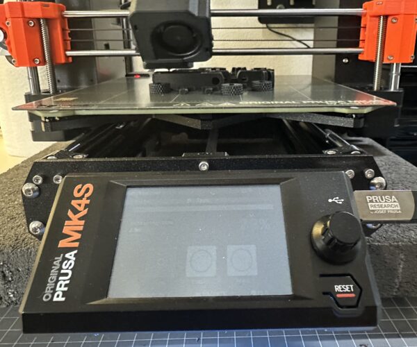

I built the printer from a kit roughly 5 days ago I think and it was great until today when I checked on a print via the prusa app on my phone. Came outside to remove the parts and found this. I was able to start a new print via connect.
I notice that when it reboots the boot screen is fine so I suspect the screen itself is fine and this is some sort of bug in the firmware (i really hope thats the case at least since i don't know if i have it in me to rebuild the printer right now after having just finished.)
Will let you all know if it resolves itself on its own.

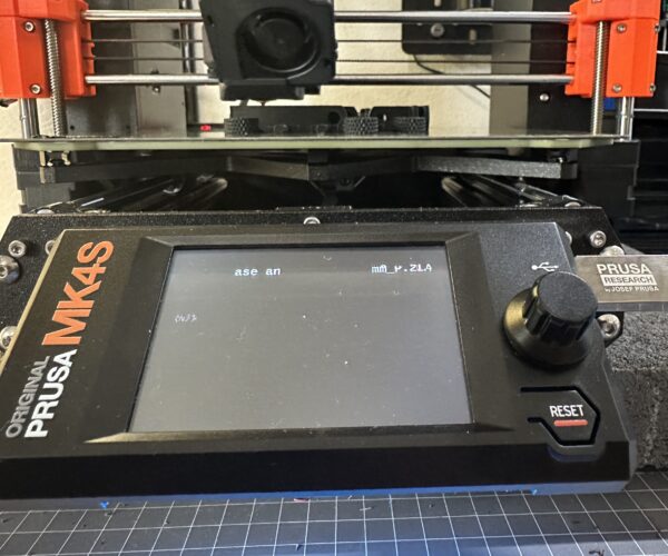

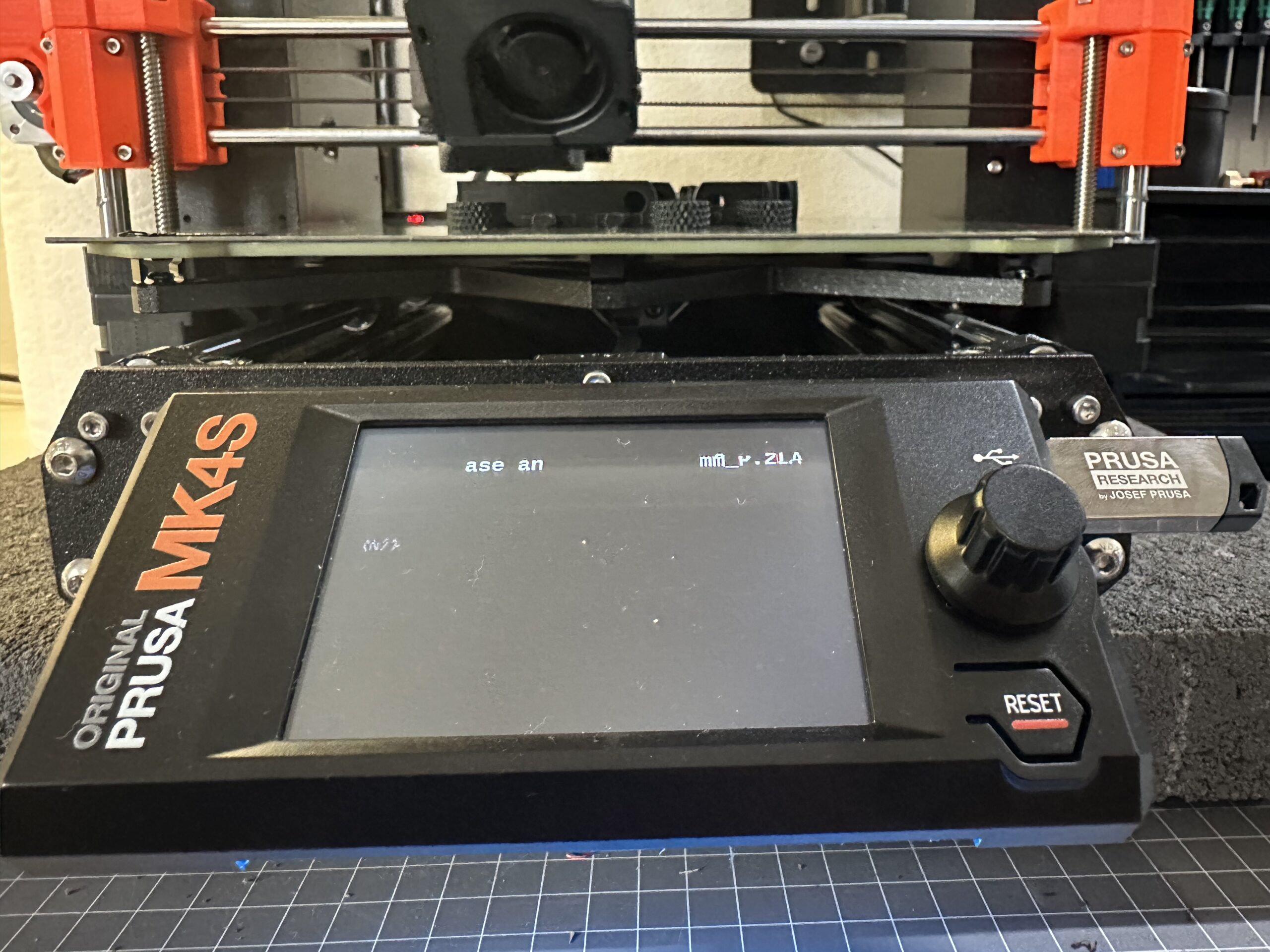

I have the same issue as you guys. It always happen when I start a print. The screen starts to flicker like crazy and then starts showing inverted images, squeezed image, noisy image and other artifacts. Simply pushing the "RESET"  button on the display panel instantly turns it back to normal and I can start a print no problem, so I recon it's not a faulty display, nor a loose connection.
Looking forward to the next firmware update which, hopefully, fixes this. Love the printer otherwise! 🙂

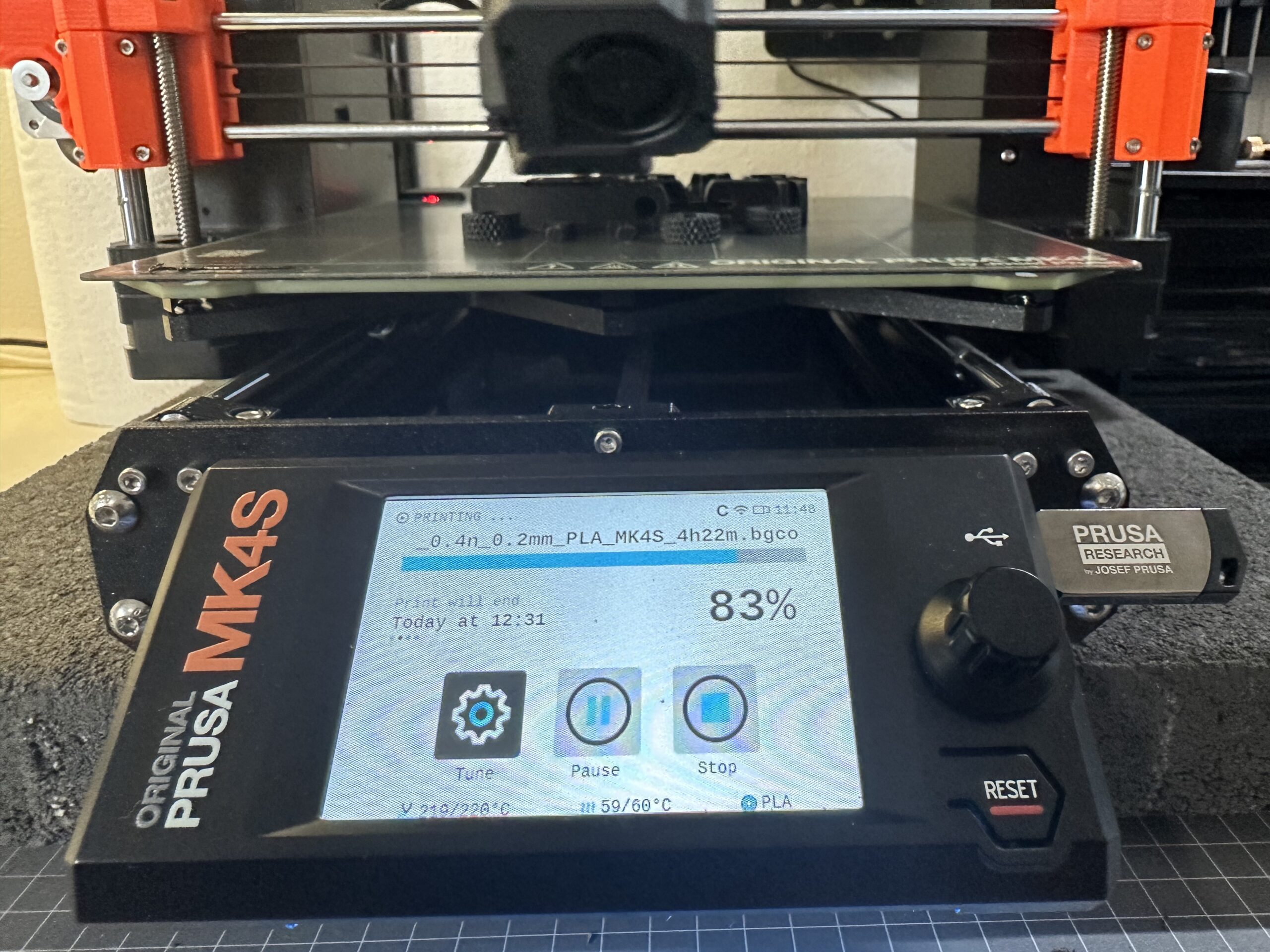

Hey there! Just had this issue as well, re-flashed the firmware and didn't do anything. I did however do something that made the issue go away. I believe it was in the Settings > Hardware > Screen Refresh Rate, changed it from High to Low. Didn't flicker anymore after that, might be useful to someone!

I've had the same problem twice. The first time was 3 days after I had assembled the printer (kit), about 3 months ago. The second time was just today. This time I  had shut the printer down due to a trip, and today I attempted to fire it up and print a model, only to see the bootloader and then a blank screen. Like the troubleshooting had gone the previous time, I disassembled the screen panel and attempted to re-sit the cables. It did not work and I contacted the support a second time. The waiting time was about 24 minutes, so in the meantime I attempted to shut the printer down from the PSU switch, and from the reset button more than 20 times. I even downloaded and installed the latest firmware (6.2.3 - March 25, 2025) but it did not solve the issue. As soon as the chat session started, the screen menu came up and I was able to navigate to a couple menus, but soon it would turn black again. Eventually, the support advised me I turn the Display Refresh Rate to Low (from the Hardware Settings) which I did, and after that the display has remained on and functional
