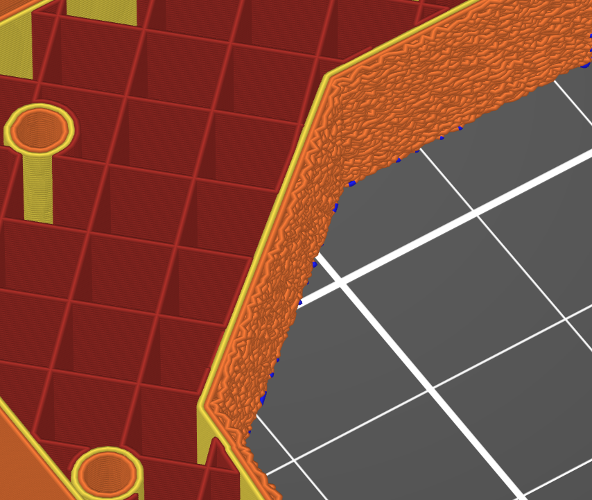

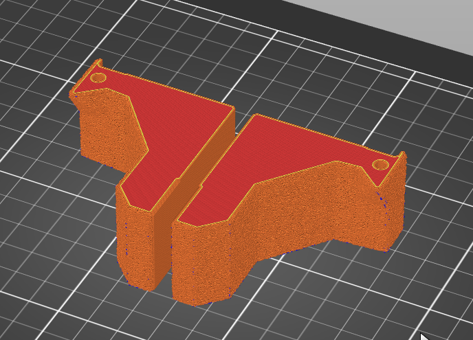

Few weeks ago I print some part and today I print it again. Same STL, just resliced for MK4S profile and the result is completely different from front. It was printed on its side like this:
on this photo you can see the MK4S print (closer) vs. MK4 print (futher) the part what was printed on its side is completely different. From MK4 it was something like smooth and from MK4S the surface is really rough. Bottom, back, top looks almost the same, but this area that was printed on its side is really different. Why is that?
EDIT // Now I can see even in the screenshot from Prusa Slicer that the area printed on side it looks really rough also even in that screenshot.

Look up the slicer option called fuzzy skin. I bet you had it accidentally enabled.
