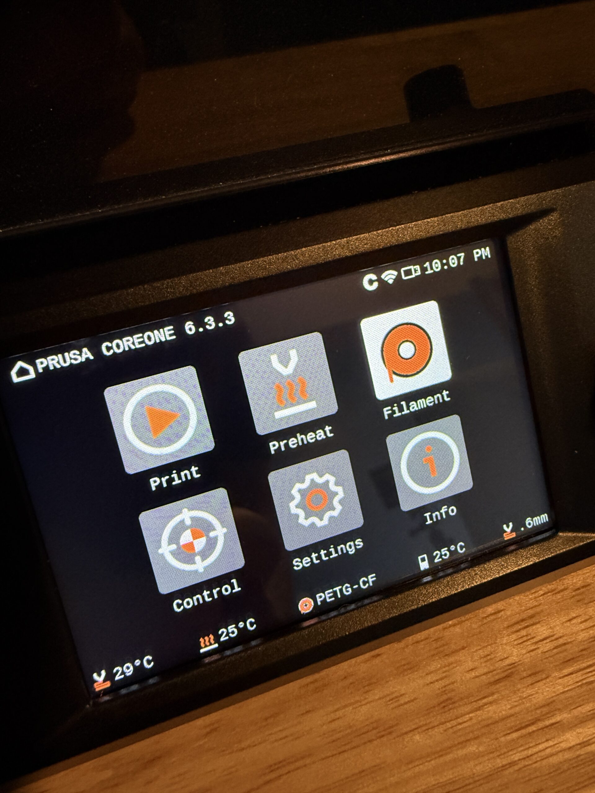

I'm having this same issue. I'm trying to print Prusament PETG-CF. There was no profile for this on the printer, so I created "Custom" and set the temps appropriately (interesting that the Material Guide states the bed temp should be 90deg, but the PrusaSlicer Filament profile says 85deg). I have Prusament PETG-CF chosen in the filament profile. Then clicking "Send to Connect" I get the "Material does not match" message. The screen on the Core One shows that the PETG-CF is loaded as well

As a follow-up, I went into the Filament settings in PrusaSlicer, and simply typed in the exact name I had set up on the Core One under Filament Type, and it made the "Material does not match" go away, but I have no idea if the print will come out correctly. Here goes nothing!
