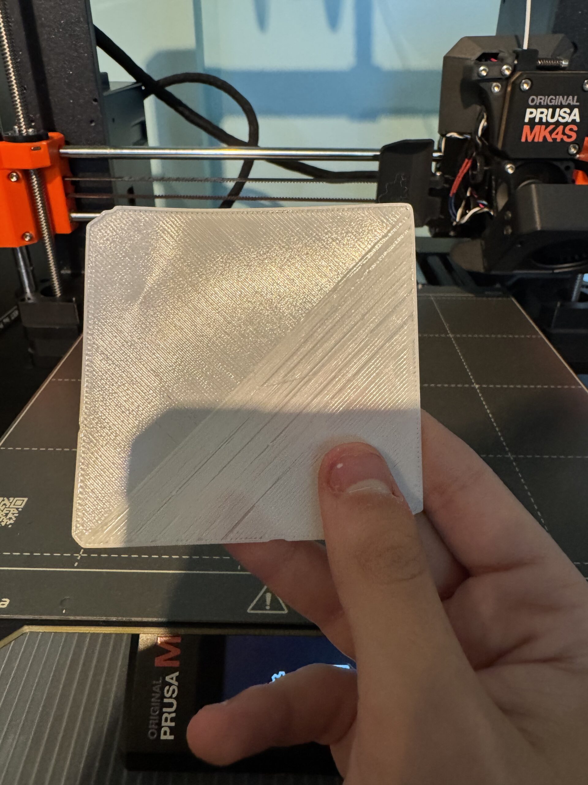

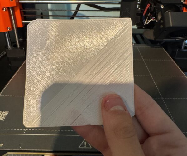

new nozzle causes missing material and clicking sound?
I recently replaced the nozzle on my MK4S after the one that came with it was irreparably clogged. After installing it and going through all the calibration procedures, the first layer printer fine, but the second speedy layer printed out with missing material, and the nextruder kept making this weird clicking/banging sound every time it failed to extrude. Is this due to the fact that the new nozzle isn't CHT, is it the extruder itself, or have I installed it wrong?

Are you slicing with a HF profile? Non HF nozzles can't melt the plastic fast enough for the HF profiles.
