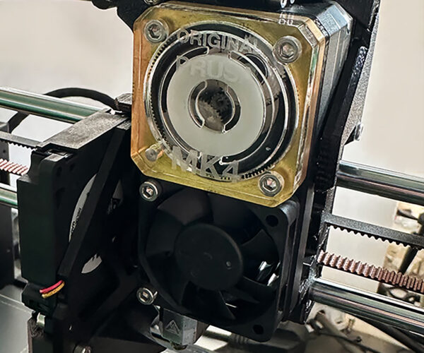

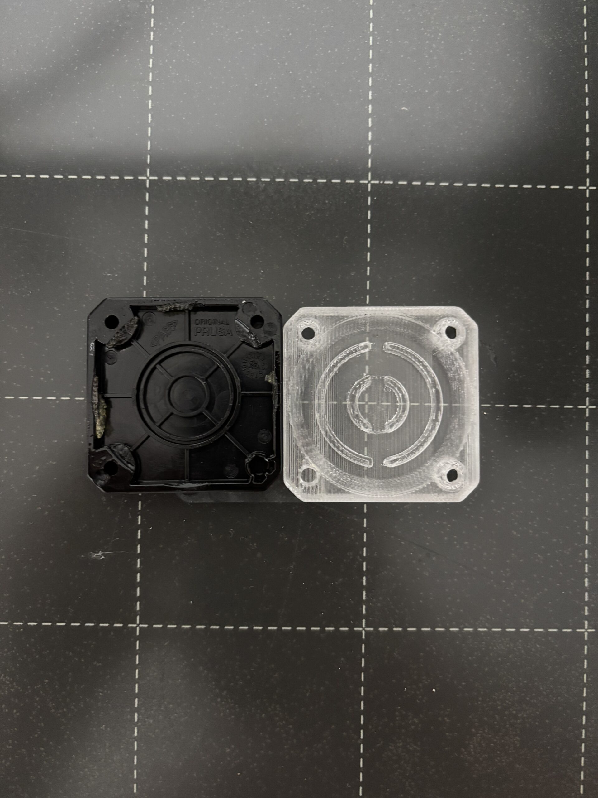

Can I change my nextruder cover from my MK 4S to the cover from the MK4 because I don’t have the ring that you can see in the first picture. The second picture shows in black, the original cover and in clear the printed cover. I got the print file from Prusa for the MK4s.

There's no pictures.  But you need the ring that's inside the cap. It's a spacer/ thrust bearing.  It's made from a very slippery plastic.

The. MK4s PG-case or cover on my upgrade had no place to install the ring.  The upgrade instructions don’t mention needing the ring.  I. Used the new cover with no ring and have not had any problems.   I checked the old cover and it appears the ring never made contact with the gears.  The new cover has a small relief for the gears from what I remember.  That may be all it needs.
I have also upgraded for the MMU3 and the Oring that was added to the main-plate tends to hold the gears from moving front to back.
I see no problem with the old cover except it wont say MK4S.

The STL files for the Nextruder clearly have a space for the ring.  I stand by that a 3d printed cover needs the ring.

I think the injection molded cover you get with the upgrade kit doesn't need it, but a 3d printed version does.

I ran into this too. The injection molded part got wirn away, so the large gear moves sideways out of the path of the filament.
I thought "no problem, Prusa is all about being able to print parts and build it yourself.", but after I printed the STL for the pg-cover (as provided by Prusa), It became clear that the ring is necessary. I couldn't find it as a spare part for purchase, and there's no instructions on how to proceed if one started with the injection molded cover and no ring.
What's the next step? Thanks.
