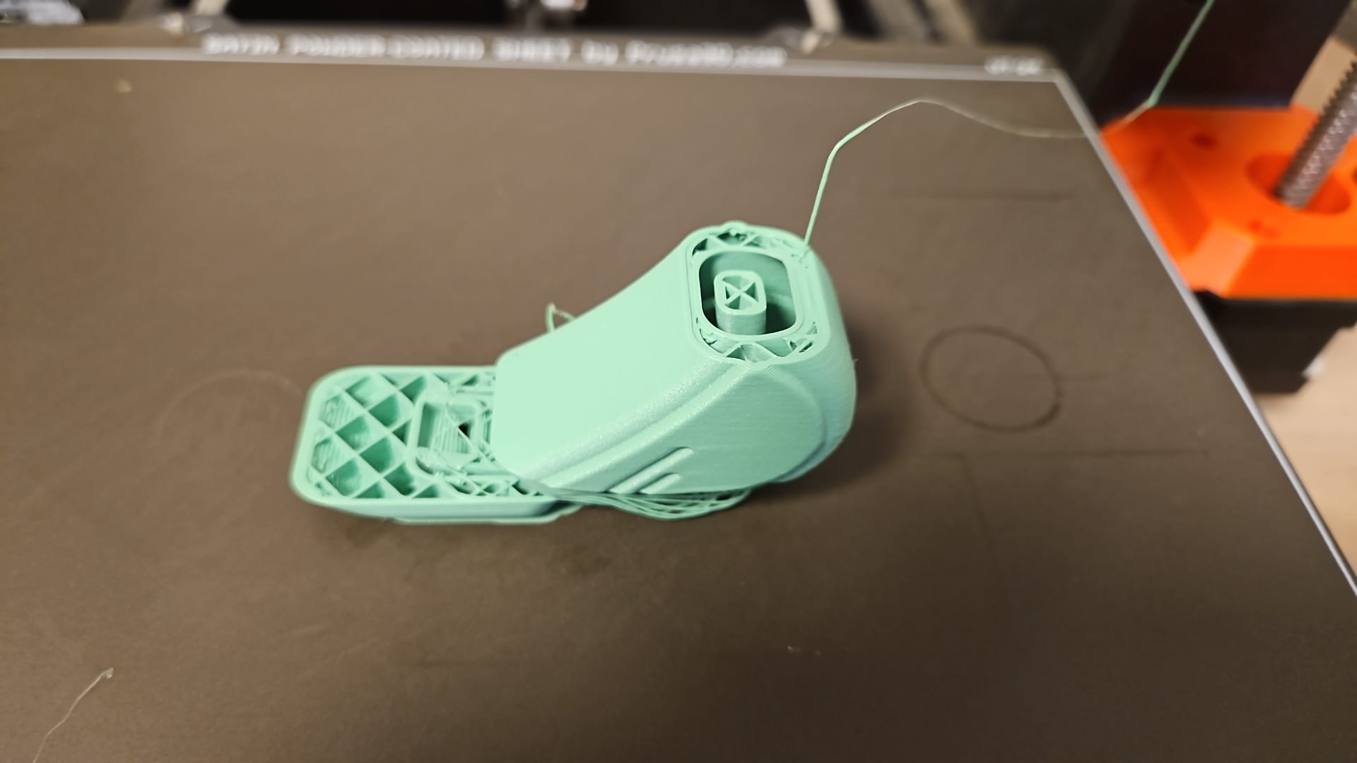

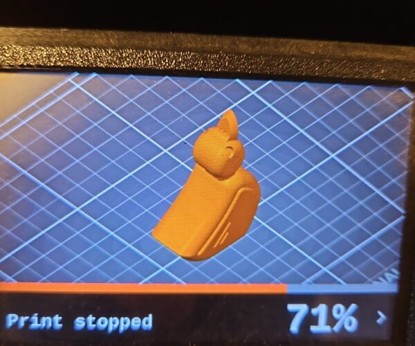

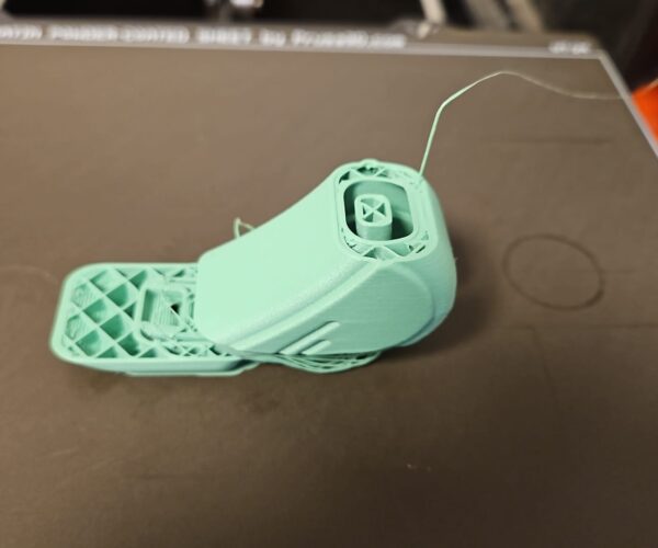

While printing this known duck, the head started printing as it should, then it shifted right ~30mm, continue as if normal.
I just switched to P
rusa slicer 2.9.3
I just switched to Prusa slicer 2.9.3
What could cause this?
previous print (smaller version of this duck) went well.

The steep overhang at the front is likely to warp upwards, combine that with the probable poor adhesion to the dirty print-sheet and the chance of a head crash is high.

I don't think so. the base of the print is exactly where it should be, while the remaining (higher layers) shifted to the right, and kept being shifted.

The base stays where it is — the overhang warps upwards and perhaps partially detaches — the print head crashes into the top of the warp and fails to complete its move — the print head continues as if it had completed the previous move but now it's out of position.
