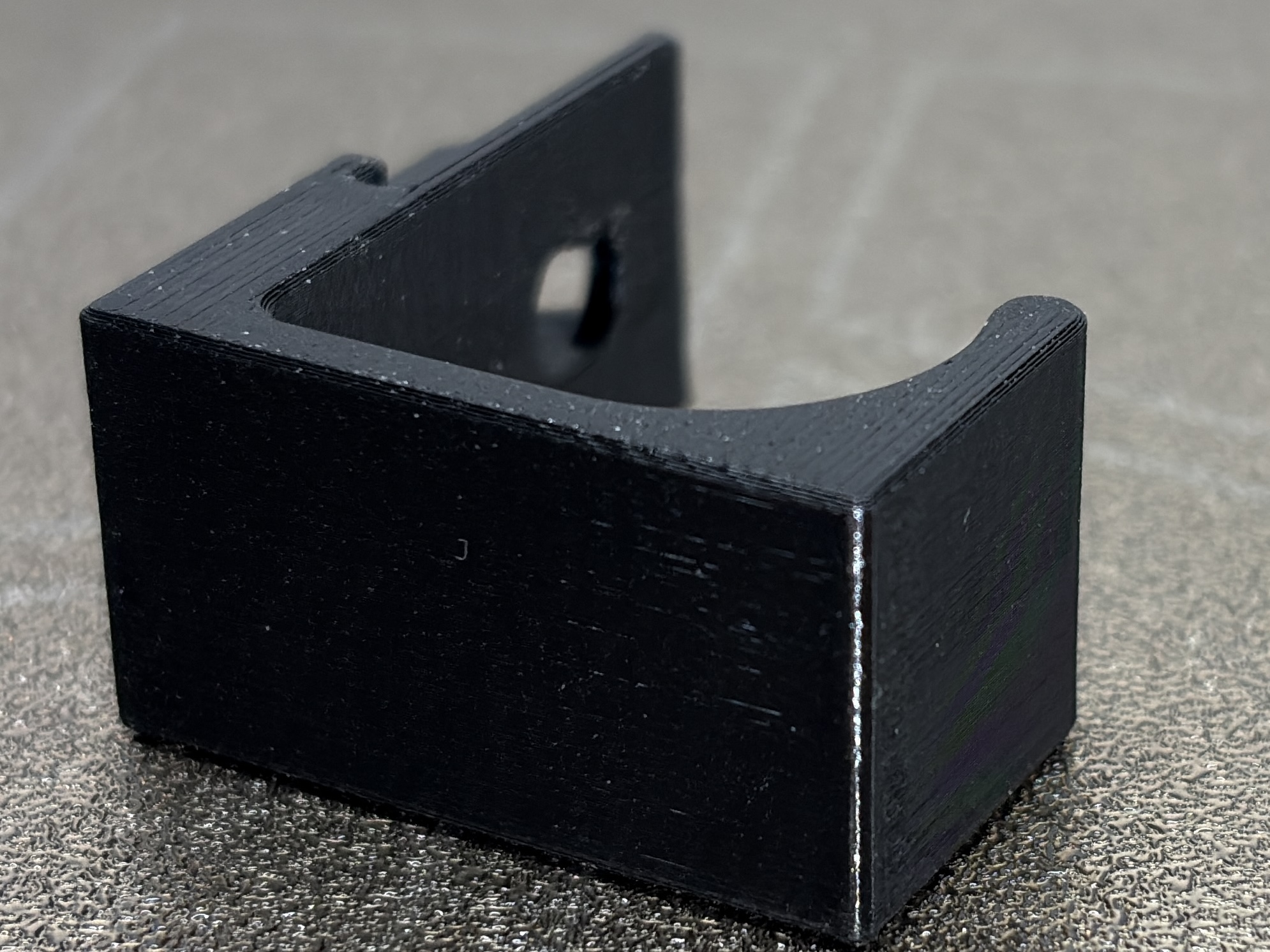

I dried my spool of Prusament Jeg Black PETG for a bit more than 11 hours and the weight including the spool dropped from 362 g to 360 g, so I think I can say it is dry.
I printed the PETG in the enclosure with the doors closed.
I had to increase the brim size to 5 mm; at 3 mm the part got knocked over during printing.
I printed the part stub to test the 2 problem areas and it isn't too bad, but it can be better. I would like to know what recommendations there are to improve the quality in the sloping edges. I applied most of the settings I used for PLA, but left the cooling fan speeds per the default since the PETG needs less cooling.
Also, a grooved seam has appeared on the print that is not where the seam appears in Prusa Slicer. When I print PLA, the seam appears as a long bulge, but in this PETG print, it is a groove. I would like to understand why the seam isn't where Slicer showed it to be, and why it is such a large groove.
Here is the project file for reference.
license plate bracket handle - V5 (revised production design) prusament PETG slowed 25 pct
The long edge at the right of this picture a 45-degree overhang at the left rear of the print. The vertical edge is what rested on the print bed; part of the brim is still visible. The left rear edge is bowed inwards until it was nearly half way up the edge. For the PLA print, this aberration was fixed by increasing cooling and slowing the print. I have already slowed this print to 75% of the default. Do I need more cooling?
This surface is facing the front of the print bed. The ugly seam visible in this picture is not where the seam is in the slicer. The seam is supposed to be at the edge to the left of the seam. You can see that the edge at the lower left was the edge resting on the bed; the remnants of the brim are still visible.

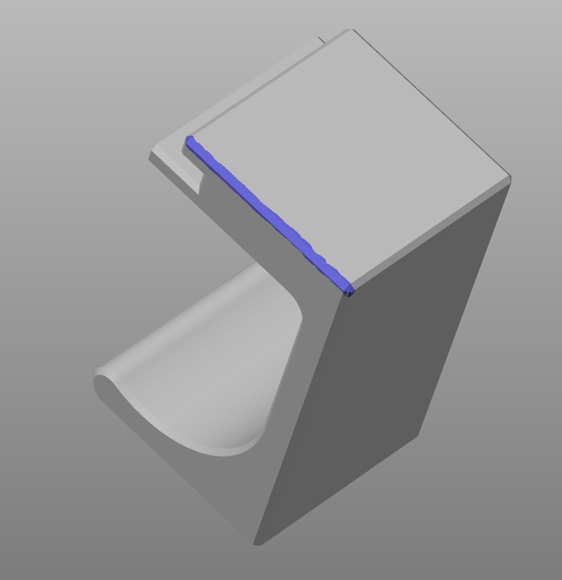

Here is an image of the painted seam in Prusa Slicer.
Here is an image of the seam placement after slicing.
I changed the Perimeter Generation setting to Classic, but the seam is still in the wrong place.
Why on earth would the seam not be placed where defined in Prusa Slicer?

I used the thinnest control available to paint that edge and it is on the chamfer, not on the larger flat surface. When sliced, the seam is on the corner of the chamfer at the adjacent narrow face, not on the larger flat face.
The seam setting is "Aligned".
When printed in PLA, the seam is on the large face, but right at the corner where it is painted (just not exactly where shown in the sliced rendition). I looked at the PLA print more closely (required a magnifying glass) and the seam is also split like the PETG print, but I can't see the short part of the seam; perhaps it is on the inside of the groove.
In this picture, you can see the sliced seam is on the chamfer edge closest to the narrow face. The red lines mark where the seam is printed; note that the seam is split into 2 separate seams, neither of which are where indicated in Prusa Slicer. Where the 2 seams split is coincident to the bottom layer of the groove behind the large face. The tool path in Slicer also shows the seam at the white line, not the red line. The gcode is clearly not in agreement with the rendition.

Moving on, I still have the issue of narrowing near the print bed on the left rear edge. It looks just like the issue I had with PLA that was cured by increasing cooling.
Here is the project file.
license plate bracket handle - V5 (revised production design) prusament PETG slowed 37 pct
I have improved it with some setting changes, but it isn't perfect yet. I would like some ideas to fix this problem edge. The bit sticking out at the left is the brim.

Thank you for your reply. I wanted the seam on to be "hidden" on an edge and not appearing on a face. Where the seam ended up is functionally OK as it is hidden when installed. Reducing the seam gap has greatly reduced the seam effect.
What is even more interesting is that the stub part at the left on the plate has a painted seam, but the full part has no painted seam because the rendered seam appeared where I wanted it, yet both parts printed the seam in the same place on a face, not on the edge shown in the sliced rendition.
Looking at the definitions of the Aligned and Nearest, they both want to look for a non-overhang to place a seam. However, painting a seam is supposed to override the Seam Position setting for that given seam. Where I painted the seam is an overhang, but the painted seam should be where the seam is printed. I chose that edge since the rear-facing overhang edges have cooling issues.
Therefore, the feature to print the seam where it is painted is not working as advertised. The seam printed is nowhere near the enforcer area and nowhere near where Slicer shows the seam in its sliced rendition.
"When the Aligned option is active and enforcers are used, the seam is placed in the middle of the enforcer area."
Prusa Instructions on Seam Painting
I will take this up with Prusa as a bug.

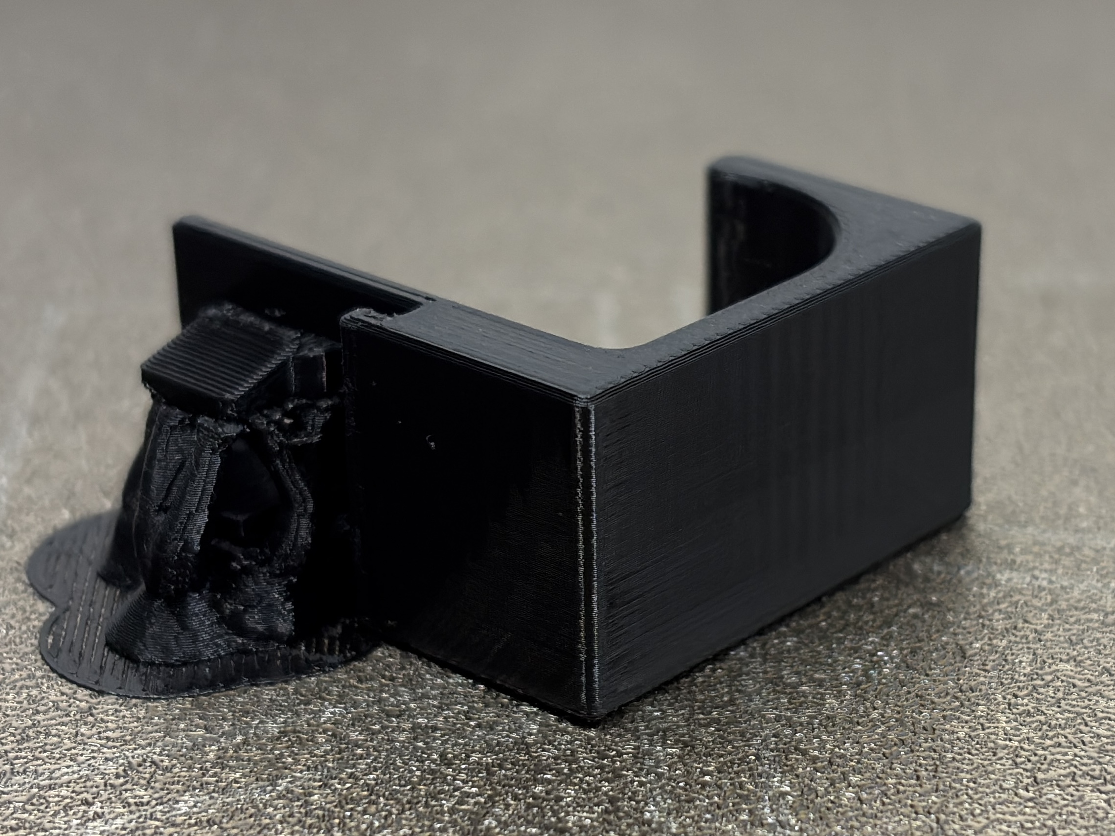

I use filament from Material4Print. PETG is easy to print and does not require cooling when printing without supports.
Unfortunately, I forgot to adjust the cooling on my first attempt. The inclined print did not work out on the first try.
Until then, I will print it lying down.

Here the first test:
Postato : 14/01/2026 6:23 pm
t5montecarlo
(@t5montecarlo)
RE: Poor Print Quality on Sloped Surfaces That Face the Rear
You have confirmed that on it's side, the supports ruin the sloped surface of one of the tabs. The rest of the print came out well for me as well as you.

Yes, that's right, one of the tabs is damaged by the support.
I'll print it tomorrow as it was stored in the file.

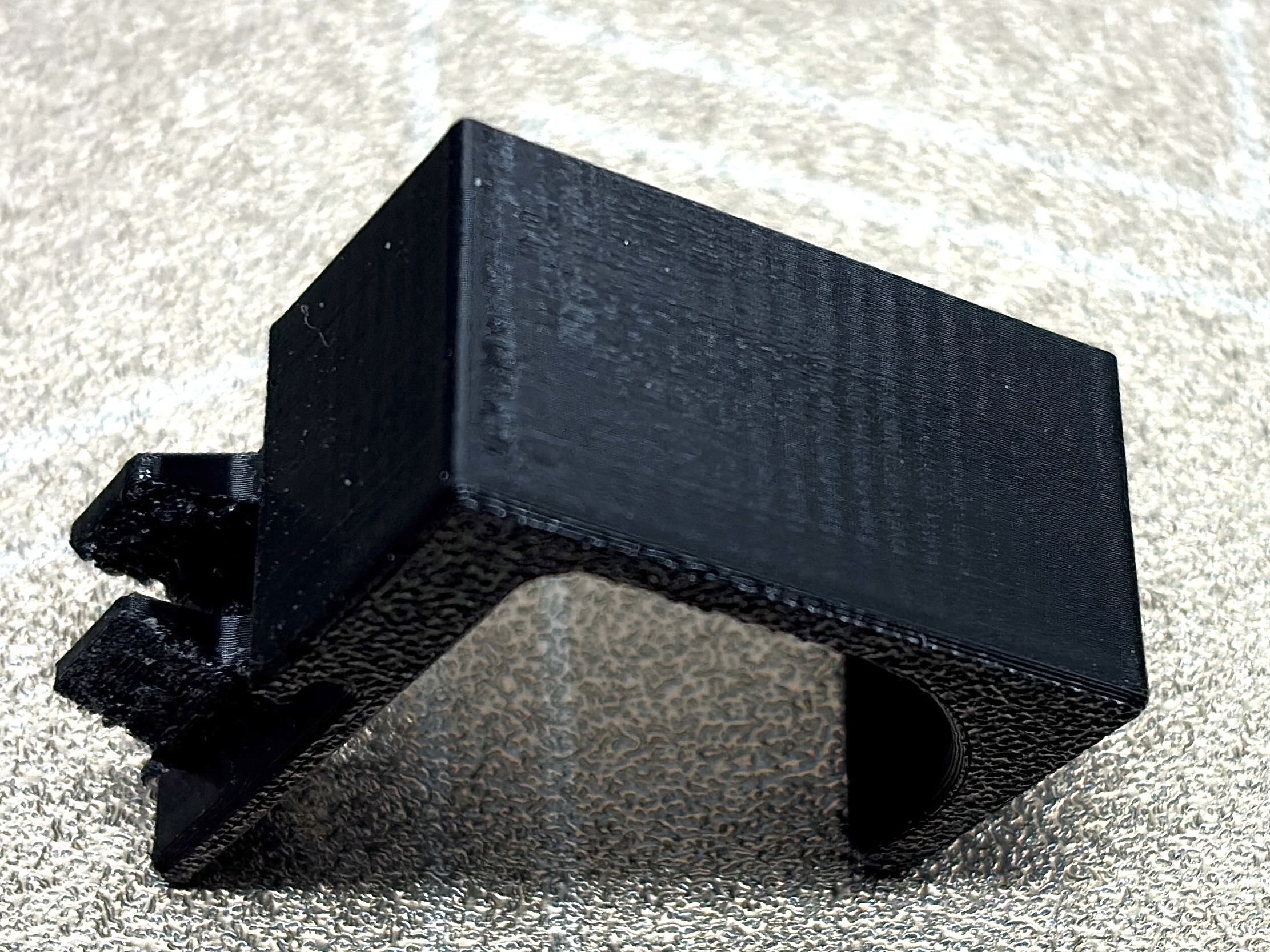

Here is my current print file:
I will also upload the project file (3MF) once I have examined the component. Then you can compare the settings and adjust them if necessary.
I will add detailed images of the edge where the seam is.
Postato : 15/01/2026 5:36 am
jan.d.slay
(@jan-d-slay)
Here are the pictures I promised. They're not quite perfect, but the “problem areas” are better.
I need to upload the 3MF file from the other PC. I'll do that later.
The supports were very easy to remove and there is no visible damage to the clips.

Thank you. You only had to print the model stub, not the full model, but I greatly appreciate your help.
You have proven that that the Prusa XL can print the model. One difference between the XL and MK4S is that the XL cooling fan duct is rotated 180 degrees from the MK4S duct. The edge in your print that is opposite my problematic edge looks OK.
I have already slowed down the printing process by 37.5% and the problem still exists. Your print speed is much faster, so I assume it is per the profile default. At times, I wish I had bought the Core One kit instead of the MK4S kit.
I am still open to setting change ideas to make the model or model stub print properly on the MK4S. The problem was solved on my MK3S with an improved cooling fan duct. Modifying cooling and speed made the model print in PLA on my MK4S. I still believe the PETG print needs additional cooling help; some setting changes have improved the problem area while other changes have made the problem worse. I still need to see how it prints outside the enclosure, which will help to point to a cooling issue. I may make time to try that today and report back.
