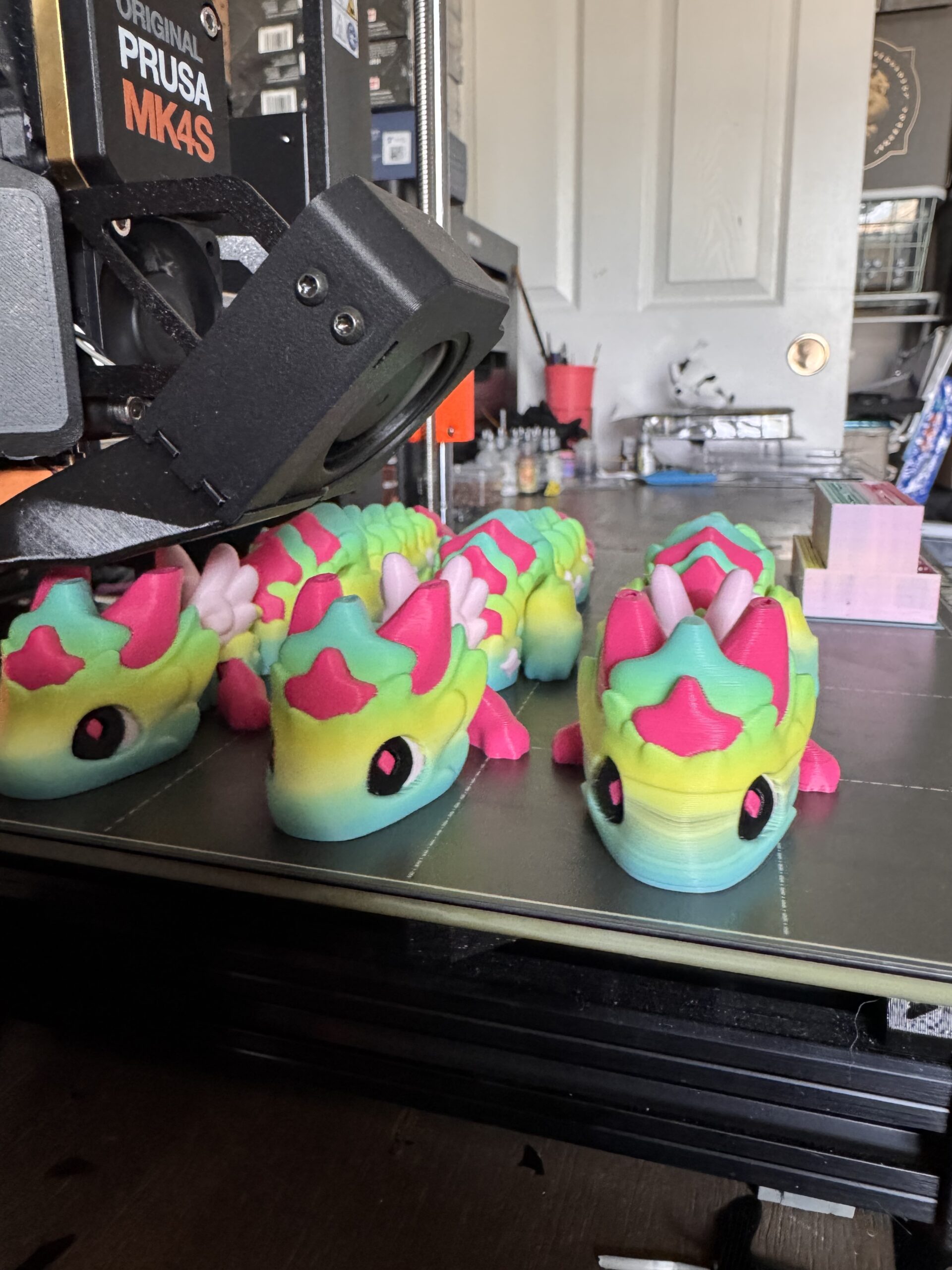

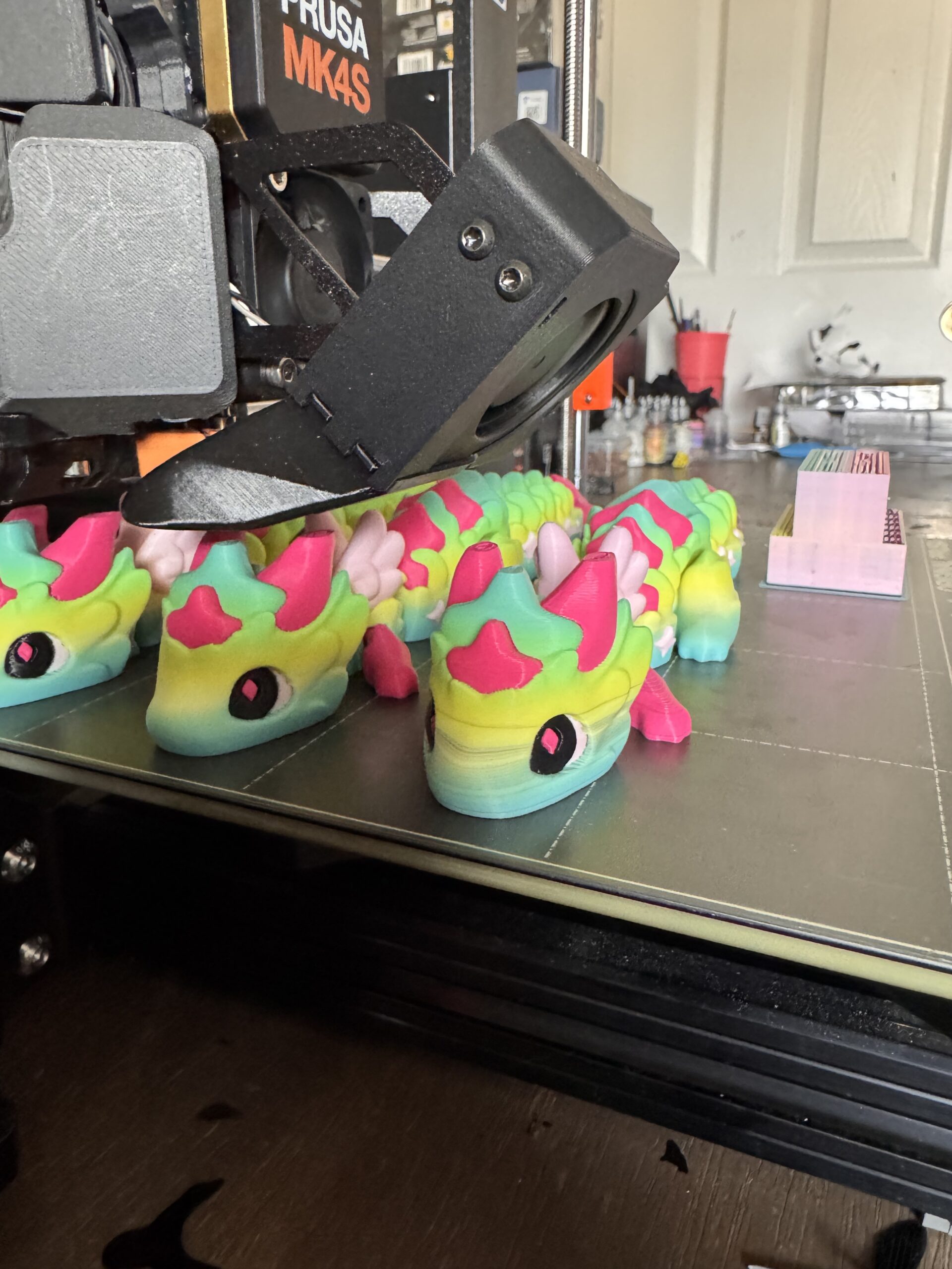

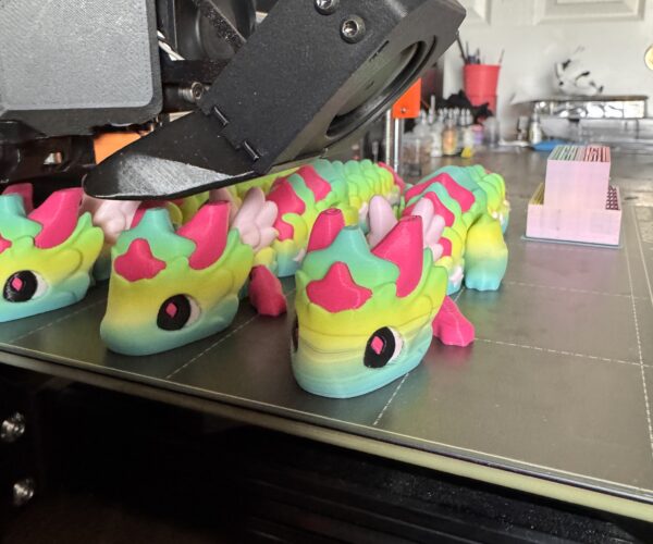

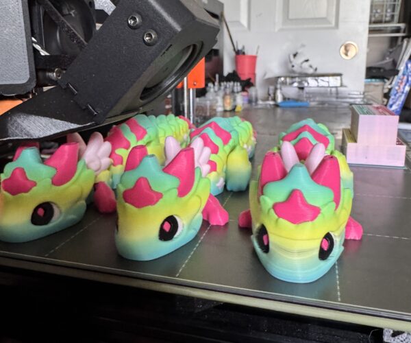

Hi good morning! My daughter has started 3d printing as a little side business through an art school she attends and we’re trying to work out some kinks. Firstly, blacks and pinks seems to keep bleeding in other colors, usually pink into whites and blacks into everything. What is this problem called and how can we solve it. It usually only happens to the print closest to the wipe tower. We’ve tried several different kinds of filaments, they are all new and clean and dry. All PLA, but I’ve noticed her files are set to PETG. Thanks for the help!

Purge Volume. That is what determines how much new filament is pushed out in order to flush out any remaining old filament. You can set it up to purge more when going from dark to light colors. Definitely, make sure to choose the right material, PLA or PETG, as this affects purge volume too. Also, make sure you’re not using a High Flow nozzle as they require MUCH larger purge volumes.

So, First thing I would do is to ensure the nozzle is a standard flow nozzle, not the High Flow Nozzle
the high flow is not good for Multi material working
then, in Prusa Slicer, select Purge Volumes, then select Use Custom project specific settings
and then increase the purge volumes as required.
NOTE! when you increase purge volumes, your waste tower gets bigger!, This may reduce the number of simultaneous prints....
you are able to change the width of the purge block, this maybe useful, if the larger purge block affects the number of objects on the build plate.
