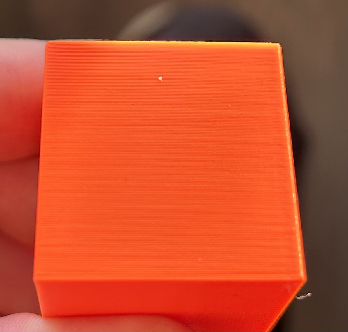

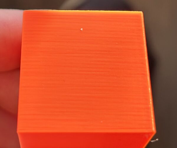

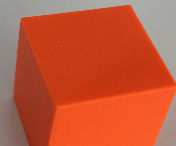

Hi. I’ve recently got my MK4S. From the begging on walls that being printed exists lines that occupies only part of the wall perimeter layer. It looks like brushed aluminium finish.

Check your belt tension and make sure the grub screws on the motot shafts are all secured properly

Grub screws are properly secured. Belts are also tightened correctly
