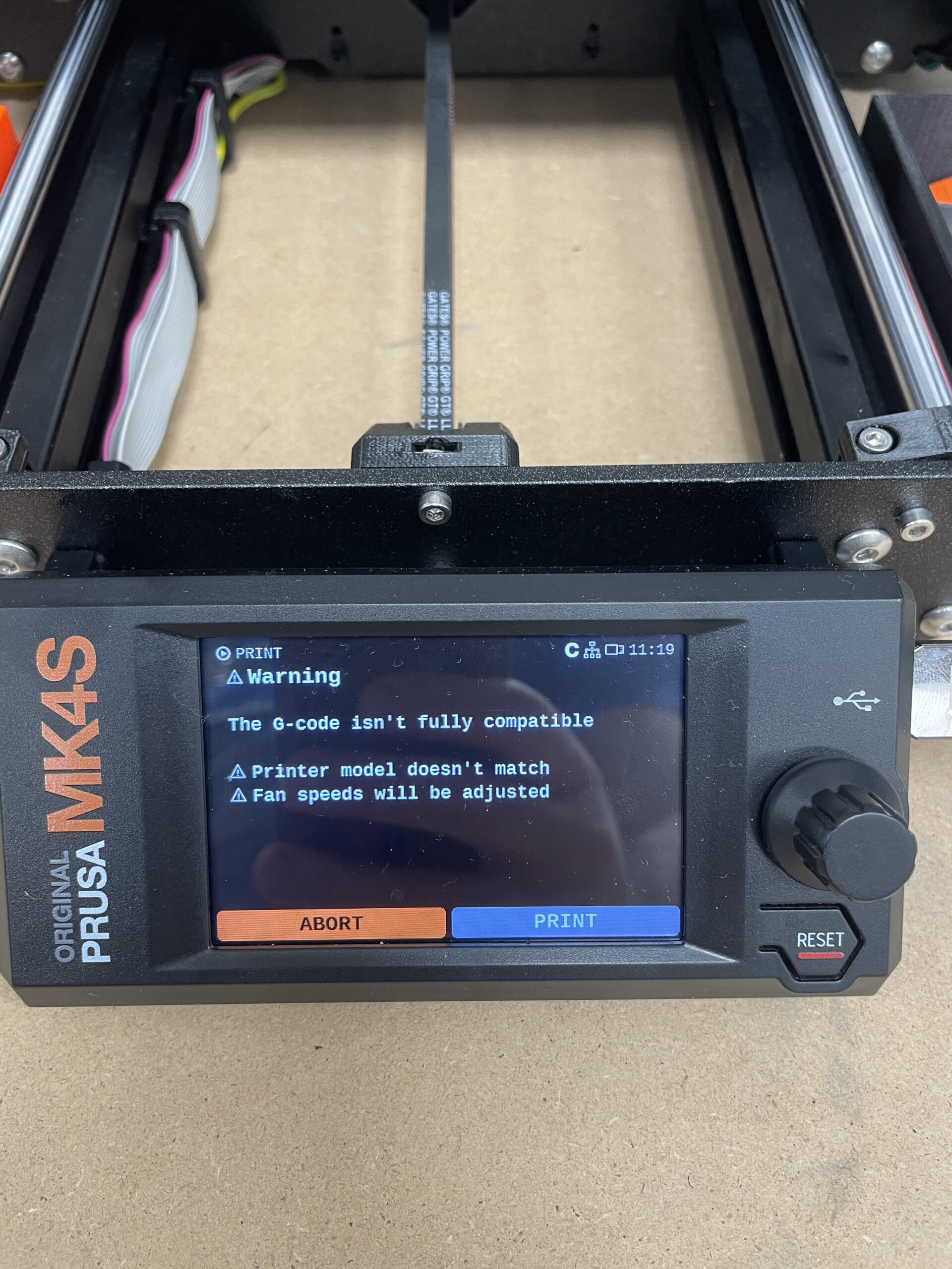

Printer model doesnt match (MK4S)
Silgan LJ
(@silgan-lj)
Posted : 13/03/2025 9:58 am
RE: Printer model doesnt match (MK4S)
You Have a Mk4S and you have selected a Mk4 profile
if you go to Prusa Slicer Configuration Wizard and choose the profile shown above, then the G code should match your printer.
THANKS! 🙂
