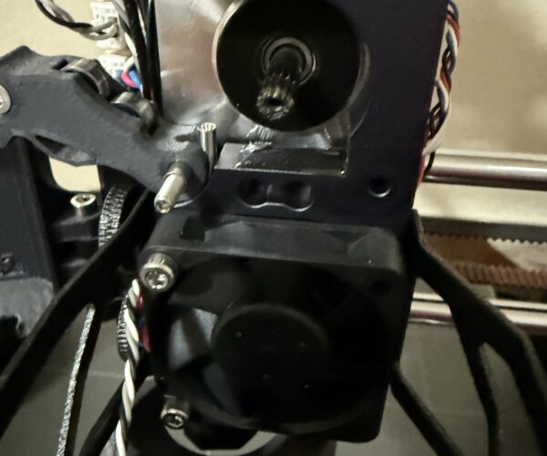

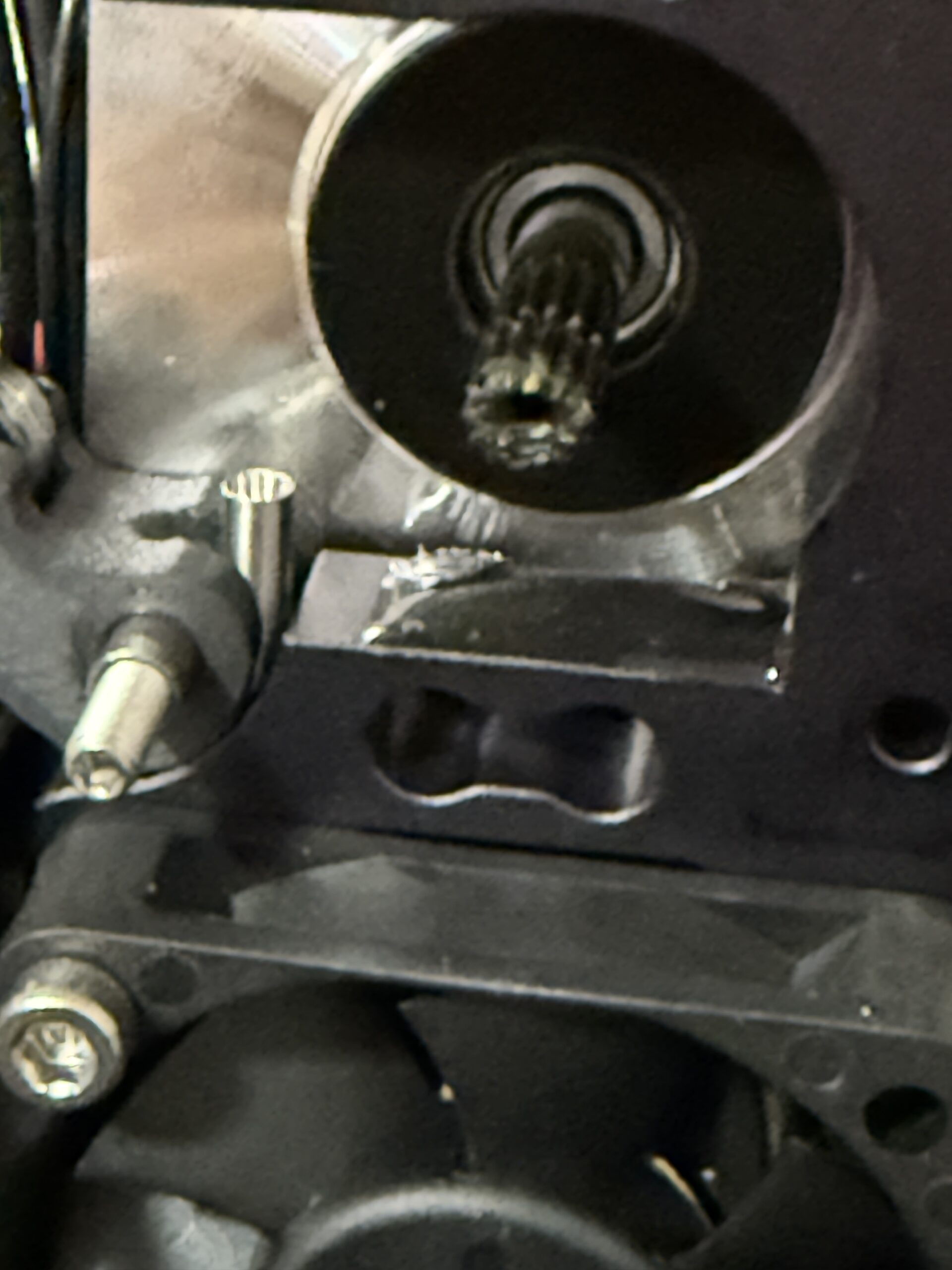

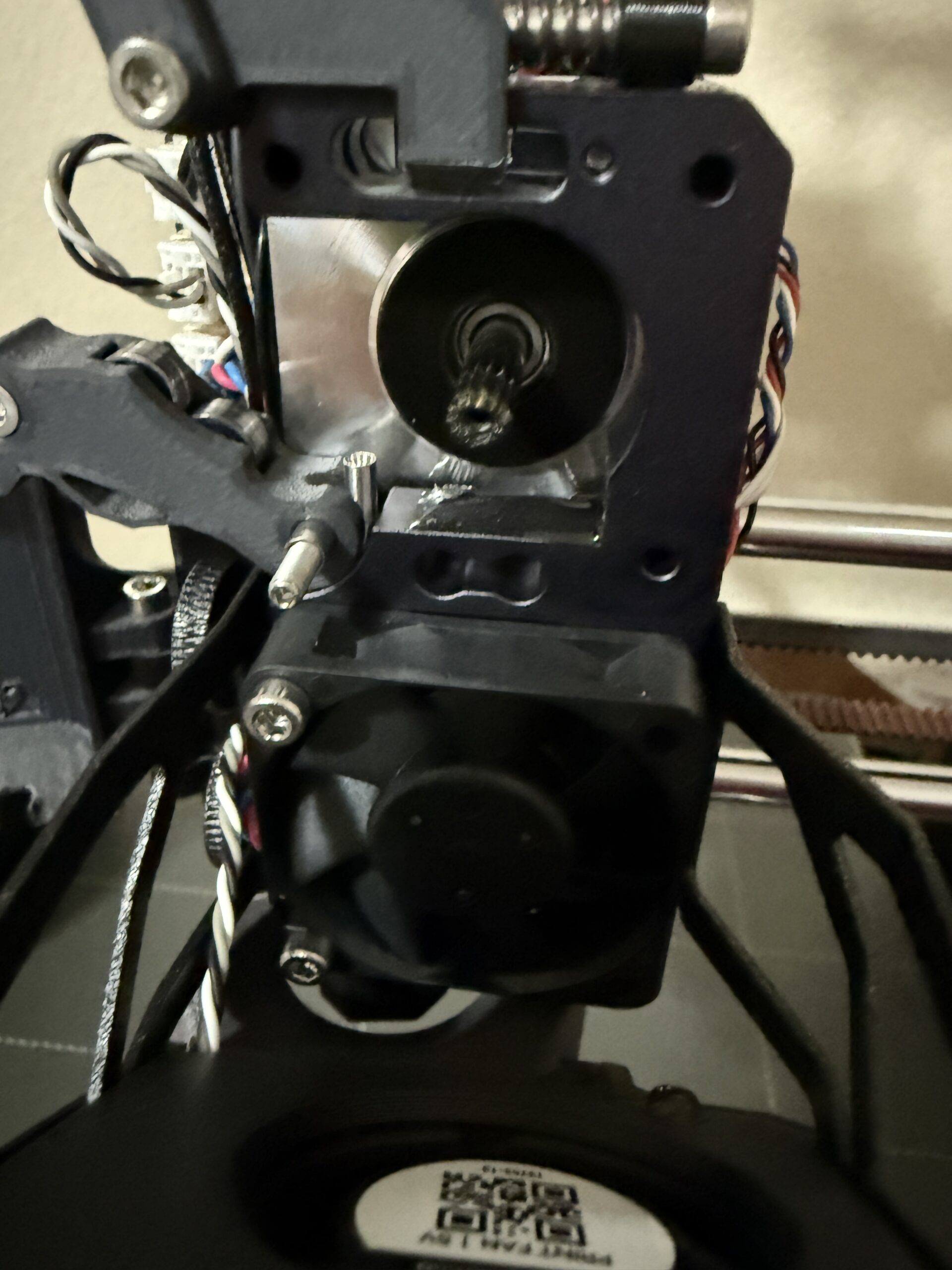

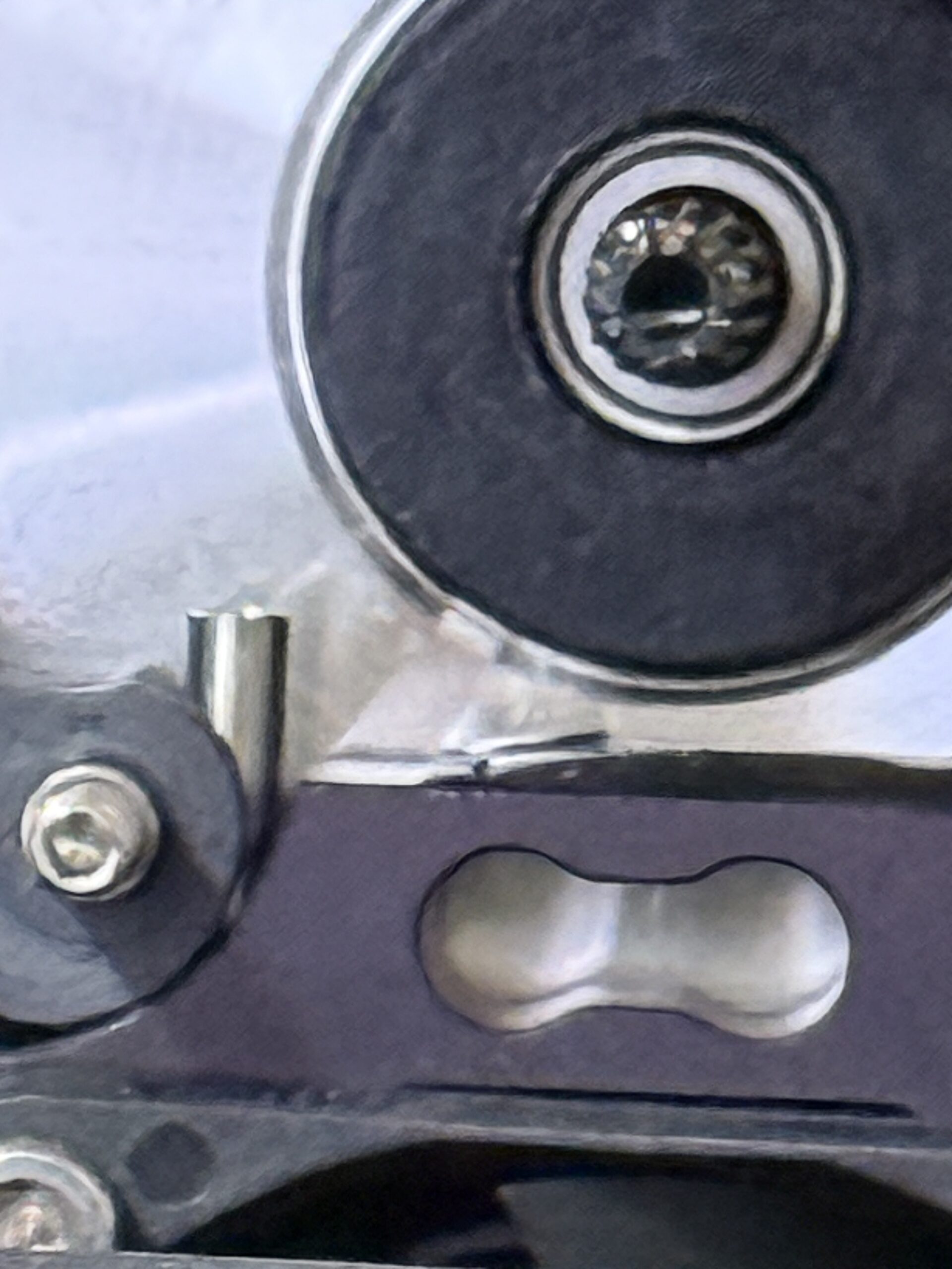

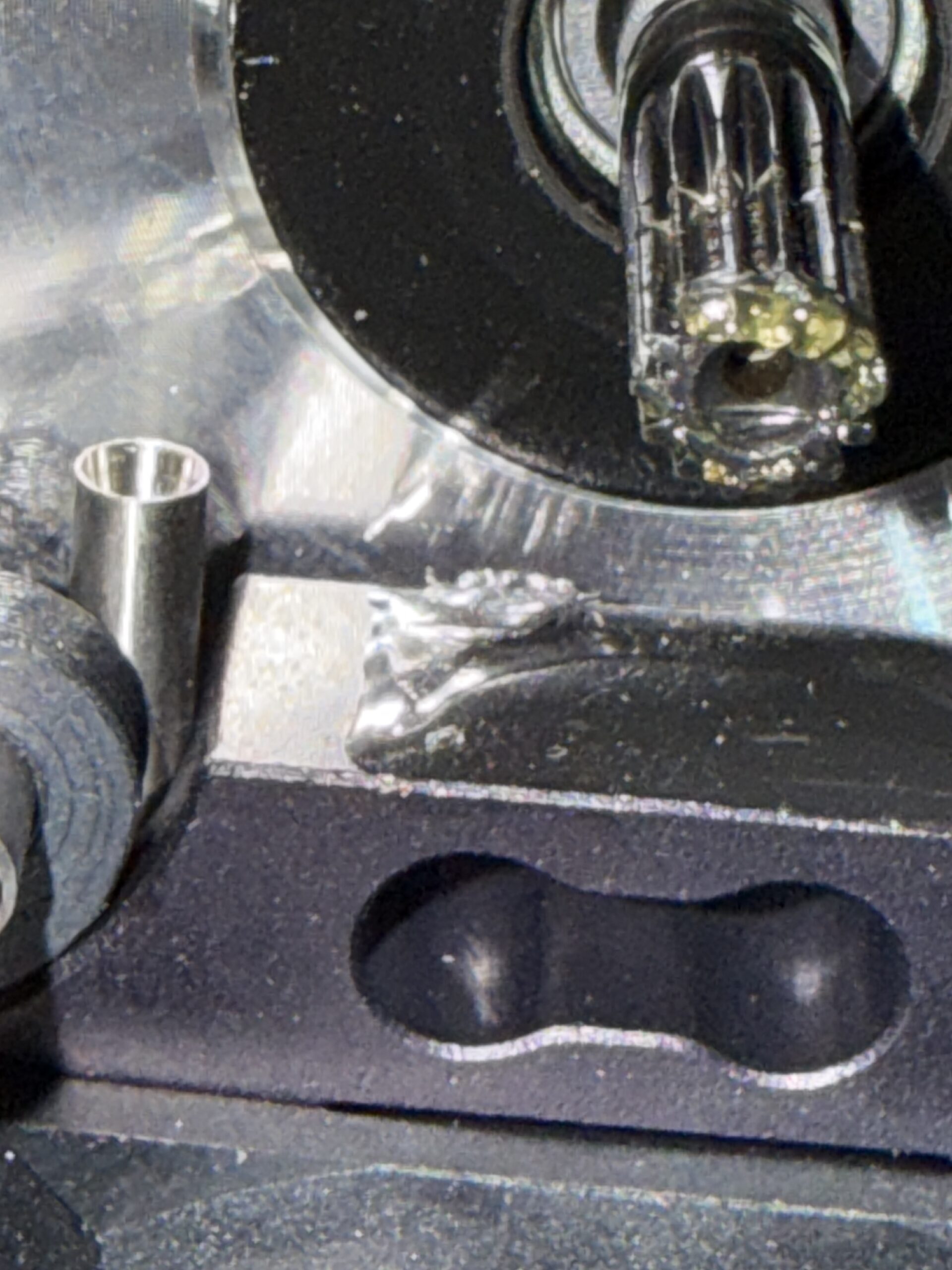

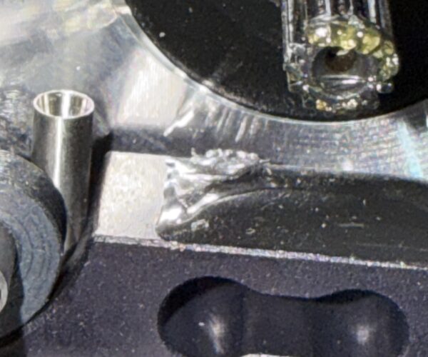

Here is update for my issue.
Since I got the MK4S with MMU3 fully assembled, I have the standard nozzle installed on it. As per Prusa website “In the MK4S/MMU3 bundle, you will receive both nozzles in the package - the standard one as well as the high-flow nozzle. For assembled MK4S in a bundle with MMU3, the standard nozzle will be pre-installed on the printer as the default”. I also double checked that the other nozzle is the high flow nozzle - it’s listed on the bag.
I did a hard reset and calibration and this time I was able to pass the loadcell calibration test again. However printing test showed the same problem again - filament stuck error.  I was sent a replacement hotend heatsink due to customer support thinking loadcell was bad and I did one more troubleshooting step. I followed the additional instructions listed for “Loadcell Measure Failed”.  I went beyond inspection of connector and cable (which I did previously based on customer support recommendation) and did the loadcell white pad visual check which are listed as steps 1, 2 and 3. I was surprised that my installed heatsink seems to have a black pad rather than white, and it seems to have some damage.
I don’t have the PG-assembly-adapter since I bought fully assembled unit and replacement hotend heatsink doesn’t have the filament sensor installed. The heatsink unit I received had loadcell cable but not the filament sensor installed. This is supposed to be all-in-one unit for MK4S, based on Ifti’s Tech Corner youtube channel MK4S assembly instructions. I don’t know if the pad is the problem or if it’s something else and don’t want to spend a lot of time trying different things and then hoping it will work.
Customer support finally got back to me by email, and they don’t want to send a replacement but said I could send printer back for repair. They listed they have a long queue and it will take some time to get it back. If I send it back for repair, I will exceed the 60 day return window since I’m in the US, so I have asked them to start the return process. Unfortunately, it seems my printer is one of the problematic ones, so don’t want to end up with non-functioning and expensive “paper weight”.
I am disappointed as I really wanted this to work as it seems like Prusa is a good company and I wanted to support them based on all they’ve done for 3d printing. It seems that a large majority of customers have a great experience with the printers they receive but I find I’m in the minority group - part of those who struggle with problematic printer.
I added some pictures here,  if anyone runs into same issue and want to have it as reference. I can’t get really good resolution but seems like besides the pad being black rather than white, the pad has some bumps on it.
