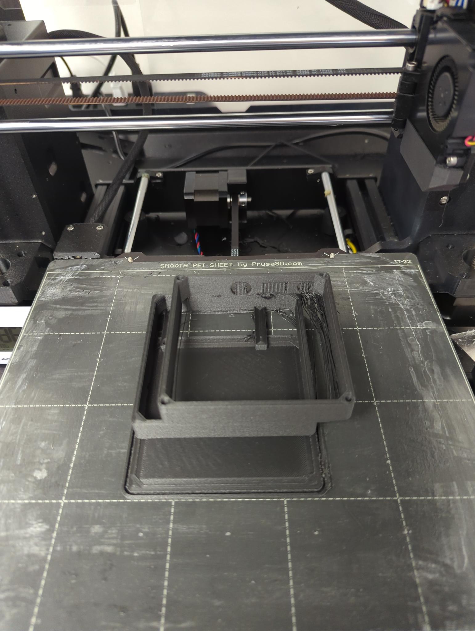

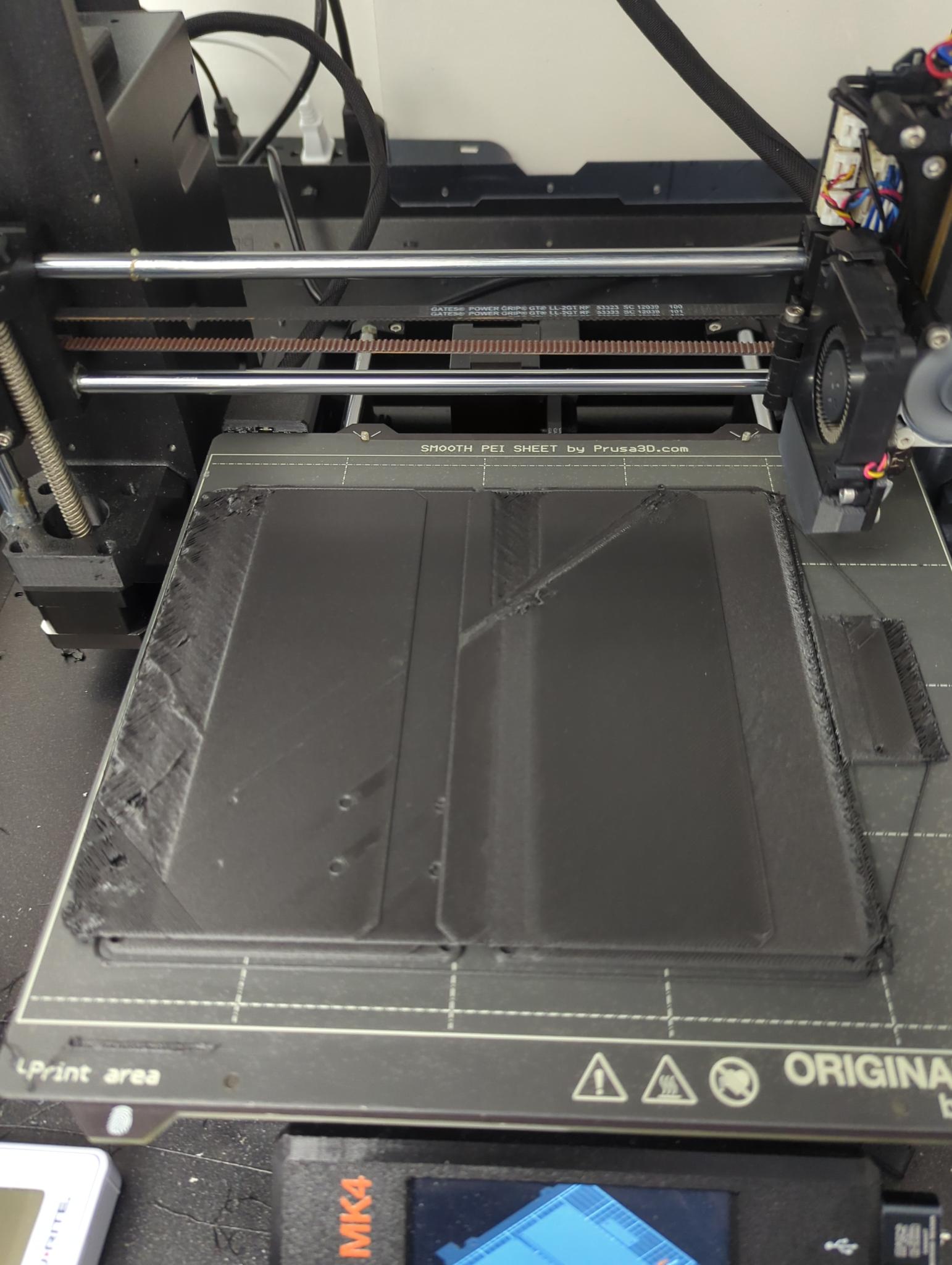

If we want to focus on problem solving rather than other things what you have here is substantial layer shifts. This should only happen if there is some underlying serious issue with your machine. A very common culprit is a loose grub screw in the belt gears. I would check all of those and re-tighten all of them while at it.
Another thing to check for is if the machine triggers crash detection. This can happen either because you have adhesion issues and the nozzle is indeed crashing into the part or it can be falsely triggered crash detection if some bearings have a bit too much friction. At least that is valid for the Mk3. The Mk4 also has this kind of crash detection, doesn't it? Anyhow, if it does, deactivate it. I found it causes more troubles than it does good.
Last but not least. First layer adhesion. The blob of doom you had later on as well is something you can get with any printer if you have insufficient 1st layer adhesion. Usually that is because the print bed is not clean enough (fat residues from touching it with bare hands). There are tons of threads on that aspect. If you want to be basically 100% safe against blob of dooms, simply revisit your printer after the first few layers. It basically only happens if your adhesion is so poor that the object detaches already in the first few layers. If the object detaches fully later, you get a relatively harmless spaghetti monster instead.

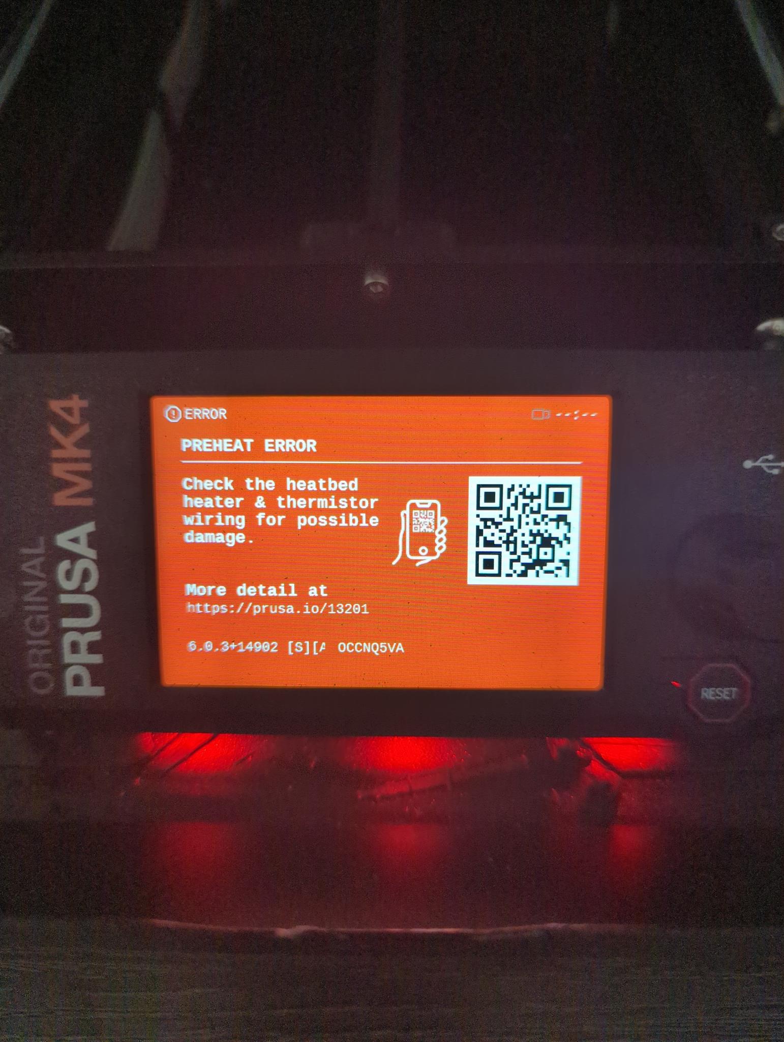

If the thermistor error accured after cleaning up a blob of doom, it is very likely that the undoing of that blob damaged the thermistor wires, which can happen very easily if molten plastic attaches to them.

Back to troubleshooting / providing more data related to the layer-shifting the OP posted about, I have a couple new pics in that google drive folder which shows another part with a much larger layer shift, akin to what the OP was showing:  https://drive.google.com/drive/folders/15dp3zOWuGWOSClgIHcVNNwGdq7QXVMx3?usp=sharing
I checked the grub screws on the pulley and they're solidly tightened and I checked the tensioning of the belt.  Since those were both to-spec, I have to assume it was a "blob of death", some build-up which caused the print-head to skip, lose its place in X.  Would all of you wiser, more experienced hands agree?  If so, how is the OP (and myself) able to avoid it?

Aside from the bed looking pretty dirty, it also looks like you didn't watch the first layer or so successfully complete.
The first layer clearly failed and then the printer was just left to run and destroy itself.

Regarding blob of doom. Like Ipind 3D said, watch the first few layers. You don't have to babysit the printer but if you want to ban the risk of blob of dooms, have a quick look at the print bed after a few layers. If something is not right abort.
Learn how to ensure good bed adhesion, especially how to clean the bed and how to keep it clean.
I have never seen a report of a blob of doom to date that was not caused by a very early bed adhesion failure.
This is the case for any printer btw, no matter if  Prusa, Bambulab or Ender. CoreXY or CorXZ.

Not to downplay your issues but I've been running my MK4 pretty much daily for 6 months without issue.
Early on I had the ball of death and I discovered it happens if you don't clean the nozzle before your print starts, especially if you print filament that oozes like Petg.  If you leave buildup on the nozzle and don't clean it before the print the nozzle will pick up the bed incorrectly due to the buildup.
If you make sure the bed and nozzle are clean before the print you shouldn't have issues.  I clean the nozzle and bed before every print and the 1st layer is always perfect, and the .9 stepper motors make beautiful prints.

I had layer shift issues (like the ones shown in the picture). I did a belt tuning/tightening of the X axis and it is gone. Belts stretch a bit from manufacturing to use over time. I woudl suggest that.
