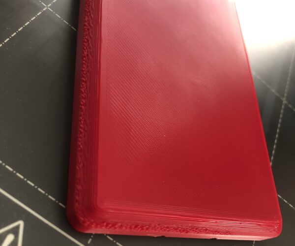

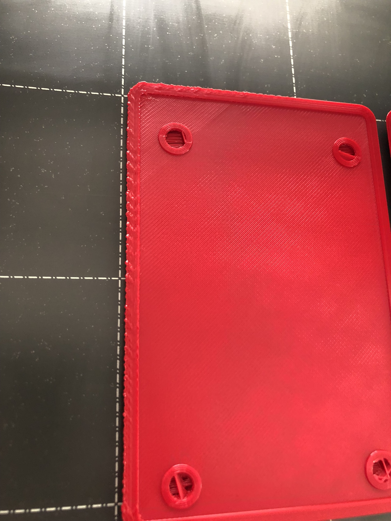

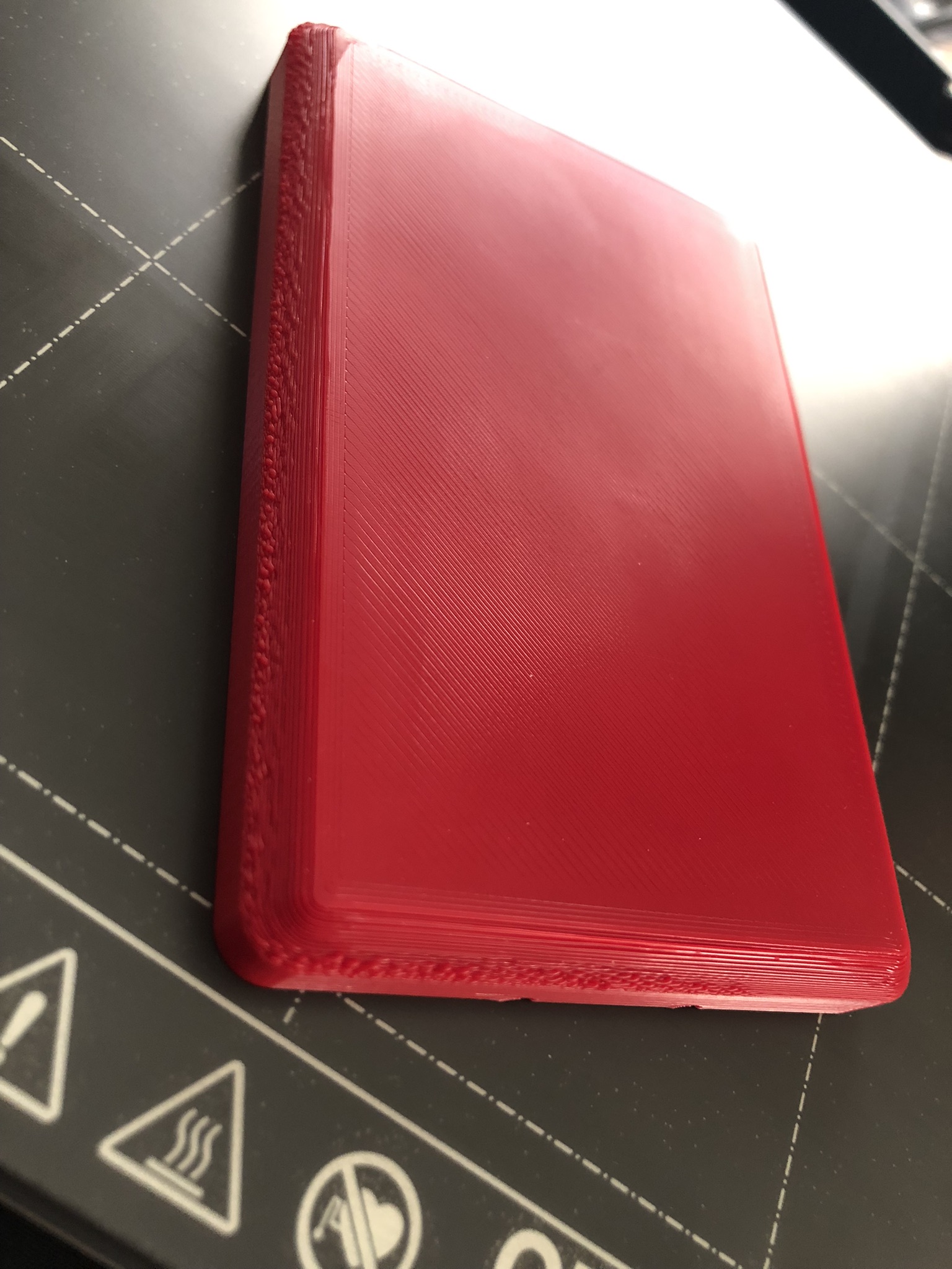

kumaichi
(@kumaichi)
RE: Two Part Bed Adhesion
Yes, I inadvertently uploaded the project after I started trying to naively get myself out of the adhesion issues, I've been running into, my apologies for that.  Thanks to everyone's suggestions I've made great strides.  Even though there is one slight issue remaining, prints have never come off this printer so nice, thank you so much.
I started by using the project file uploaded by @foxrun3d, the initial print had all the corners raising off the bed at around 30-40% print completion.  I then changed the settings suggested by, @artur5.  Making the first layer nozzle temp to 210C and all subsequent layers to 205C.  I also increased the bed temperature to 60C.
These combined changes produced a beautifully adhered print and it's just beautiful!
I do have one last issue, for some reason, on the bottom piece (left item), the back and left sides, seems like it's "tearing".  And during printing, is sounds like the nozzle is actually scraping on the part, very unnerving, especially with the correct speeds.  Is there anything in my part design that might be causing the issue?  Maybe the radius on the bottom of the part?  Strange thing is, the top piece (right item) printed beautifully, no issues at all.  I've attached pictures of the issue I'm encountering; any insight would be greatly appreciated.
Kindest regards.
