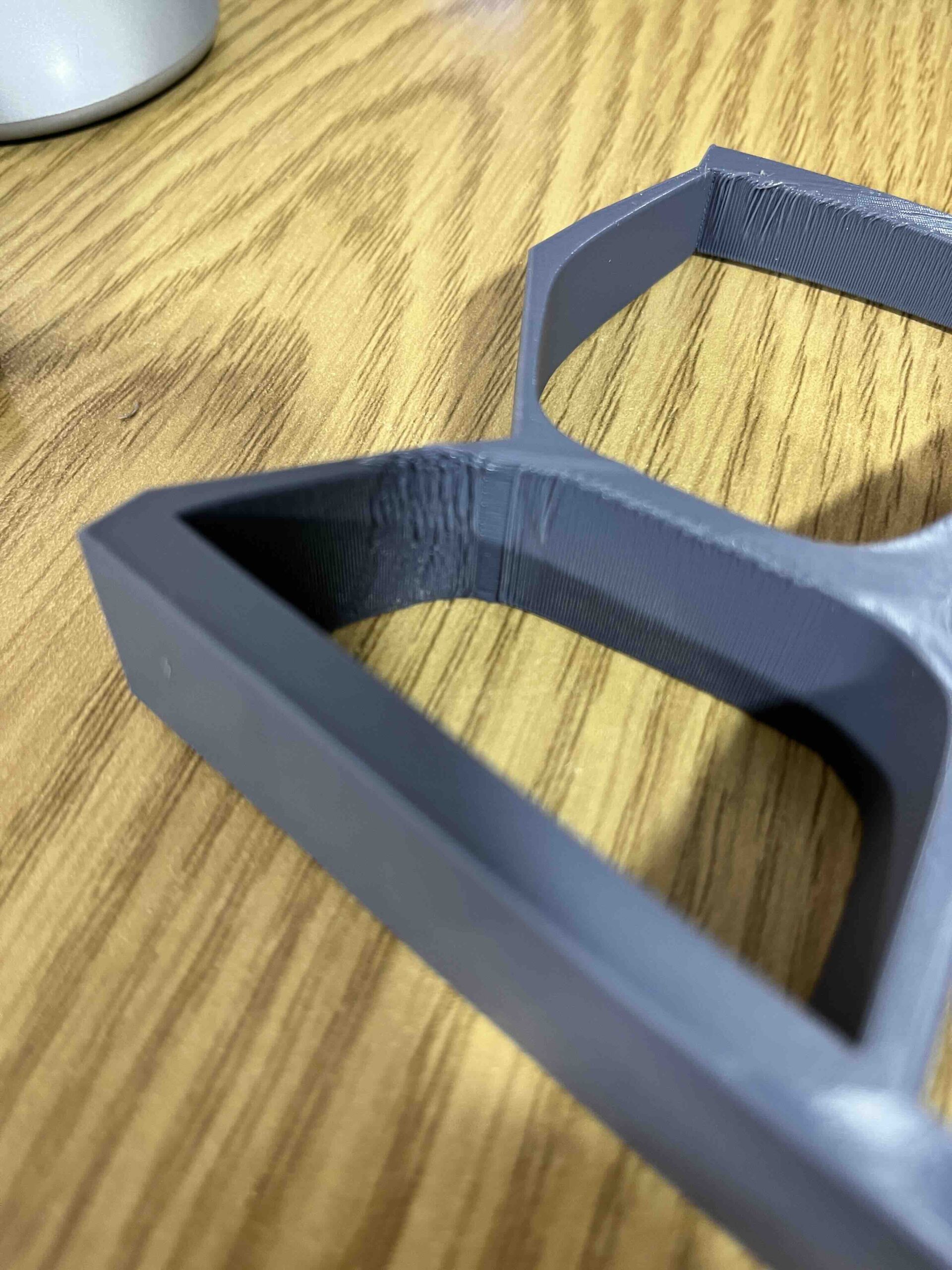

The quality of the MK4 is very high, certainly higher than the two Mk3s+ I have as well, but I'm struggling to get the top, curved surface as good as possible without sanding it. As the whole of the top surface is gently curved when then leads to a fillet curve. ironing doesn't work.
The bottom is flat with a fillet at the end, so I normally print on the bottom face with support for the bottom curved edge. These supports break away with virtually no impact on the bottom surface.
I can't print on the flat edge (on the left below) as that requires supports on the inside and they leave damage no matter how fine I make them.
Here's the sketch for the top of the bass, you can see the gentle curve. Ignore the very gentle curve at the bottom in the sketch, thats not used.
Here's a piece in side profile, you can see the bottom is flat and the top has this gentle curve.
Any advice how to get the top as smooth as possible welcomed. It always has little tiny ridges as the curve is probably too gentle and even at 0.1mm layers, its not possible to get it smooth.

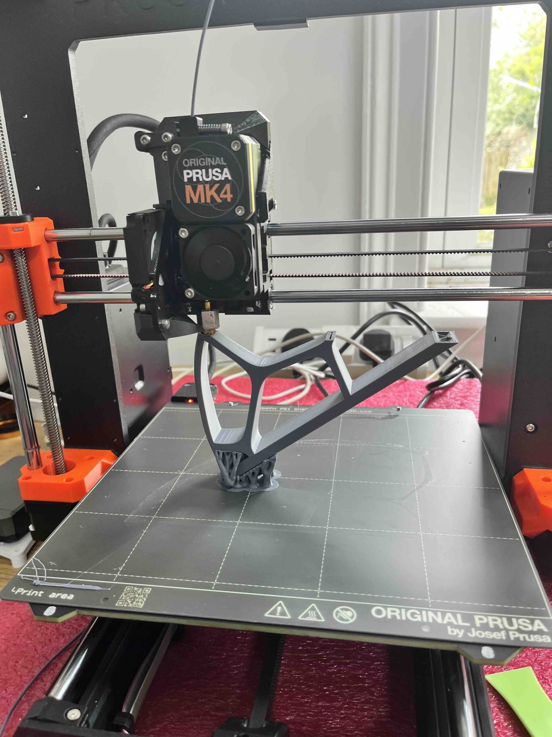

Without your parts to experiment with its not possible to say with certainty.  However you could try angling the part upwards, like this
If you are printing in your original orientation then you are limited by the thinnest layer height you are willing to print at.  With gentle slopes that will lead to stair stepping, theres no way around that.

Thanks for taking the time to reply, Thats very interesting. I never thought to do that, so something like this
That might work, I'll give it a try 🙂 It just fits on the bed, 21 hours of printing on the MK3 and 10 hours on the Mk4.

On that top pic, if the bottom is flat at that slope there is no need for support going all the way up usually.  Just a few cm at the bottom and its will be fine.  Just make sure your bed adhesion is good.  I's also use snug supports as it will be more efficient than tree when done right.  Just use support enforcer painting to define the area(s) you want supporting.

I'll try that idea and reduce the support tree. I'll stay with organic for the moment and will probably stop the print half way up. Lets see what it looks like 🙂

For information.. I'm a little surprised at how well its printing. Always good to learn something new.

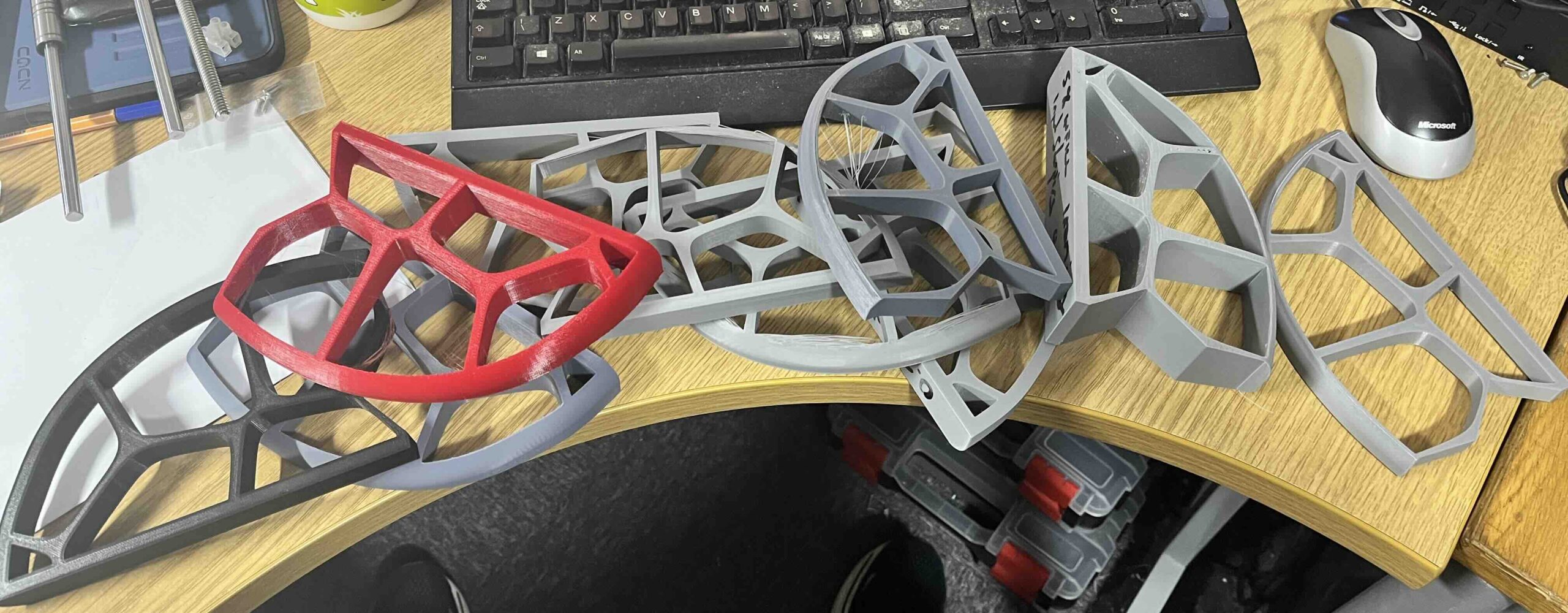

This is the output from the upright print above. Below is one unsupported corner, the lack of support clearly shows
This is the part of the model in the picture above
So I'm not surprised that not every section is perfect, it wasn't designed to be printed like this and to be honest, the results are better than I expected.

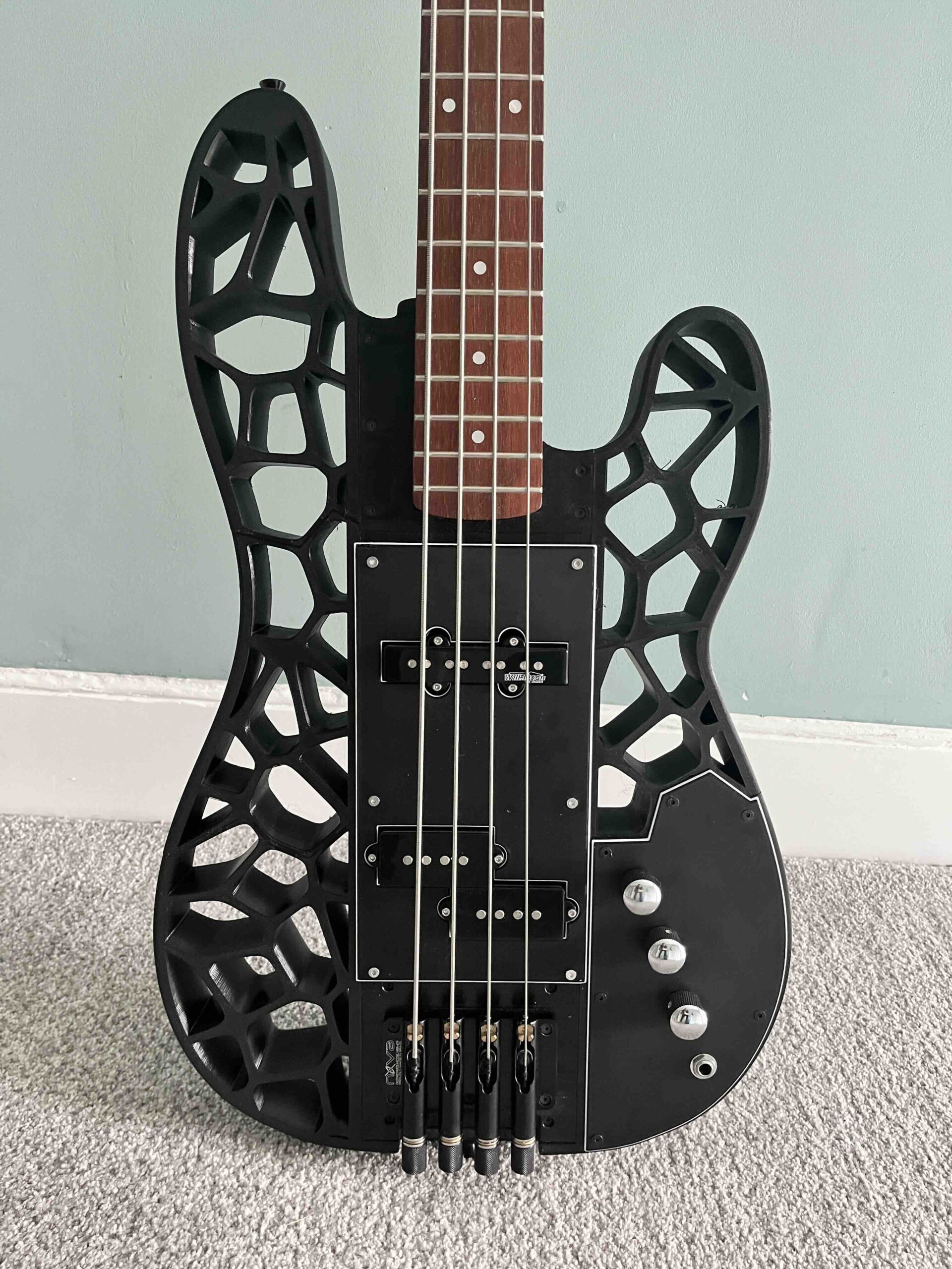

And this is what the previous version headless bass guitar looks like...This design had smaller Voroni cells, the new design has far large ones.
I would put some other pics up, but they get made square and a guitar ain't square, It plays well, not quite as nice as my Fender Jazz, but not bad.
