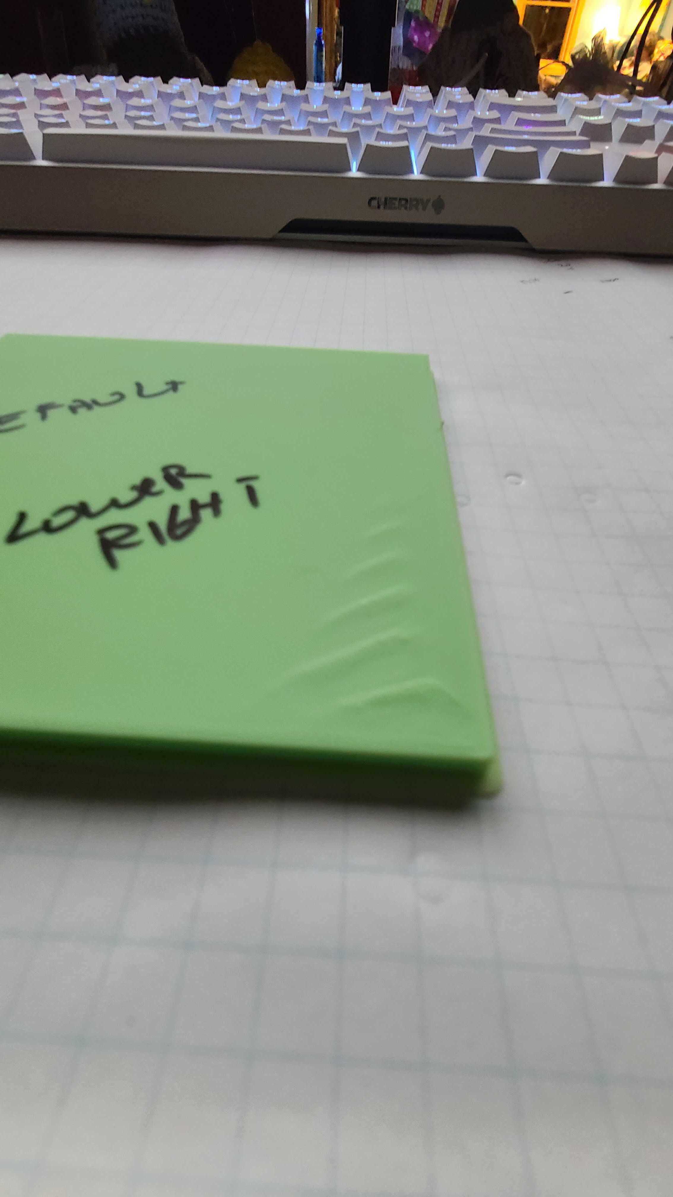

lots of tests last night, with more to come tonight.   bottom line is that when i print my 100x100x8 rectangle on the left side of the build plate, there are no artifacts whatsoever (surprise to me)!  and as i move to the right side of the plate, i start to get the artifacts shown in the pic.  the worst artifact is achieved in the lower right of the build plate.
I am running the input shaper, and cant help but wonder if that in conjunction with the fact that the right side of the Y carriage has the single bearing, where the left has the dual bearing, isnt somehow causing this.  i will print tonight with the input shaper off just to see.
it also looks like over extrusion to me as its printing, so i will try to drop the extrusion multiplier tonight as well, to see what happens,
also checked my plate with a straight edge, and its flat.
stay tuned for more....

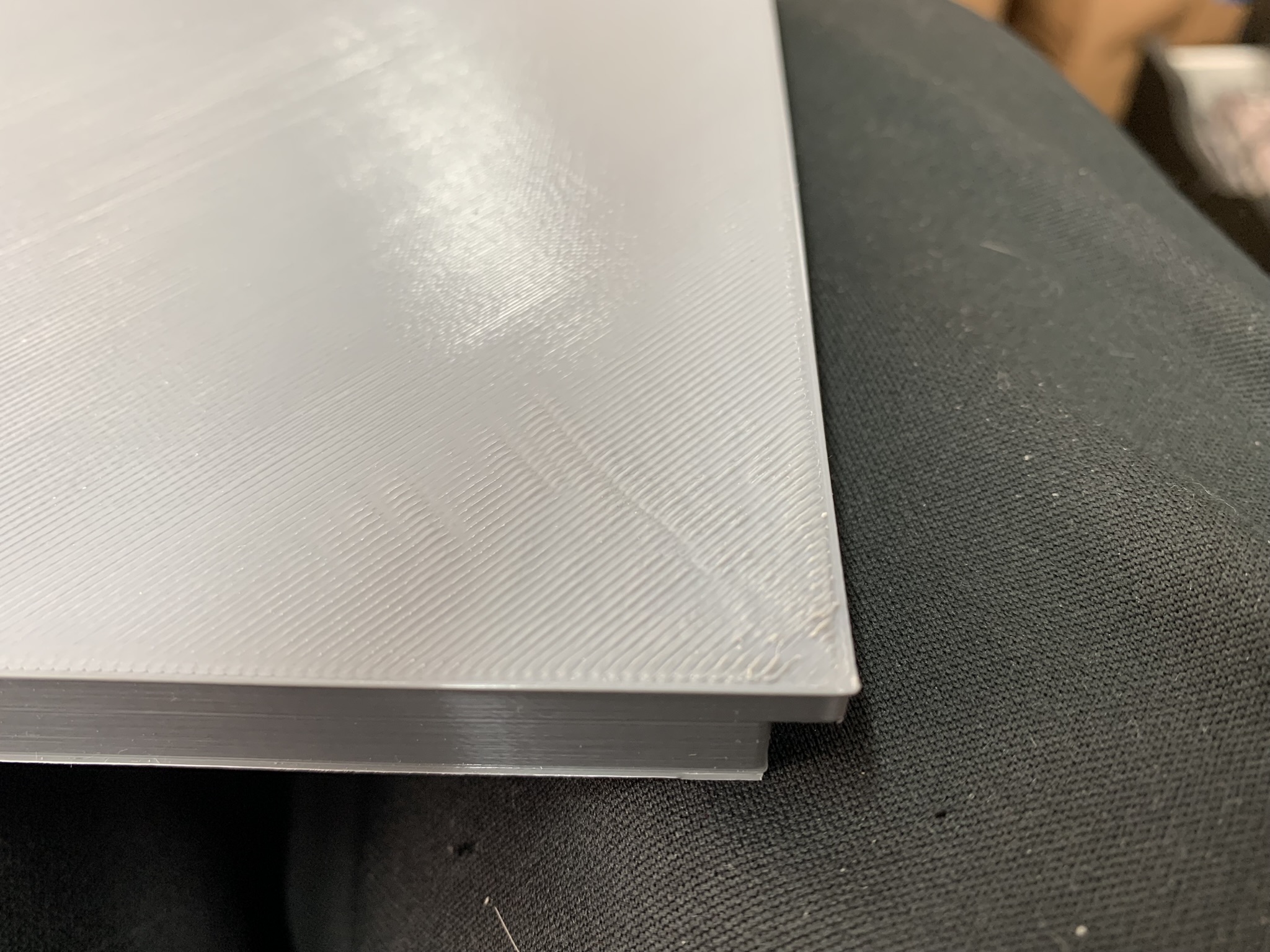

oh, and the reason i was suspecting some over extrusion was that i printed the top layer in octagram spiral (just to see if it made a difference) and the corners looked like this:  they should all be nice and flat, but where you see the ridges are where it printed a line between two completed areas.  looks like too much material.

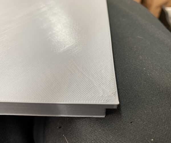

where it printed the fill as a contiguous feature, it all looks nice and uniform:

Alright!  Success has been achieved!!!
First, the problem wasn't the input shaper (i had to test it). And, the problem wasn't the print lifting from the print plate. The problem was the print plate lifting from the heat bed!
I added clips as suggested above and immediately achieved a perfect print with all defaults.
Now, this was an early make mk3 upgraded to a mk4.  I wonder if that has anything to do with it.  My friend has a new mk4, and I had him run these tests, and he has no issues right out of the gate.
Posted : 04/01/2024 2:14 am
