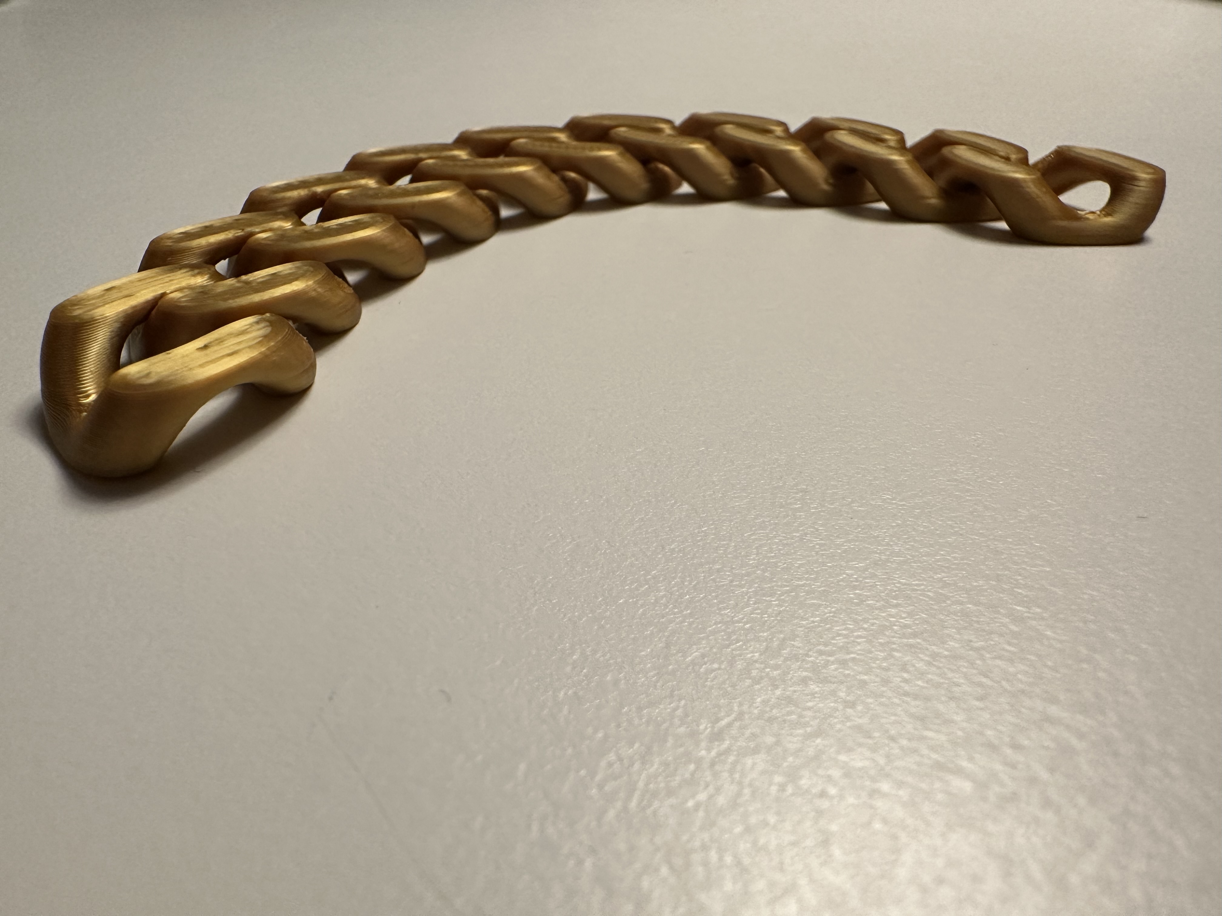

Prusament PLA Blend Viva La Bronze
MK4 Input Shaper 0,15 structural, 2 perimeters, 15% infill. Scaled the spiral chain 10 links to 160%. The length is then around 155mm.
I want the  flat surface part more evenly. Perhaps more perimeters?
Any advice is welcomed!

turn ironing on?

Print it with PVB, or ABD and vapor smooth it.

I've had fairly good luck doing vapor smoothing.
This is an earring pendant I did a couple of years ago. I know it's not crystal clear but surfaces are smooth and shiny.
Hatchbox transparent ABS smoothed by hanging in a jar with acetone in the bottom.

Sorry I miss typed, ABS not AVB

I’ll give this a try
https://help.prusa3d.com/article/ironing_177488

Thx. I think PLA should do the job if the settings are correct

Thx. I’m familiar with this technique. I just have the feeling it that there should be more to get out of the print settings  to make it smoother .
