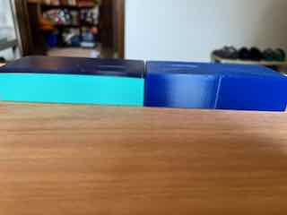

Are others still having problems with seams?  I am printing with ColorFabb VarioShore TPU and keep getting this.  Is there maintenance I need to do or an easy solution?

Are you wishing it wasn’t a line or just too wide a seam? You may know seam position can be painted on manually to a different position, or you can choose a random seam.. You might notice a few dots for the random seam, but you can use “fuzzy” skin on outside to hide that.

I've printed the same item before without any lines.  I'm not sure why now I'm getting the same line in the same place.  I did just update the firmware.

In Prusa Slicer (Expert mode) under PRINT SETTINGS > LAYERS & PERIMETERS look at image.. Maybe an update changed the setting here.. You look like you have an aligned setting.. change Seam Position to random or try others..  (click on image

Yes, I have similar problems.  Looks like over extrusion to me.  When I try and randomize the seam I get dots all over the place, like in the picture.
I am going to play with the extrusion multiplier to see if I can affect it, unless people have other suggestions

That's exactly the result I got.  I put the seams back because the dots were pretty bad.

It seems to me that seams got much worse with IS (input shaper) profile enabled. The seams were barley visible before, but with IS profile, they are quite prominent. You can try to switch to a non-IS profile until Prusa solves this problem.

I have the same problem. I did not have that kind of seam problem on MK3S+, but it seems it is related to MK4IS profiles. I use default settings.

Has anyone been able to reduce the seam? Items I printed before updating firmware do not have the same unsightly seam problems. Here is a before and after firmware update and no other settings have been changed.

Two recommendations for seams: if you can, try painting them on a corner, as it makes them less noticeable. This would be easier if Prusa ever implemented this: https://github.com/prusa3d/PrusaSlicer/issues/5970.
A second option is to use OrcaSlicer. It has an experimental feature for "scarf seams". They use a gradual overlap and are much less visible. However, OrcaSlicer doesn't have recent versions of the Prusa profiles, so it may take a bit of setting up.
