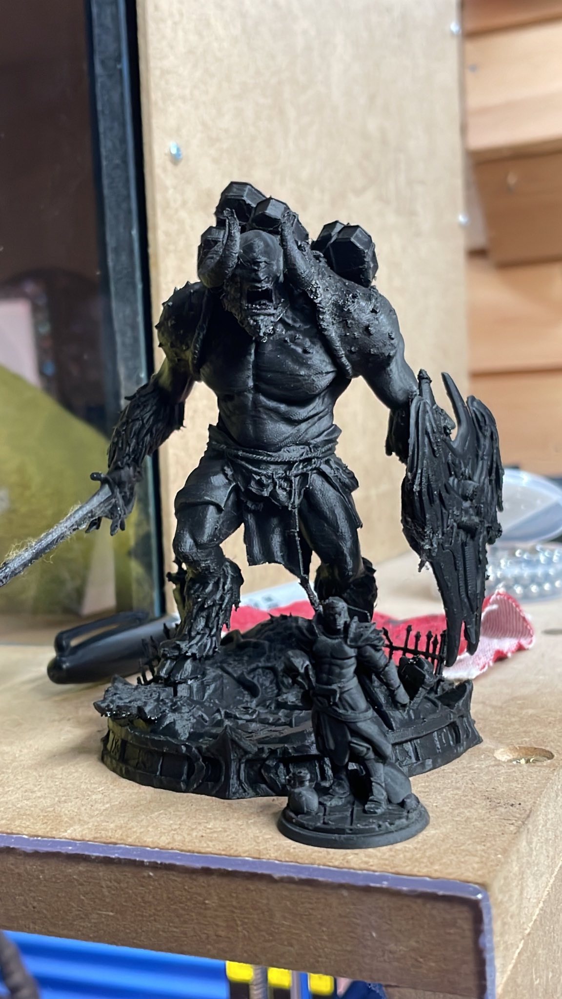

This dance I am doing to try and get this stuff to stick is absolutely bonkers.  I love my poly terra Charcoal Black so much.  I cant even print one mini let alone a bed full .... it's dried for 8 hours ... trying 70 on the bed now ... Should I break out glue for the smooth sheet? Poly terra is almost a fight to get it off at 60 ......cost less and I spend less money to print it because I dont need glue .... or more heat.  /rage. =)

To note, that's a .4 ObXidian Revo on the MK3S+ that did that. I rushed the last few minutes with messed up the sword end and horn tips so I could throw another print on before I went back to work. >< The mini in the Foreground is off the MK4 and .25 nozzle X adapter with PolyTerra CB.

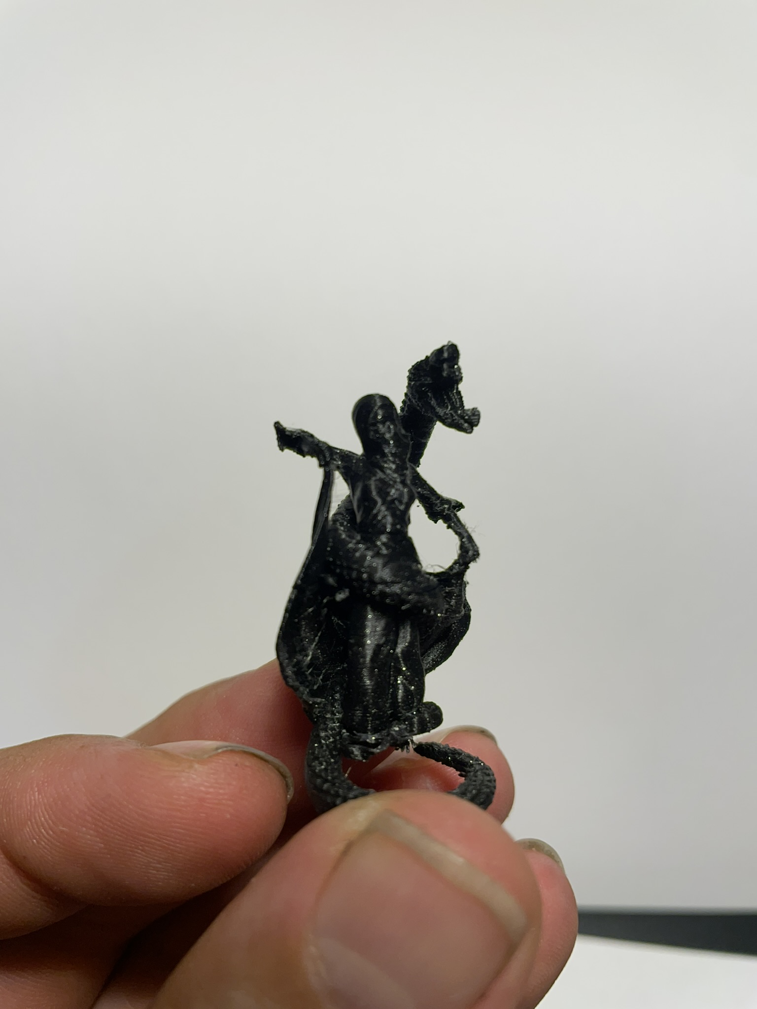

I have only achieved adhesion at bed 70 .... also using glue because I would like to use it, the filament that is.  And to be clear, the same exact sheet printed fine @ 60 for the PolyTerra. All setting exactly the same with exception for filament profiles. There are apparently batches where this happens. I suspect it has to do with a bad mix of the "flakes" in the black. Will experiment a little more with actual print temps now that it is not coming off the bed.

To be doubly clear, I printed what the P-GB failed at with PT-CB directly after the fail to "check" the sheet.
