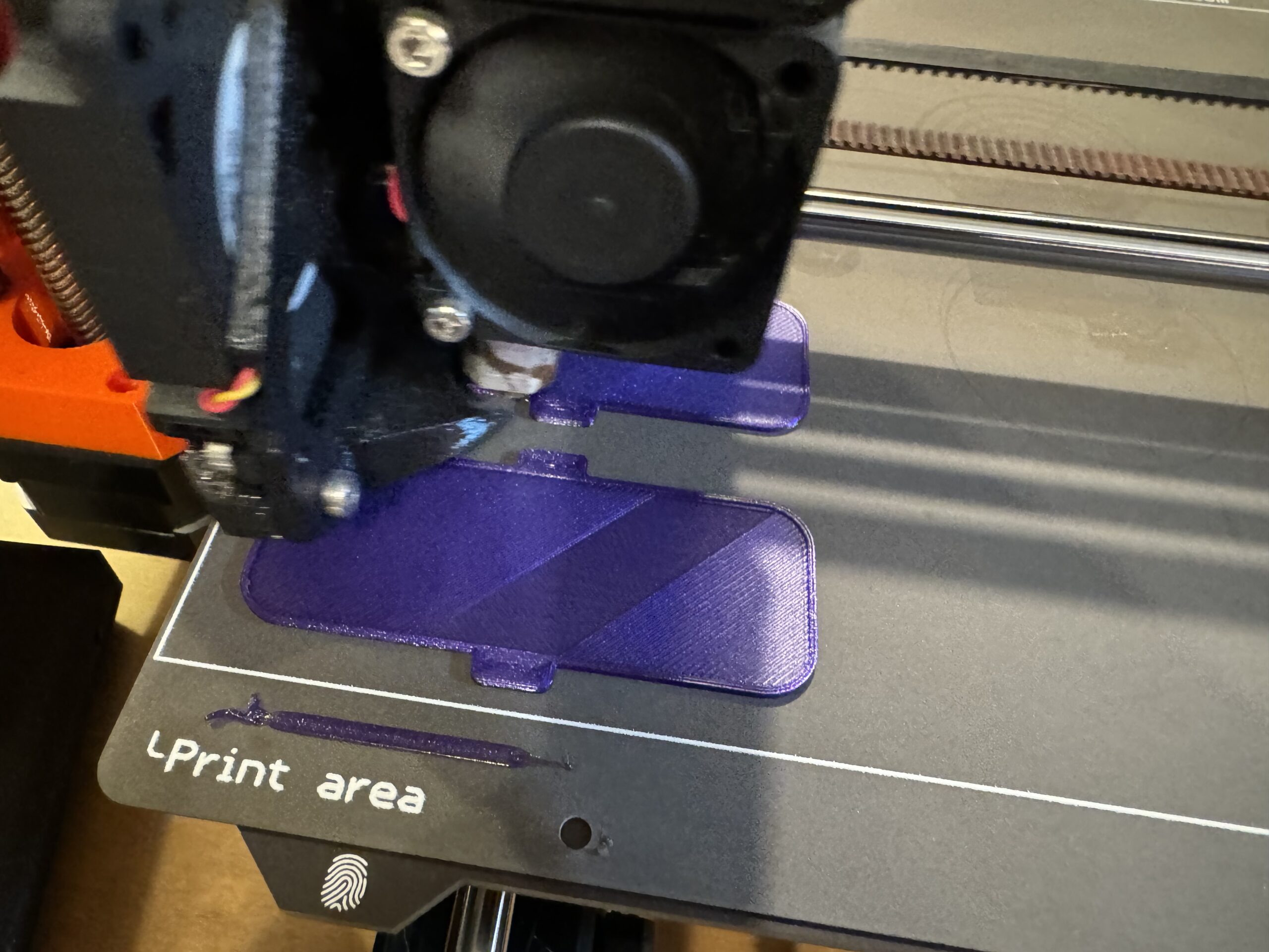

Not sure if my issue is related but I was printing a small object (takes about 8 min with IS) perfectly fine but when I tried to print 30 instances of them at once I was getting blobs that would cause problems ruin the whole print. After third try I looked closely at what was printing and it turns out that the printing for the parts was incomplete - perimeters and most of the infill was done but some infill just wasn't done. Checked the simulator on PrusaSlicer and everything looks fine there. In any case, I'm trying with direct USB copy now (was using WiFi) to see if that works. Either way it's pretty strange.
Postato : 29/05/2024 11:37 pm
RodB
 RodB
(@rodb-2)
Utenti
RE: Prusa MK4 missing lines randomly
OK - ignore the previous post - turns out the problem is my filament does not like being printed that fast and it's severely underextruding with fast infill spaces so it *looks* like it's not printing there. I'll slow things down and see if that helps. It's an off-brand translucent PETG filament that happens to be just the right color.

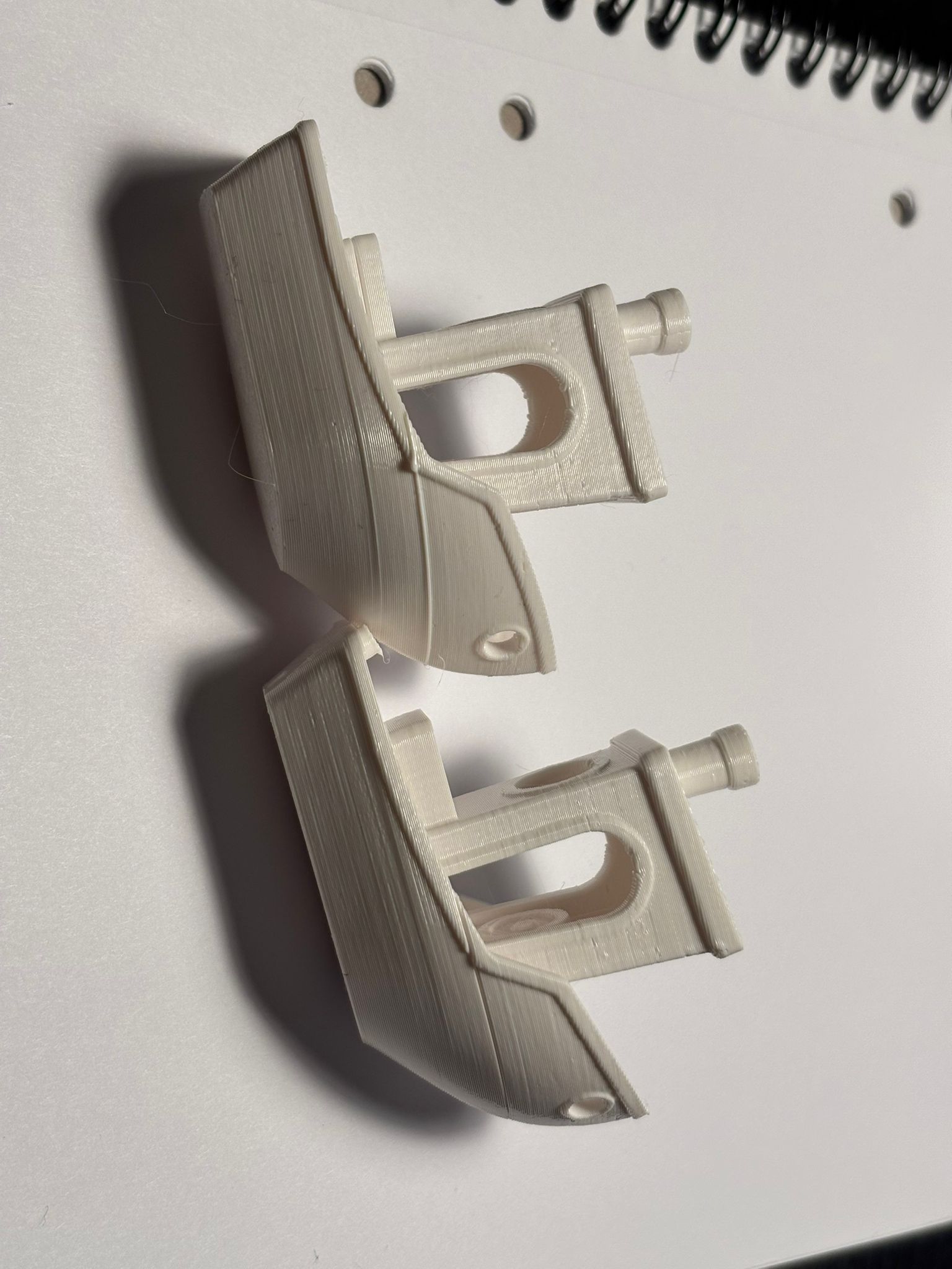

I spent some more time tying to see where the problem comes from.
  • Prusa Connect - "Upload and print" 3 benchys, 2 of them had missing lines
  • Prusa Connect - "Upload" and then print on the printer, 3 benchys, 1 of them had missing lines
  • Prusa Link - "Upload and print", 6 benchys, no missing lines on any.
Files does not show any difference when G-code is compared between the slicer and the printer when used Prusa Connect.
Postato : 26/09/2024 5:24 pm
Printerman
(@printerman-3)
Another issue i found, the prints with both Prusalink and Prusa connect(upper benchy) have small dimples in some areas, and the ones printed with USB transfer dont have any(lower benchy), so even if they arent missing any perimeters with Prusalink, its still not working properly.

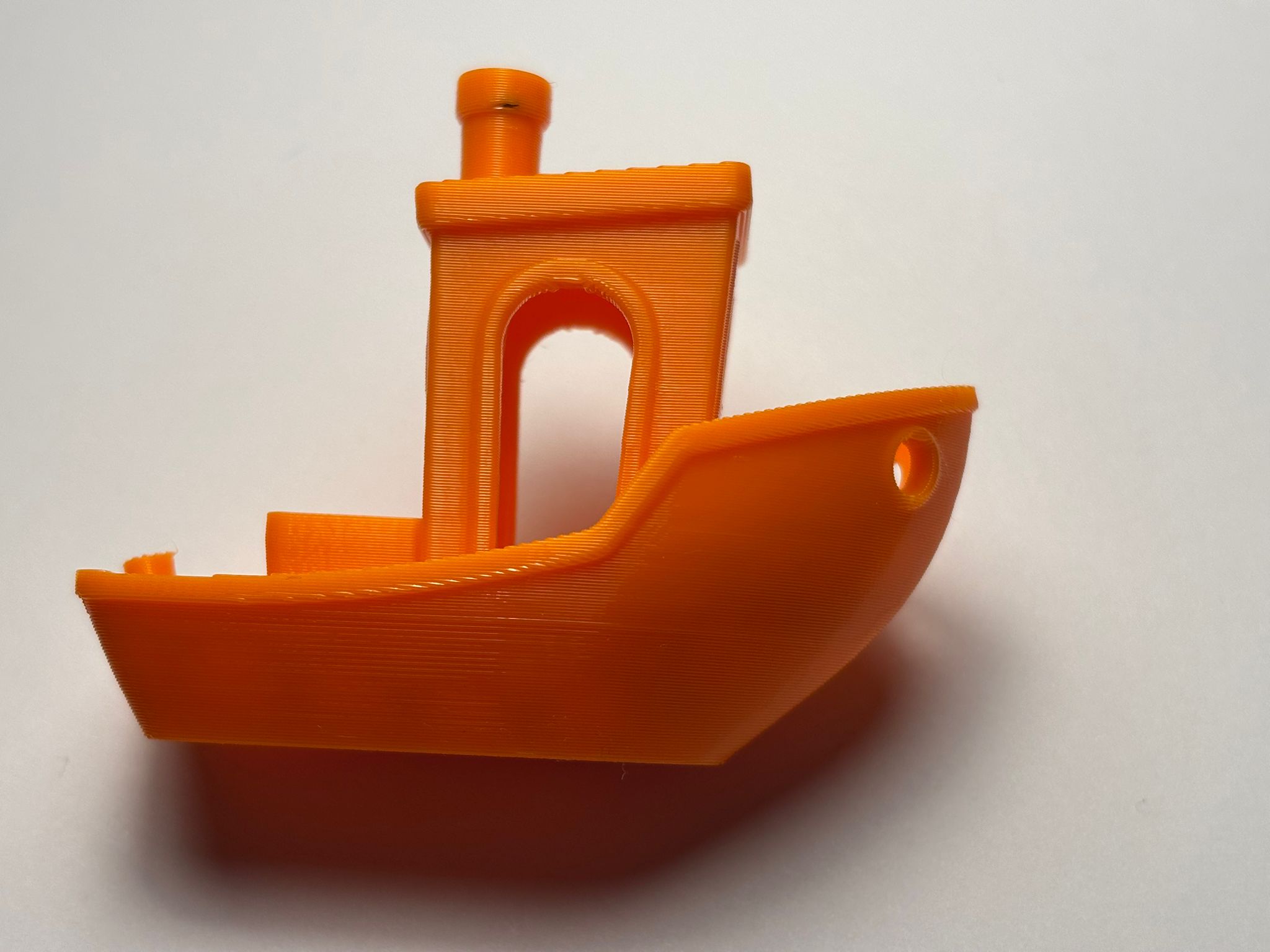

Printerman
(@printerman-3)
I installed the 6.2.0 Alpha 1 firmware on my MK4 and think that might have solved the problem! I will print a few more benchys, but the benchys look very nice and have no dimples/artefacts or missing lines so far!
