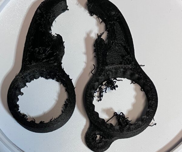

Very Good question. I recently purchased a spool of PA6-CF20 so I could make some Classic Car Heater Vents. The temperature on the spool says 290 to 300. My Mk4 only go to 290 so I'm at the low end of the filament Temperature range.
I haven't been able to tweak the print quality to an acceptable look yet, but I'm getting very close.
These are my current settings:
  1. Filament Temp: first and last layer 290°C   (nothing I can do here)
  2. Speed: 40mm/s   (I started at 60mm/s and I've reduced it to test print quality. Seem better at slower speeds)
  3. Cooling fan: OFF   (it hardens quickly on its own)
  4. Heat bed: first layer 50 then drop to 40   (Reduces warping) you may need a thin layer of glue on the bed.
  5. Using an enclosure to keep filament dry and warm. (I don't know if that's helping or not)
  6. 0.6mm nozzle, ruby tip. (I haven't tried it on a 0.4mm nozzle just because I don't have a hardened steel)
  7. Layer heights 0.2-0.3.
The issue I'm having is in the more detailed areas where it jogs and moves a lot, it has stingers and bump outs that go outside the part parameters, as if the filament was sticking to the tip of the nozzle and then being pulled off.
If anyone has some better setting, I'd love to try them.

Those little bumps and artifacts possibly mean that the filament isn't dry enough. Nylon filaments are VERY sensitive to humidity. Did you dry it before use ?.Even new sealed spools might contain already some moisture and nylon is merciless in this aspect.
You didn't say which printing plate are you using. Nylon has poor adhesion to PEI plates (be it smooth nylon or satin), so you need to use glue to get a decent adhesion but that works OK only for small parts. Huge models are a real PITA to print on a PEI plate. As alternative, some people uses garolite or glass plates with more or less success. If you're gonna print PA filaments on a regular basis, do yourself a favor and get a Prusa PA nylon  powder coated plate. It isn't cheap and you can use it only with PA, because the other filaments won't stick at all to this plate, but it's worth the investment IMHO.
Regarding your settings, think it twice before disabling totally the print fan. If you do that, overhangs and bridges will suffer and also when the layer takes less than 10-15 seconds to complete you may get unpleasant surprises. I never disable totally the print fan, even with PC, PA or any other high temp. filament. You may have to experiment in order to find out the best fan speeds for each filament. Don't rely blindly on the settings suggested by the filament manufacturer. There're lots of different printers out there and a default setting for all of them isn't gonna work in many cases.
For instance, I never printed Polymaker  PA6-CF20, but bed temperatures of 40-50C for nylon seem very low to me. You won't get good adhesion at these temperatures and you'll have to rely solely on glue to get the part stuck to the plate. I wouldn't be surprised if warping is much worse because of that low adhesion.

Well, I put the filament in the oven at 170°F for 1 hour to dry it out. (I Don't have any type of sophisticated drying equipment) The only difference I felt in the filament was it had a little more flexibility and didn't feel so brittle and stiff.
Ran two prints with slightly different parameters.
  • Printing temp 285°C and also a 290°C
  • Bed 60°C,  Smooth sheet
  • Fan speed 0 first layer, then all layers 25%, Bridge 50%
  • Enclosure 35-40°C
  • Printer Mk4, Speed 40mm/s, Ruby tip nozzle 0.6mm/ slice thickness 0.2mm
First printed at 290°C                                  Second printed at 285°C
Cooling Fan off                                                              Cooling Fan on
Is there a test print model for this material.  Seem like the smaller features have trouble. Also wondering if my temperature setting is too low. I can only get to 290°C.

As I haven’t direct experience with this filament, it’s hard to make any recommendation looking at the pictures, but I don’t think that the temperature is a real problem. Most PACF filaments print well in the 270-290C range ( I use 275C for Prusament PA11-CF ).
On the other part, drying the filament at 170F/75C for just one hour won’t fix a possible moisture issue, Manufacturers recommend that nylon filaments need a least 8-10 hours at this temperature to be dried properly.
 Comparing both prints fan speed doesn’t seems to be critical. Possibly 25% is a bit too much ?.  It would be preferable to reach 45-50C inside the enclosure, but I don’t expect that this helped much with the print imperfections.
My bet is still on wet filament.
