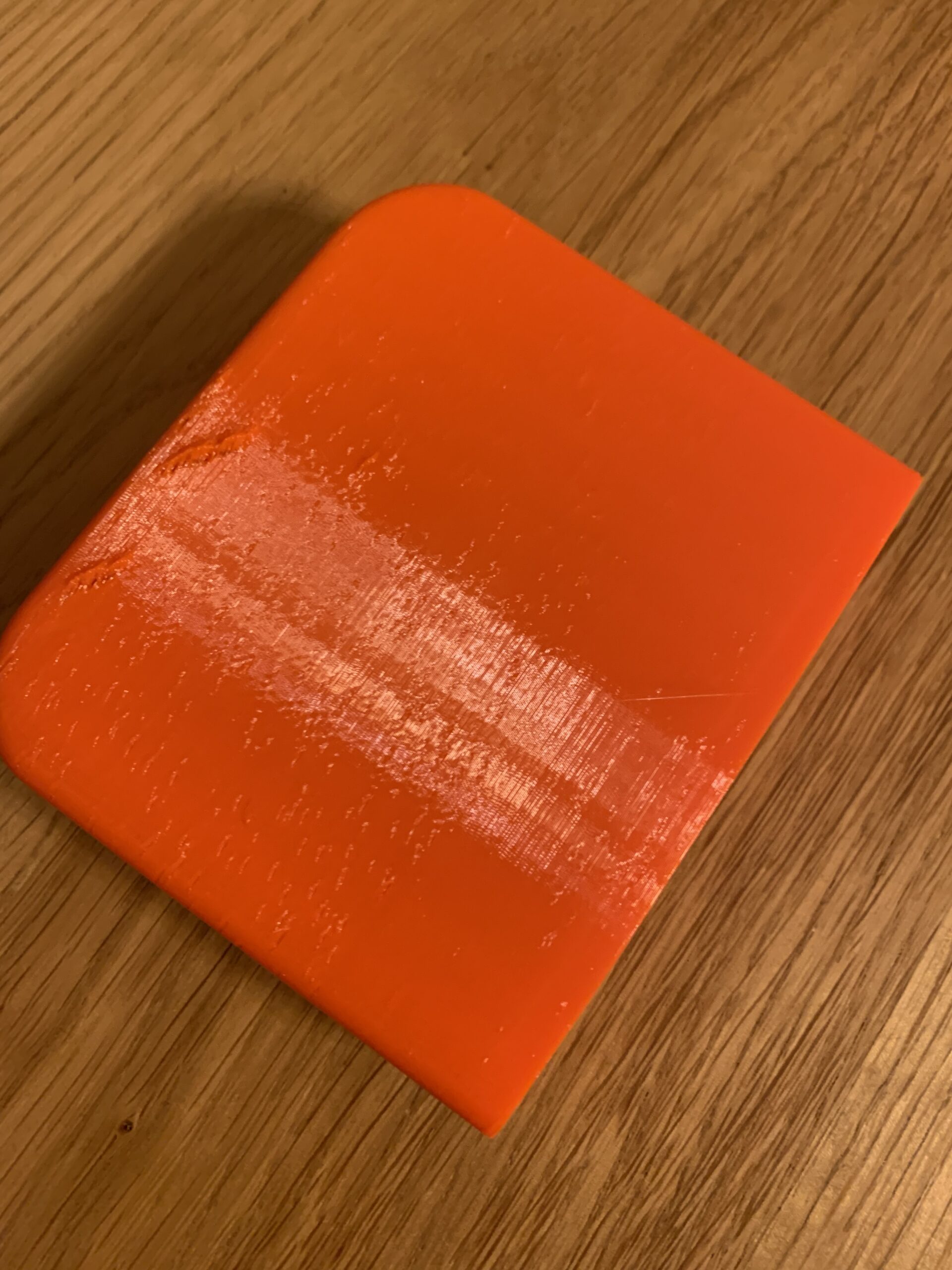

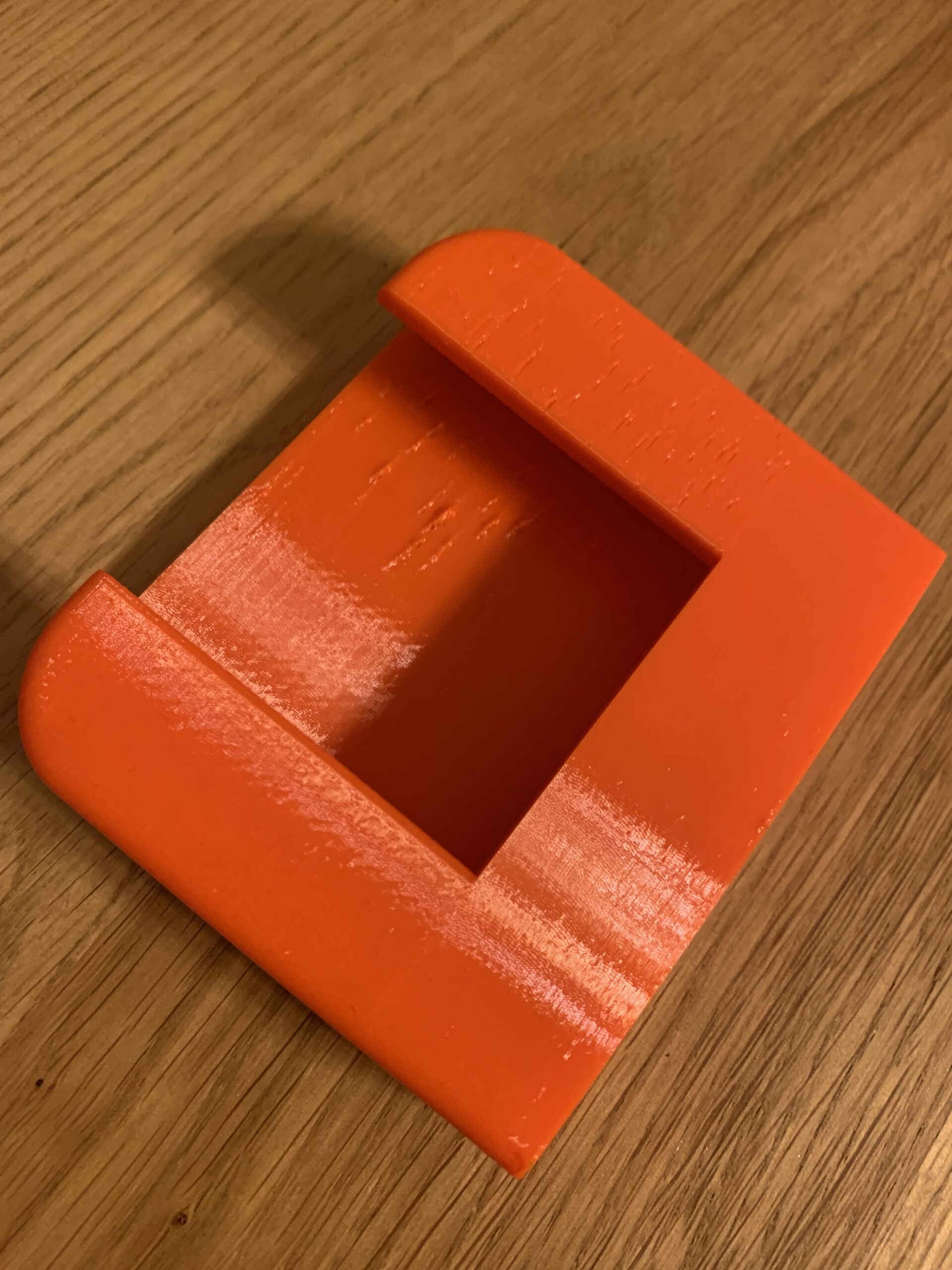

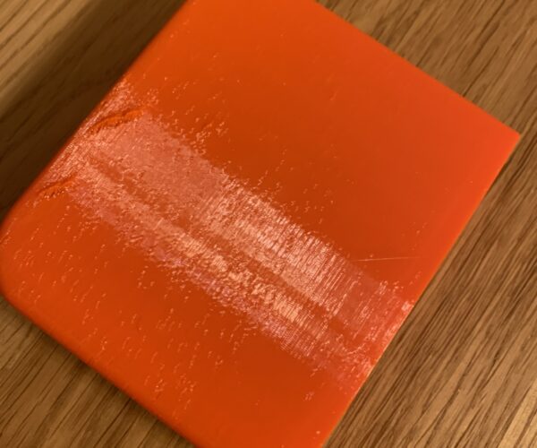

I currently struggle with severe issues with my prints: pockmarks all over the print, but sometimes only on one half of the print (see picture). I tried various settings (prusa suggests reducing speed) and filaments, the posted print was done with the following setup:
- 0.2mm layer height, prusa slicer with prusament petg settings
- New prusament PETG, dried before and while printing (60 degree celsius)
- Prusa enclosure with running filter
Does anyone have an idea what I need to change? (nozzle change would be my next step) Any help greatly appreciated!
Thanks a lot!

In case anyone comes across a similar issue: changed the nozzle and now it prints perfectly again.
