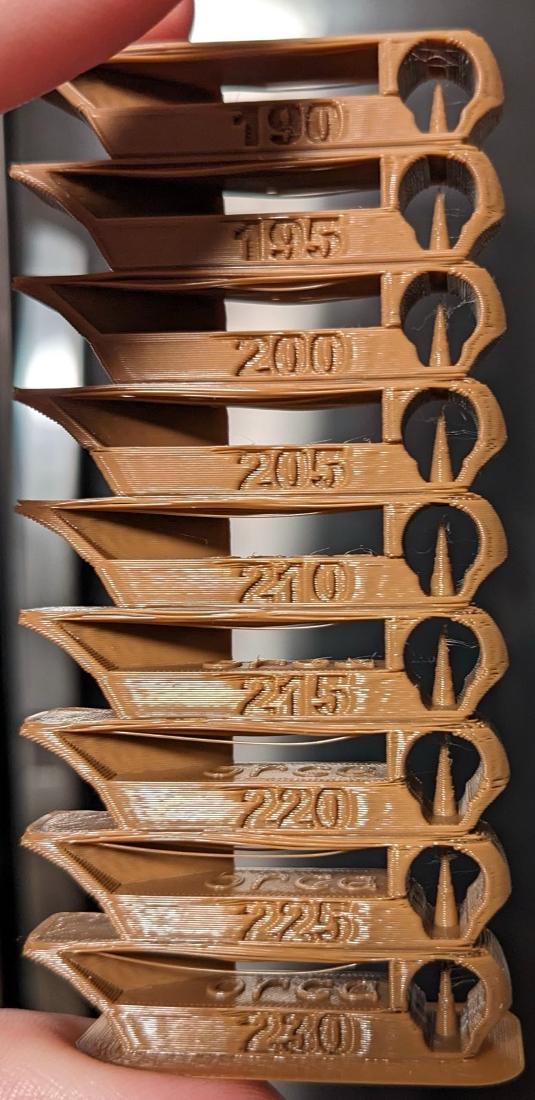

Hi! I have an Inland PLA+ filament that seems to string no matter the temperature.
I’ve attached the OrcaSlicer default temp tower:
Temp tower of the filament
It’s hard to tell in the picture, but it looks like 195*C has the least? I’m struggling to interpret the information, especially because the results are so similar. The manufacturer settings say between 205*C and 225*C, so I'm hesitant to go so low even for testing.

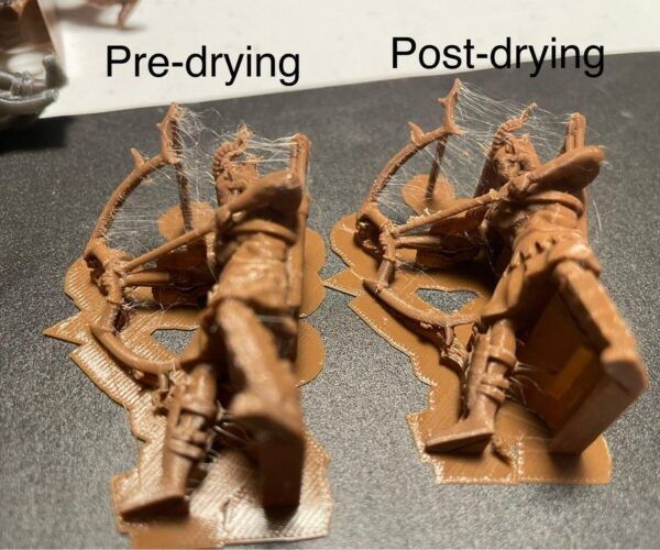

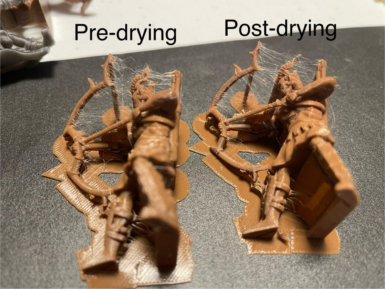

Here’s a picture of a miniature (from @VirtuallyJason https://www.printables.com/model/165196-gloomhaven-monster-inox-archer) printed at 210 degrees using a .25nozzle and .07mm layers with the left from before I dried it for 8 hours at 100*F (37*C) and the right is after. As you can see, there's very little difference, if any.
Example of stringing from print--one before drying and the other after
I can attach the 3mf if that’ll help. I left all speed settings on default. These particular prints were done with IS, but the results are very similar without IS.
I really just am trying to figure out if this is considered a "normal" amount of stringing, or if I should be doing more to tune my settings and reduce it. If I should tune the speeds, what should I be looking at?

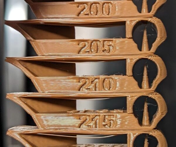

I haven't printed much with a .25 mm nozzle, or at all with inland filament, but that does not look like a normal amount of stringing to me (on the miniature that is, not the temp tower. the tower looks a bit stringy but okay).
Someone else might know more about how to fix the problem, but have you tried the 'generic pla' preset in prusa slicer to get a baseline?

The bridges on your tower look quite bad at all temperatures - perhaps there's an issue with part cooling, i.e. you need more of it? Have you tried setting the part cooling fan to be always on at 100%? Is the fan clean and working properly?

This is not normal for me. I've printed plenty with the 0.25 nozzle, and this is several times as much stringing even compared to when I print with PETG. I'm sorry I can't help with any possible solutions or sources of the issue though, other than perhaps the filament (I've used add:north and Prusament to great success).

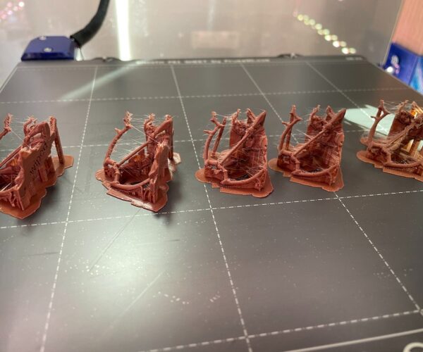

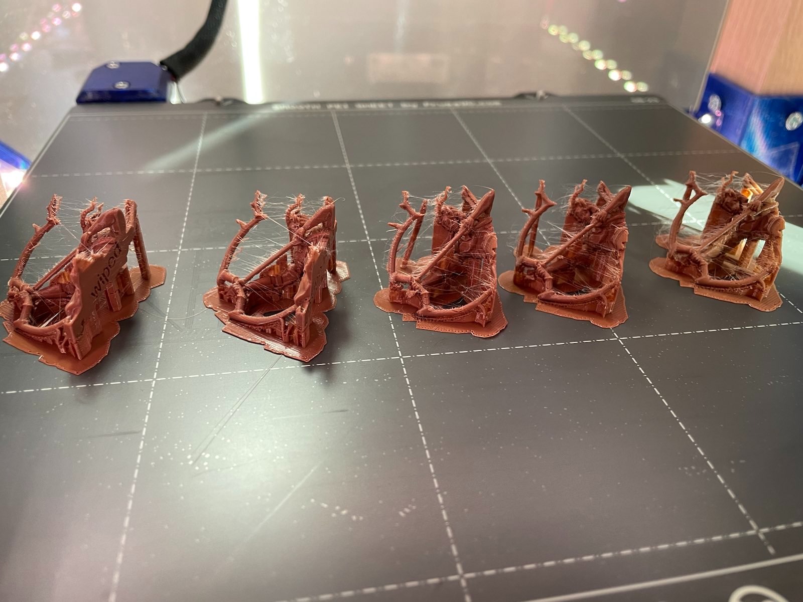

I've since been experimenting with different retraction settings and I'm seeing basically no improvement. Here are my most recent attempts:
I kept the temperature at 210*C for all of these, but I did vary the retraction length or speed (not both at once in these prints). I found that the wiping on retraction was set to "false" by default, so the very first print I turned it on and it did appear to make a difference, so I left it on for the other prints.
I can try playing more with the temperatures. Maybe the temperature is mis-calibrated.

After some tinkering I managed to dramatically reduce stringing by using the silicone sock. I have read very mixed opinions on the sock but it seems to work for me. So I am back to printing with stock settings (PLA at 225C) and I do not need to mess with retraction or other settings. This applies to the 0.4mm nozzle, I will try 0.25mm eventually (i have enough painting backlog already...). Of course, YMMV.
I am using the original sock from Prusa, others might work and might be significantly cheaper to get, depending where you live. When you fit it, remember to tell it to the printer in the settings.
Another slicer setting which seemed to help me, was Complete individual objects - each model is printed separatelly, reducing the head travel and thus stringing. You just need to position the models carefully (front to back) to avoid collision. For some models, I also had to adjust the clearance value in the slicer to exceed size of the model (looks like a safety feature, so make sure you have enough space between the models).
