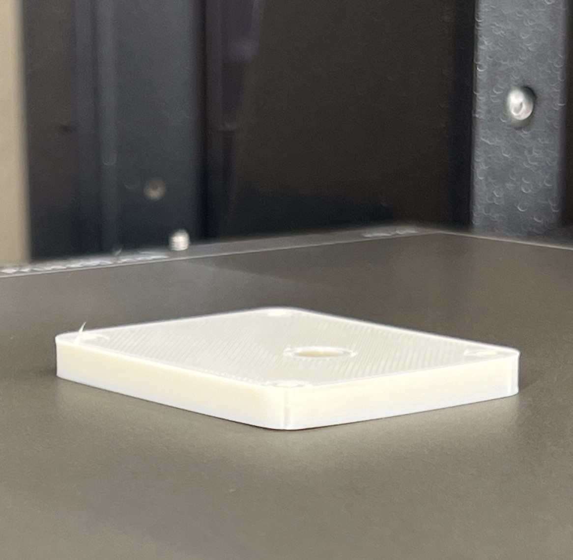

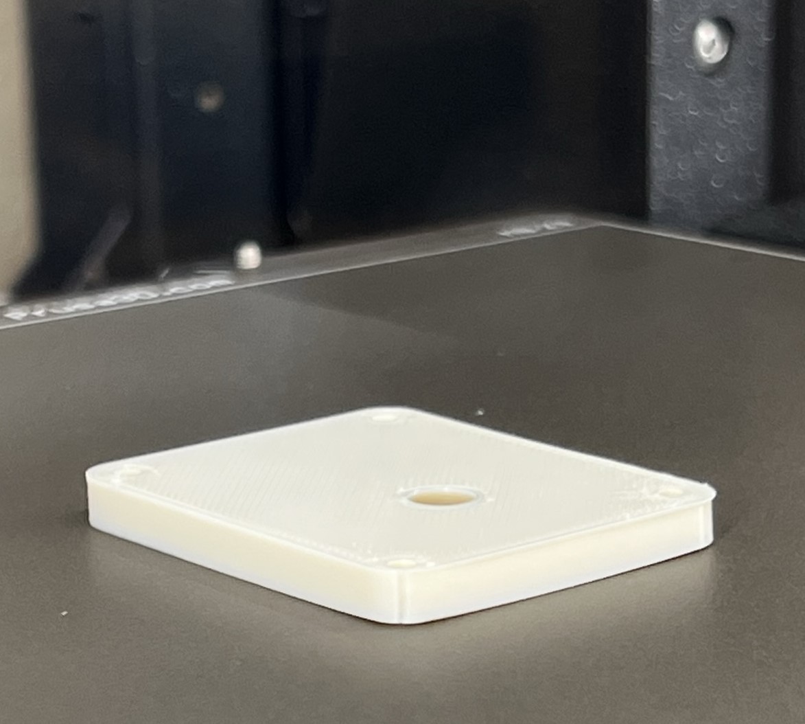

I did another test yesterday with and without shroud:
I think the result speaks for itself 🙂
Testmodel here: https://www.printables.com/de/model/568748-asa-warping-test-for-mk4

ScottW

Why is the second ("after") photo taken from a much higher angle?  With that high angle, it is difficult to see whether the corners separated from the bed or not.

because I was tired and did not pay attention 🙂 . . . I post then later two pictures from the same view 🙂

daytrader
(@daytrader)
This post was modified 1 year ago 2 times by daytrader
Posted : 02/09/2023 7:20 pm

Here are the results of my test of the shroud linked above.  Conditions for both tests:
  • Prusa Satin sheet, thoroughly cleaned before each print (Dawn dish soap & hot water, followed by 99% IPA).
  • Bare bed (no glue or other adhesive).
  • Prusa Enclosure (for both prints, temp started at ~35C and ended at ~38C)
  • Standard MK4 (non-IS) printer profile, 0.4 nozzle
  • Polylite ASA, dried several hours in dehydrator
  • Prusament ASA print profile (no changes)
  • No brims, internal or external
  • Photos taken within 2o seconds of each print's completion, from same distance and angle (as close as possible with handheld camera).
Without the shroud:  Minor lifting at both front corners; somewhat more on right-front corner (which is where the most heatbreak fan turbulence would be expected). No lifting of rear corners.
With the shroud:  Minor lifting at left front corner, but somewhat less than before adding shroud.  No lifting of right-front or rear corners.
Verdict:  The shroud did reduce the warping.
