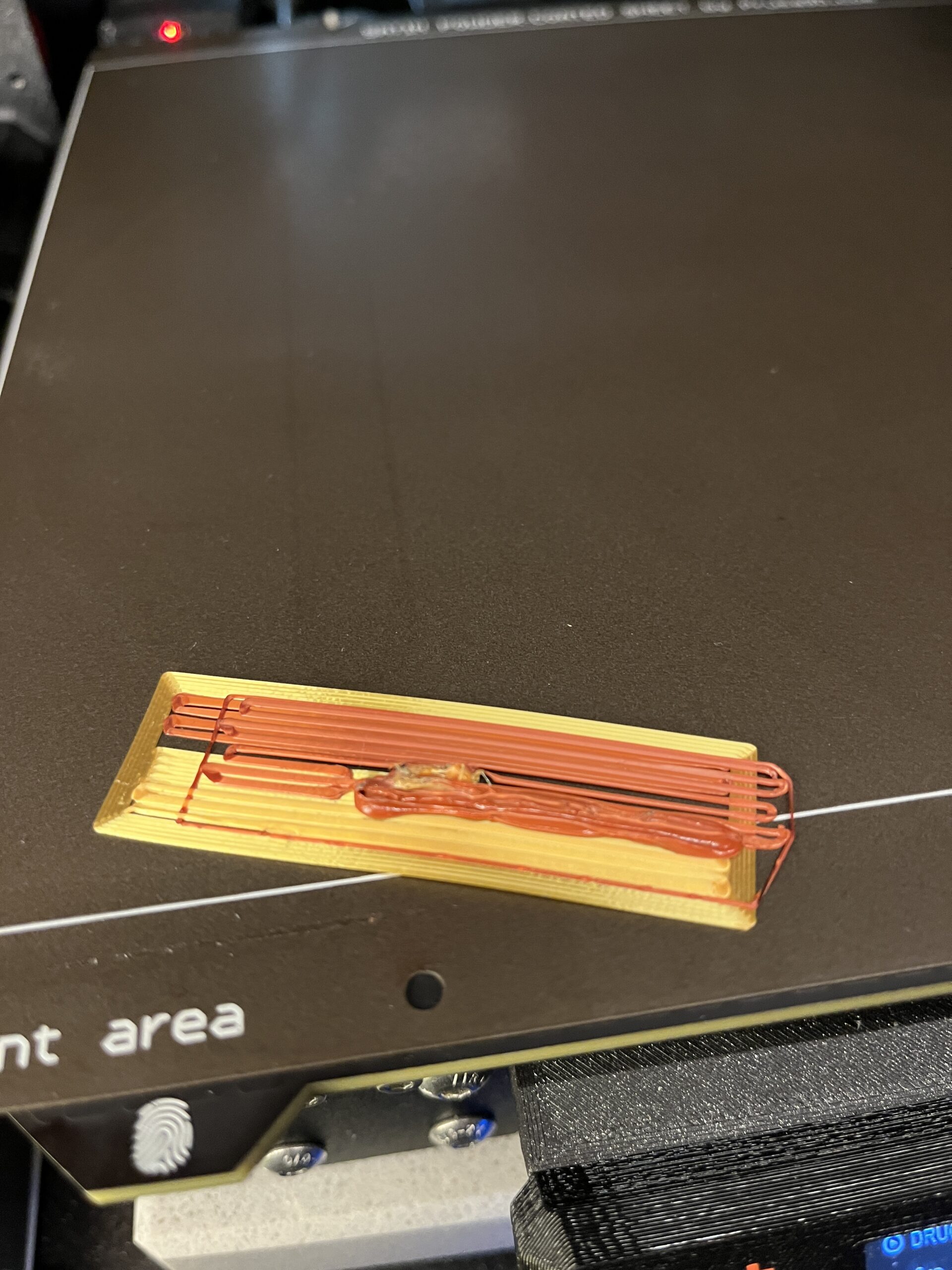

A couple of purge block looks like this:
Anyone have an idea what is happening here?
I have a hunch that the newly inserted cold filament is too cold and therefore the nextruder is grinding the filament and when it becomes liquid, there come far too much out for a second or so...

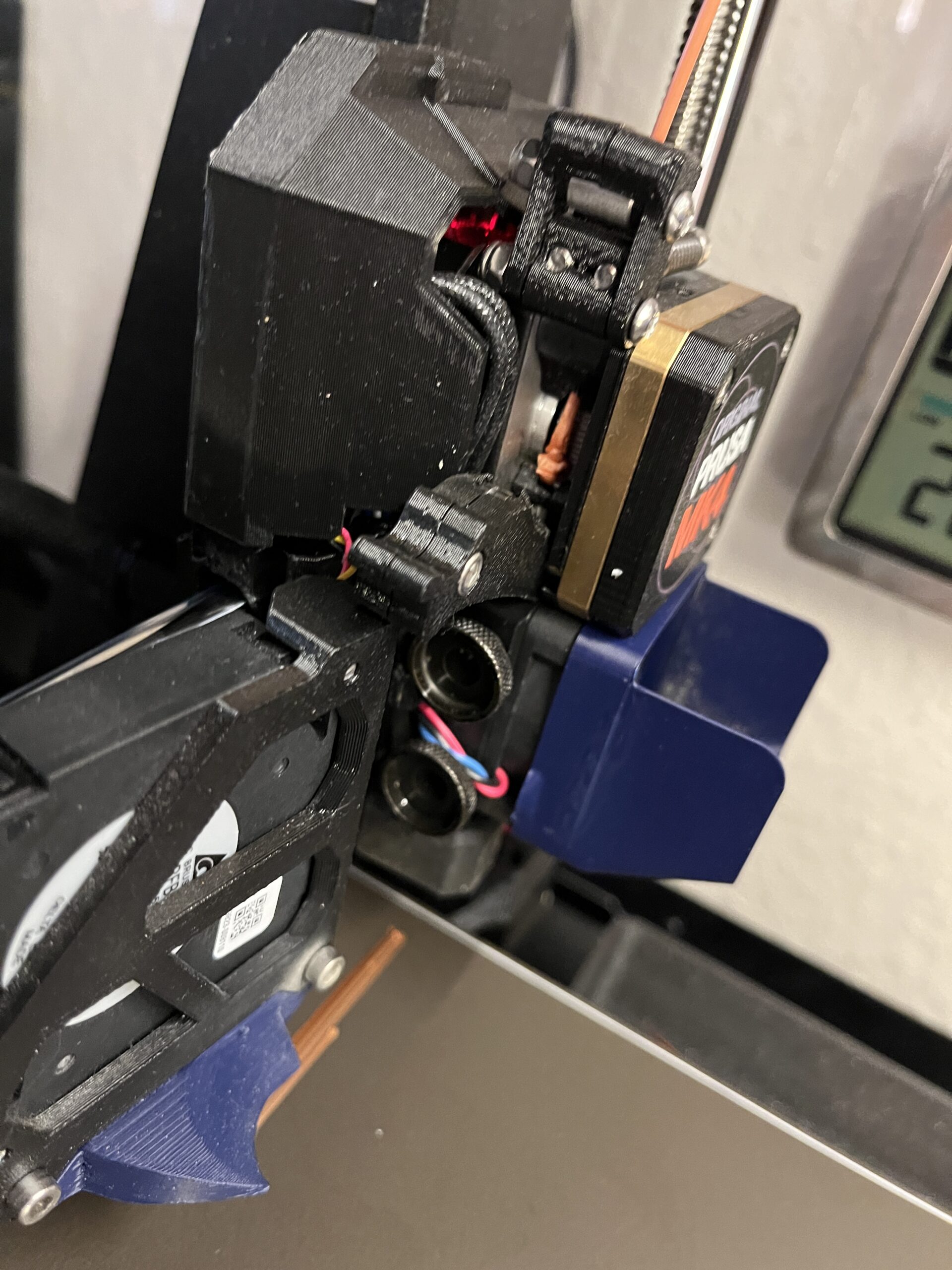

This time it went directly to the purge block without asking for new filament but still the same thing happend: The nextruder just started to grind the filament and nothing came out of the nozzle. This time I noted the extruder temperature and it was exactly 220 deg.C so my theory about cold filament is not correct (and this time, the temperature had been 220 for quite some time and a few cm of filament have been used).

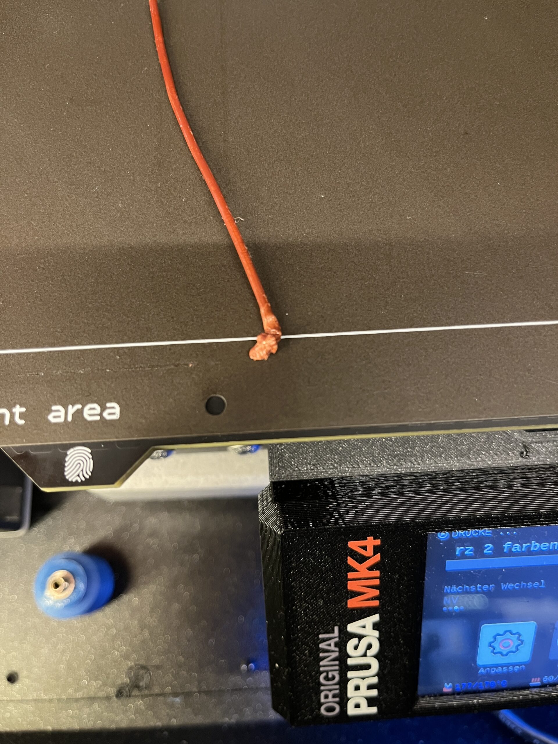

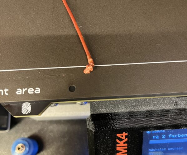

Since the nextruder was grinding the filament, I opened the door and, with the pliers, extracted the filament (which I was unable to get out the normal way). I broke off at the top, obviously, but the bottom end was quite unexpected:

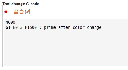

Forgot about the tool change G-code so I added it now. Tool change G-code (copied from "Color change G-code"):

Next try: First color change left a large blob on the purge tower.
During next color change, I removed the purge tower to avoid collisions but same result:
Where do that large amount of filament come from? Is it possible that the filament loading run twice? Well... that may be possible since I did as I saw in an online video to just copy the color change G-code to the Tool change section and that G-code contains a purge... I'm quite certain that the G-code in the video was more that "M600". Anyway, the filament change procedure includes enough purging...
Ok, I changed color change and tool change G-code to only "M600" and did a new go but still no luck, major blob in the purge tower...

I also noted that ordinary filament changes using the printers menu always work well but filament change from slicer/G-code leaves a blob at the tip of the filament so it quite frequently won't exit the nextruder (as seen in one of the pictures in previous post).
