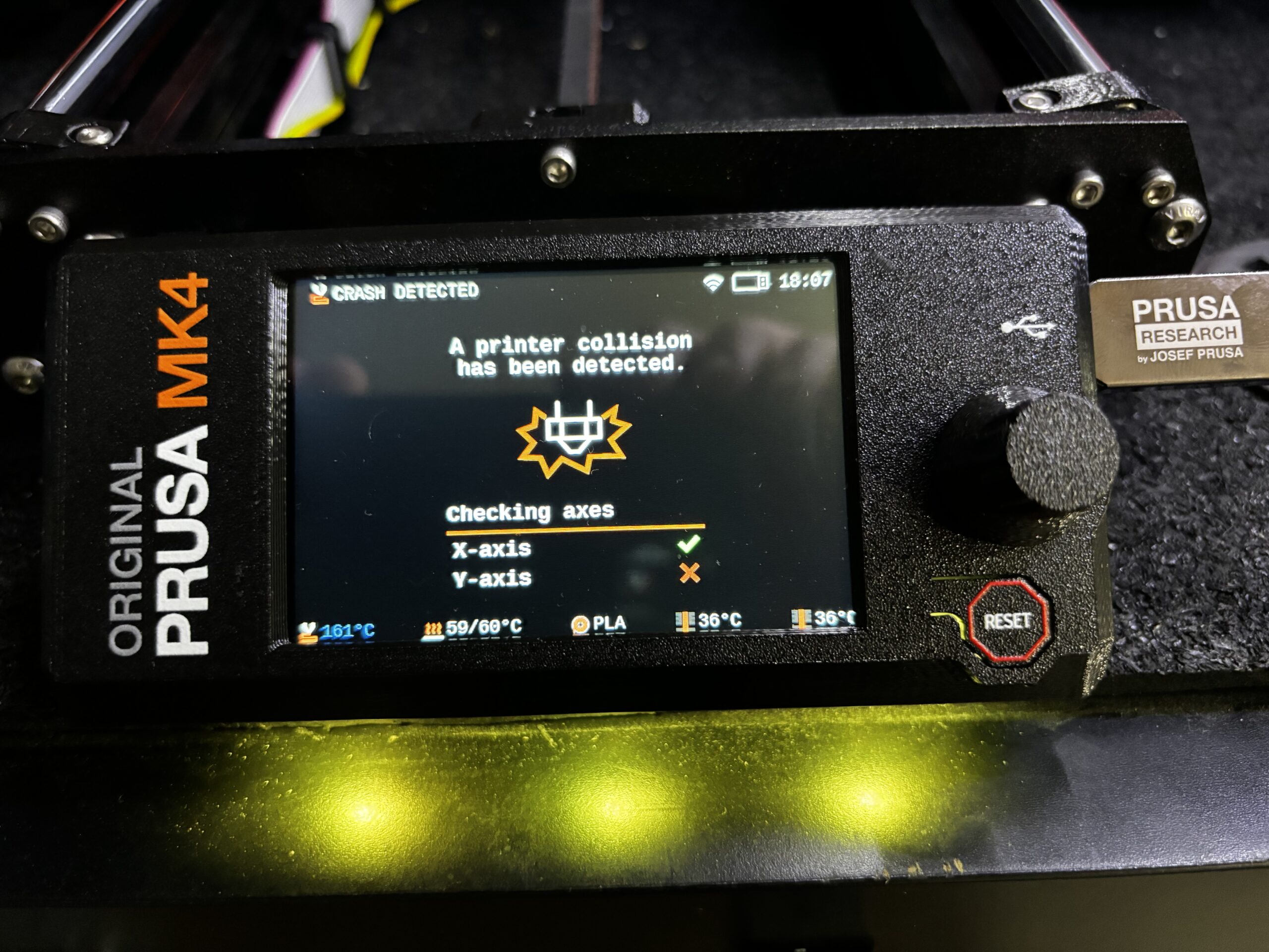

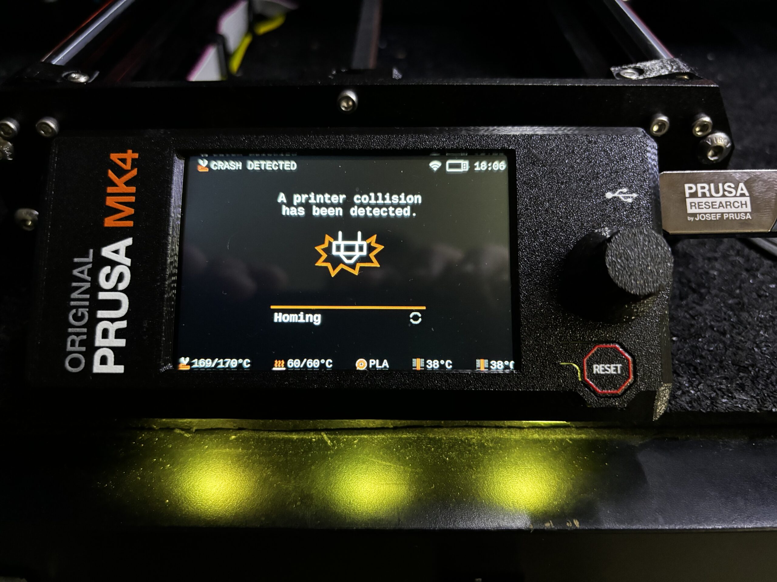

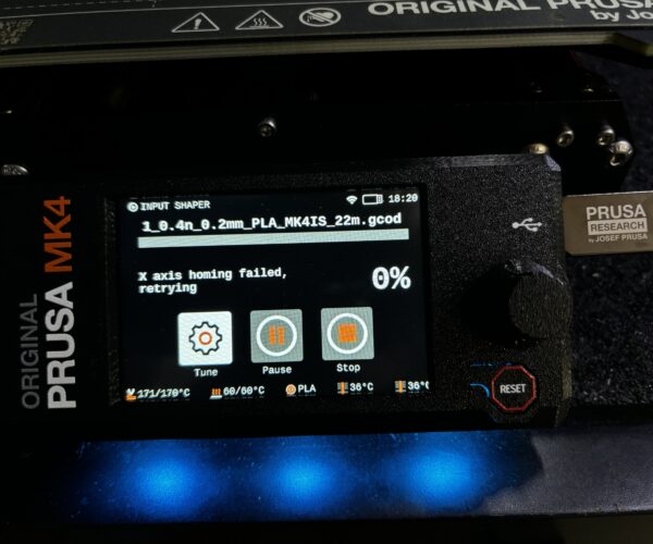

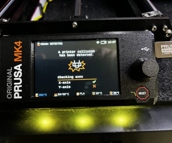

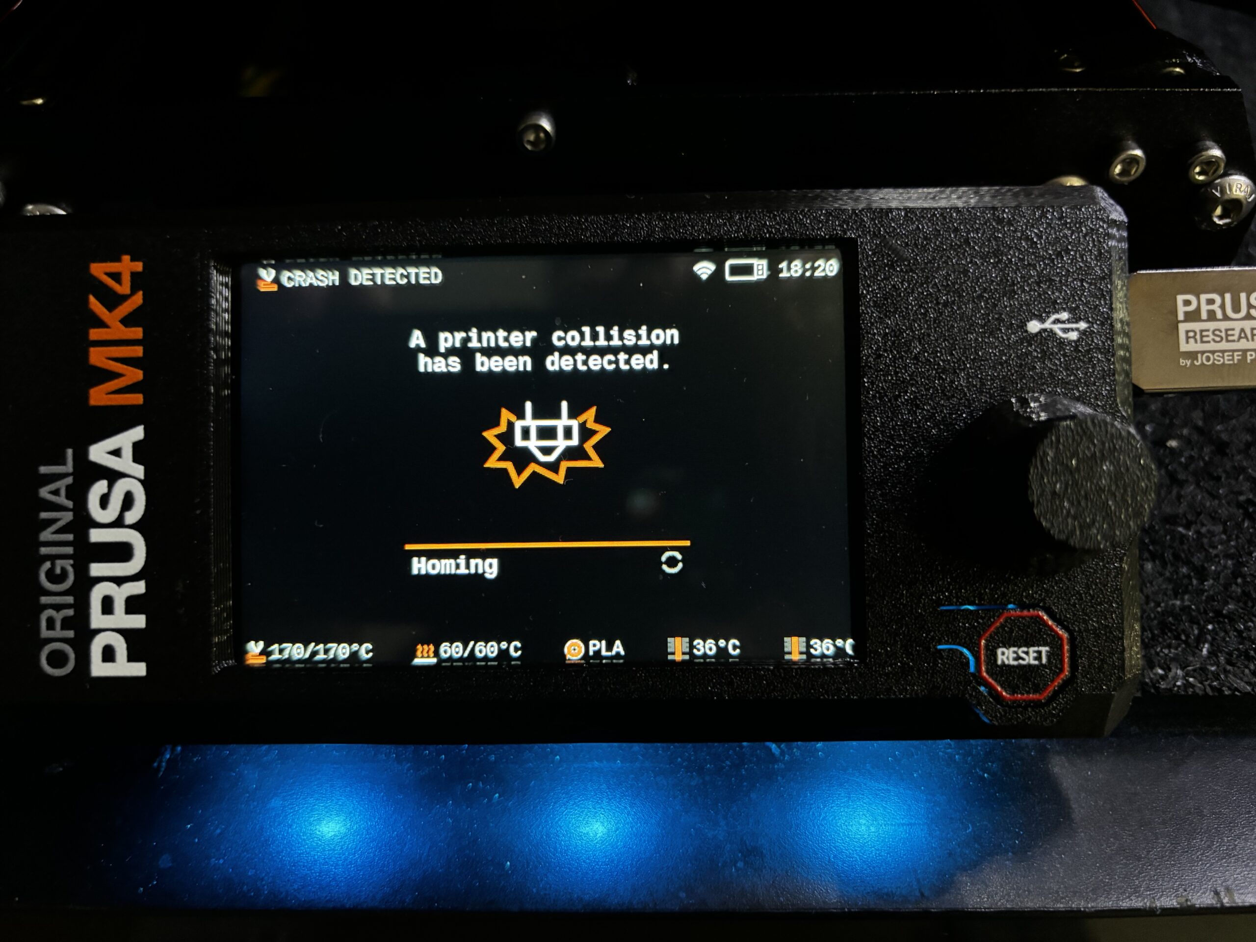

Had issues immediately after assembly, calibration failed, x homing. After hours of troubleshooting with Prusa, suddenly worked, could finally print, out of the blue, didn't change anything. Thought I was out of the woods. First print was successful.  But every other print, the x-axis homing fails, collision detected. I print a small part to test, flawless, works perfectly. I try to print again immediately after, same print, same settings, x-axis homing fails immediately. Shut down the printer, try again after a few hours, pattern repeats. first print works, the other can't home x and says it detects a collision.
I am baffled and so is Prusa, escalated to engineers/devs, waiting to hear back
Has anyone else had these issues?
Best Answer by paddys_pub:
After lots of troubleshooting with Prusa, we found out that it was the X-Idler pin, hand to take off the x-axis, re-set the pin and make sure it stays locked in by pulling tight on the belt before reassembly. no issues since!

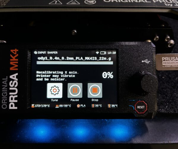

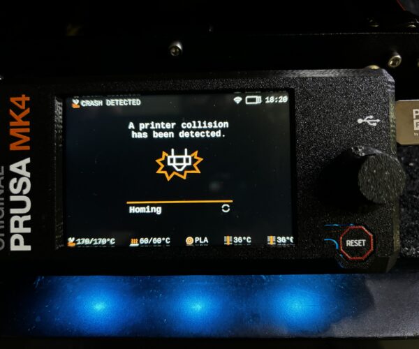

Adding photos for reference
