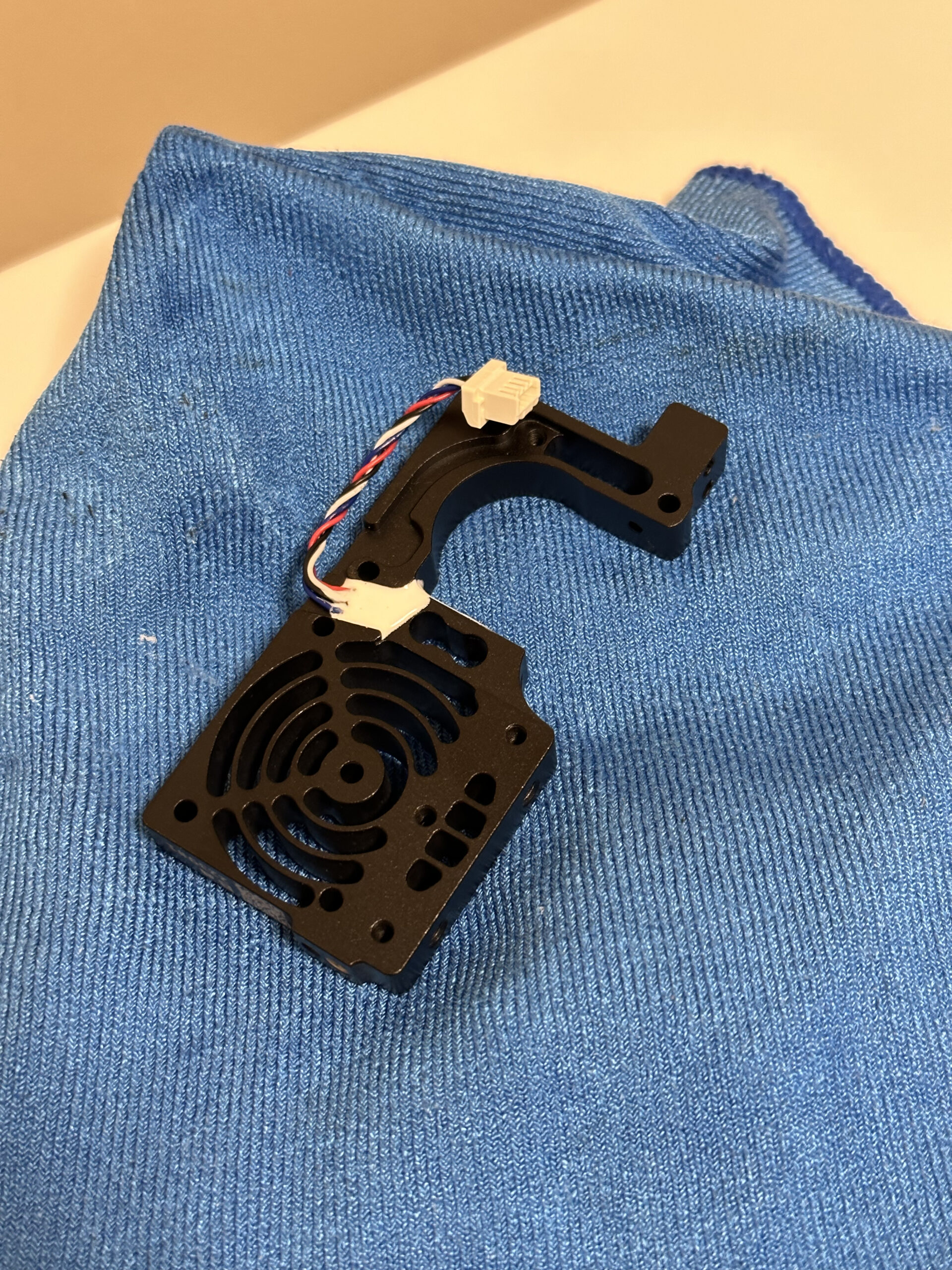

Mantas Velička
(@mantas-velicka)
RE: "Nozzle Cleaning Failed." Error
Problem solved 😄
Need change part: heatsink with loadcell
After change this part loadcell value fix and print agian perfect. Prusa service send me new part and now everyting perfect.
Posted : 26/08/2023 8:03 am
