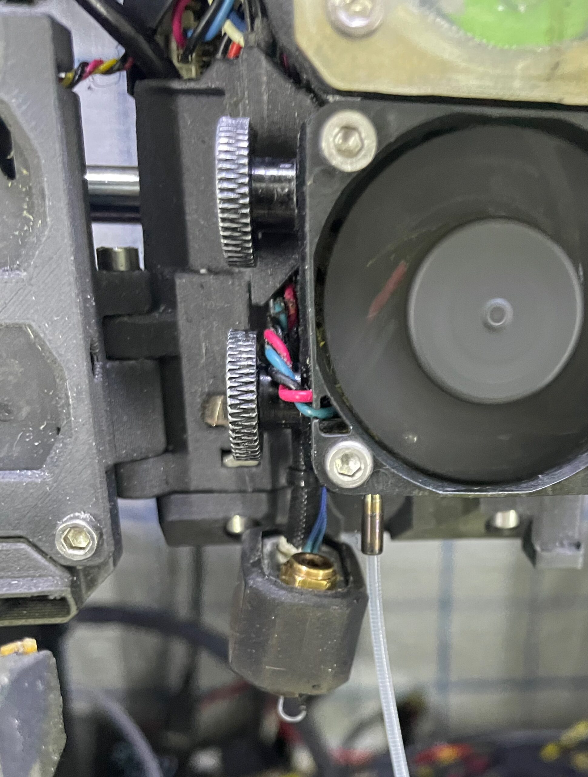

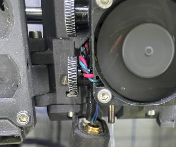

Just a heads up to those using the MK4 Nextruder V6 Nozzle adapter.  I have had a recently purchased one come apart between the threaded heater block insert and the steel feeding tube (image below).  The tube pressed out about 1/2 way through a 7 hour print.  I was running on Input Shaper mode, and I guess it does not have crash detection which compounded the problem, pushing  the separated heater block onto the X axis plastic/cooling fan, causing the heater block to melt into that structure.
Specifics:  0.25mm brass nozzle, PETG running at 235C.  Failed after about 5 hours of printing.  I can heat up the block and push the steel tube (cold) back in, which does not seem right.

this happens to me already twice, with 0.25mm E3d V6 nozzle
The first time when starting a PA-CF print at the first layer, the filament has pushed the brass part out of the tube (@285°C) It scratches doen the new PA steel sheet until it stops due to hotend cable issue. It also broke the thermistor and heater due to brocken cables.
Then claimed at Prusa and got the Adapter, Thermister, heater and heater block replaced (not the PA sheet)
Now I printed Prusament PC-CF in 275°C and the same happens with the new V6 Nozzle Adapter, the brass part was pushed off the tube broke heater cables and scrtched a powder coated steel sheet...
The brass part was absolutely clean pushed off the tube and could be easily pushed again onto the tube again.
I don´t know how it is manufactured, is the tube only pressed into the brass part but the hole was too big or was the brass part clamped onto the tube by using a hydraulic fitting press?
Because of the adapter was already broken I took it to an collegue who has a hydraulic workshop and we pressed the brass part again onto the tube.
Now the adapter does no longer be pushed of is still watertight. I tried it at 290°C  with PA-CF and loading to nozzle a few times.

I ended up finding an alternative supplier to Prusa on Amazon with a swaged extruder tube, I believe the seller on Amazon is FYSETC.  I am running a pair of these and have not had the extruder pushout issue since (about a year now).  The Prusa design relying entirely on press-fit force is not sufficient for smaller nozzle diameters, too much pressure.
