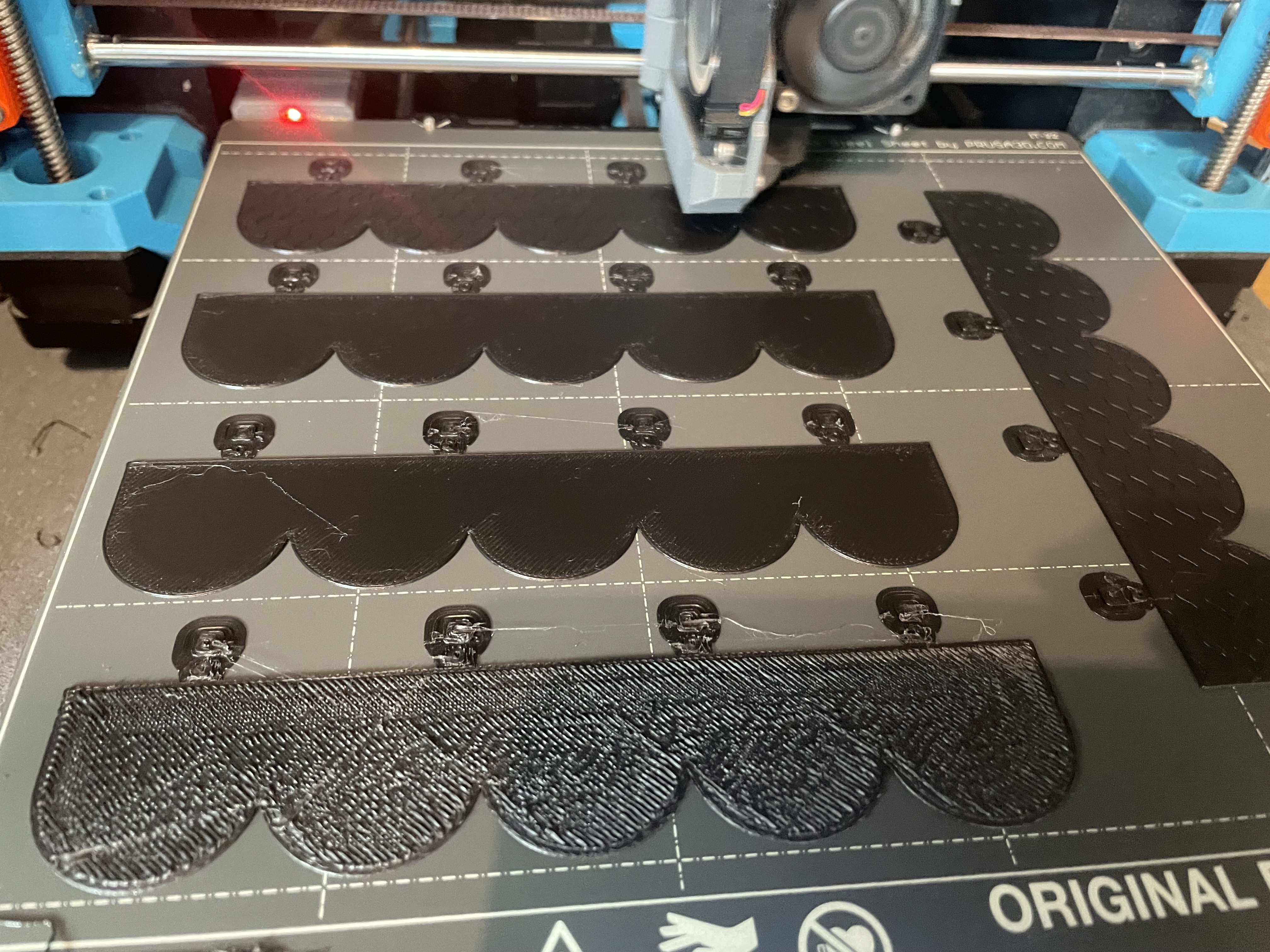

I have no idea how to explain this. But no matter how many times I slice this print, that one in the front seems to have some sort of height issue. If I let it run, it will eventually cause a hard layer shift before it corrects.
RE: First layer height issues
If you notice the other piece that is oriented along y and comes down to the front area prints fine in that general region.
