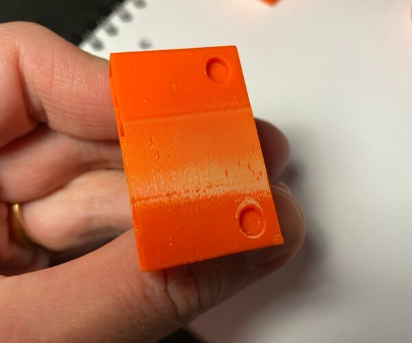

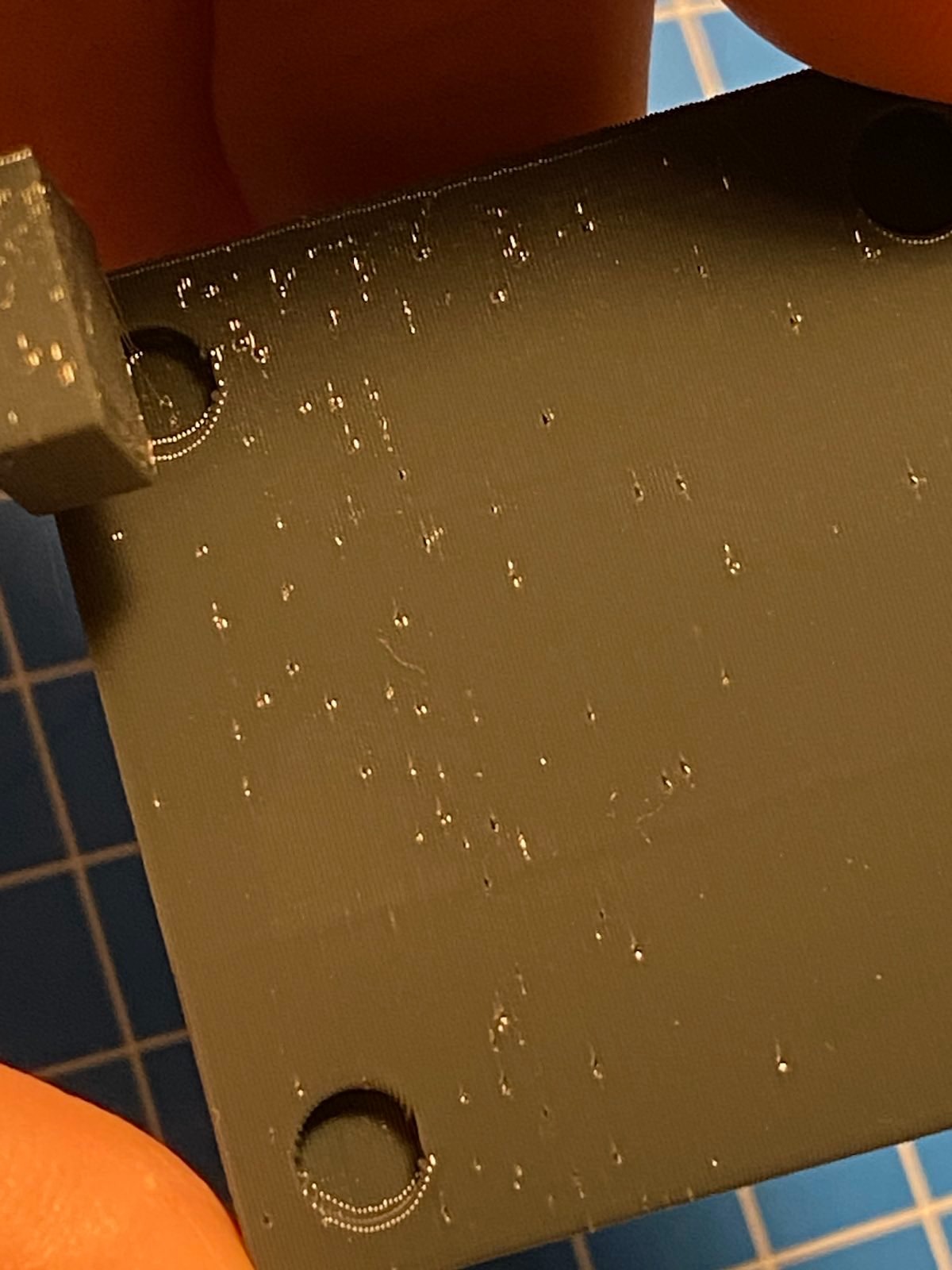

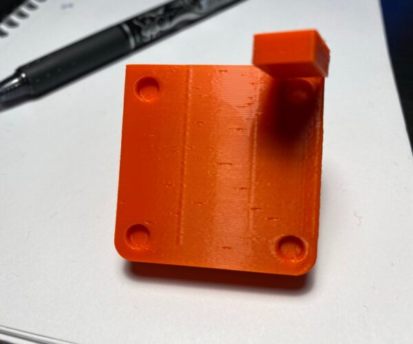

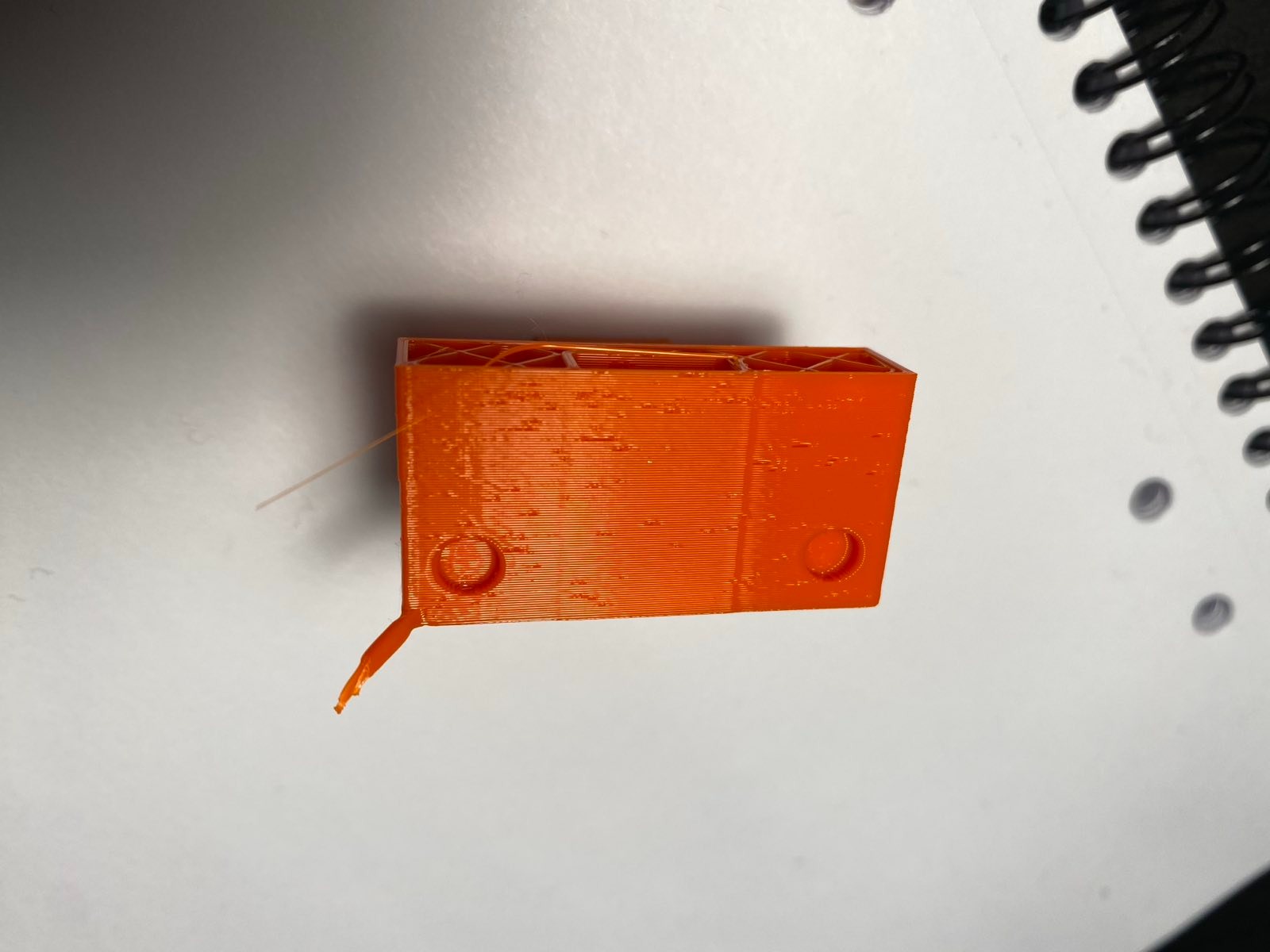

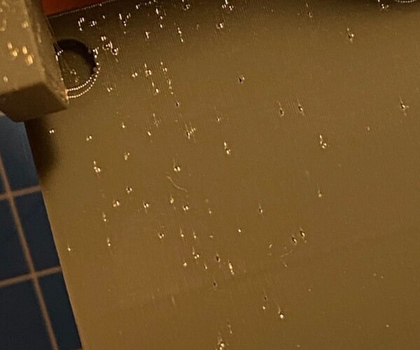

I am having an issue with small holes in my PETG prints, i have tried a lot of things but not found a solution to this problem. I have a almost new factory assembelesd MK4, using Prusa Slicer with standard settings, no mods, and i am using Prusament PETG. The following things has been tried and tested:
  1. Dried PETG, the same roll prints without any holes in my Prusa Mini+
  2. Seam, Seam is aligned and not random. This is not a seam issue
  3. Temperature of nozzle lowered to -10 and -20 degrees, no big effect.
  4. Retraction distance lowered from 0,8 to 0,3mm, no big effect(maybe slightly worse)
  5. Added cooling, fan set to max 80%(from 50%) and min.layer time to 40 seconds(from 20s).
I read a lot of people have had this issue also, but i cant a solution. PETG from the same filament roll prints without problems in my two Mini+ and MK3+.

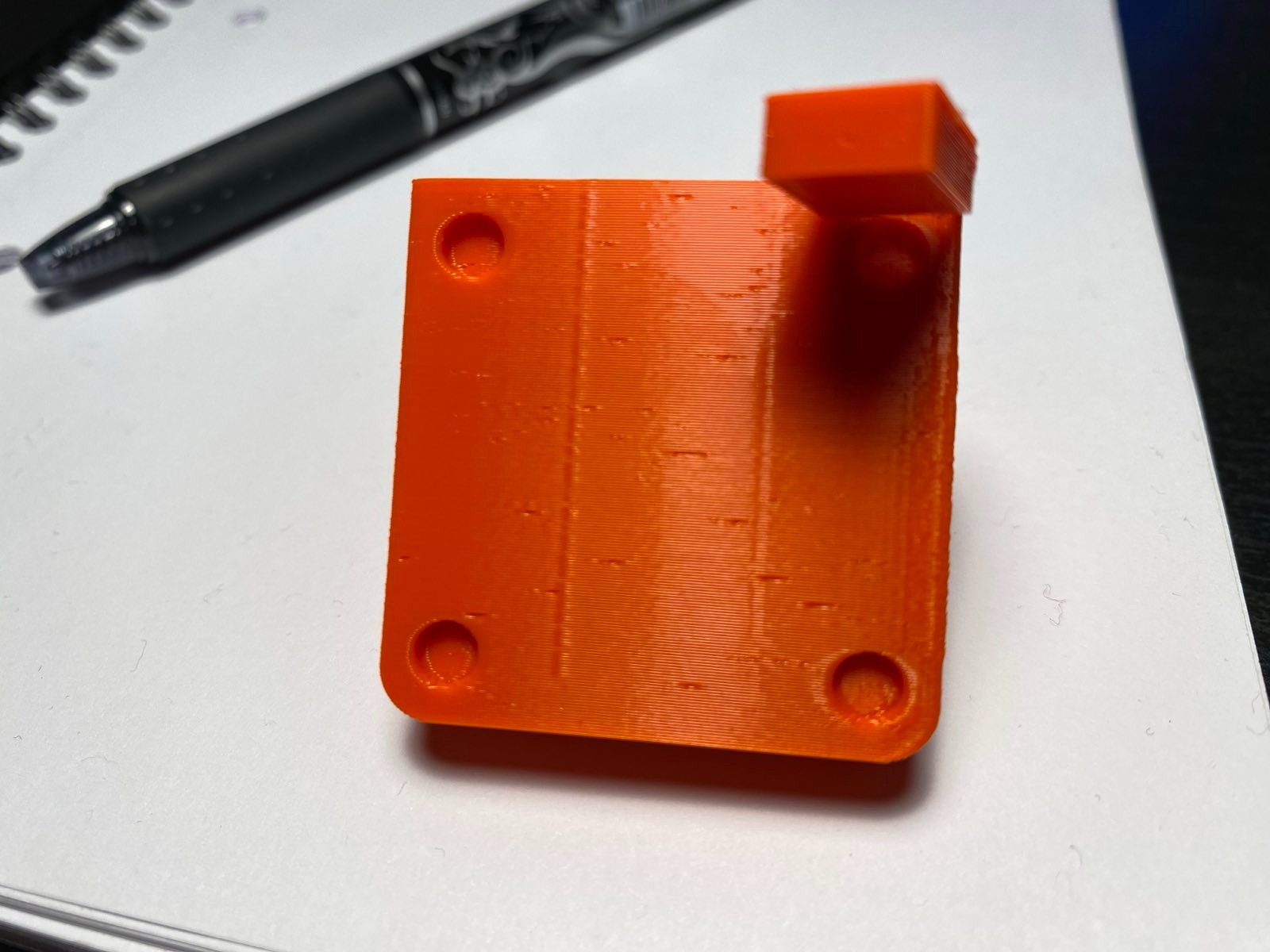

I tested to print the exactly same file, but with 4 walls in stead of 2(on the left). This reduced the problem with about 90%. I have no ide why this helped though.

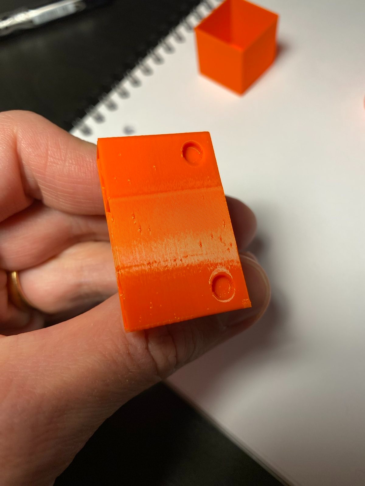

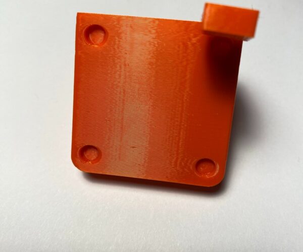

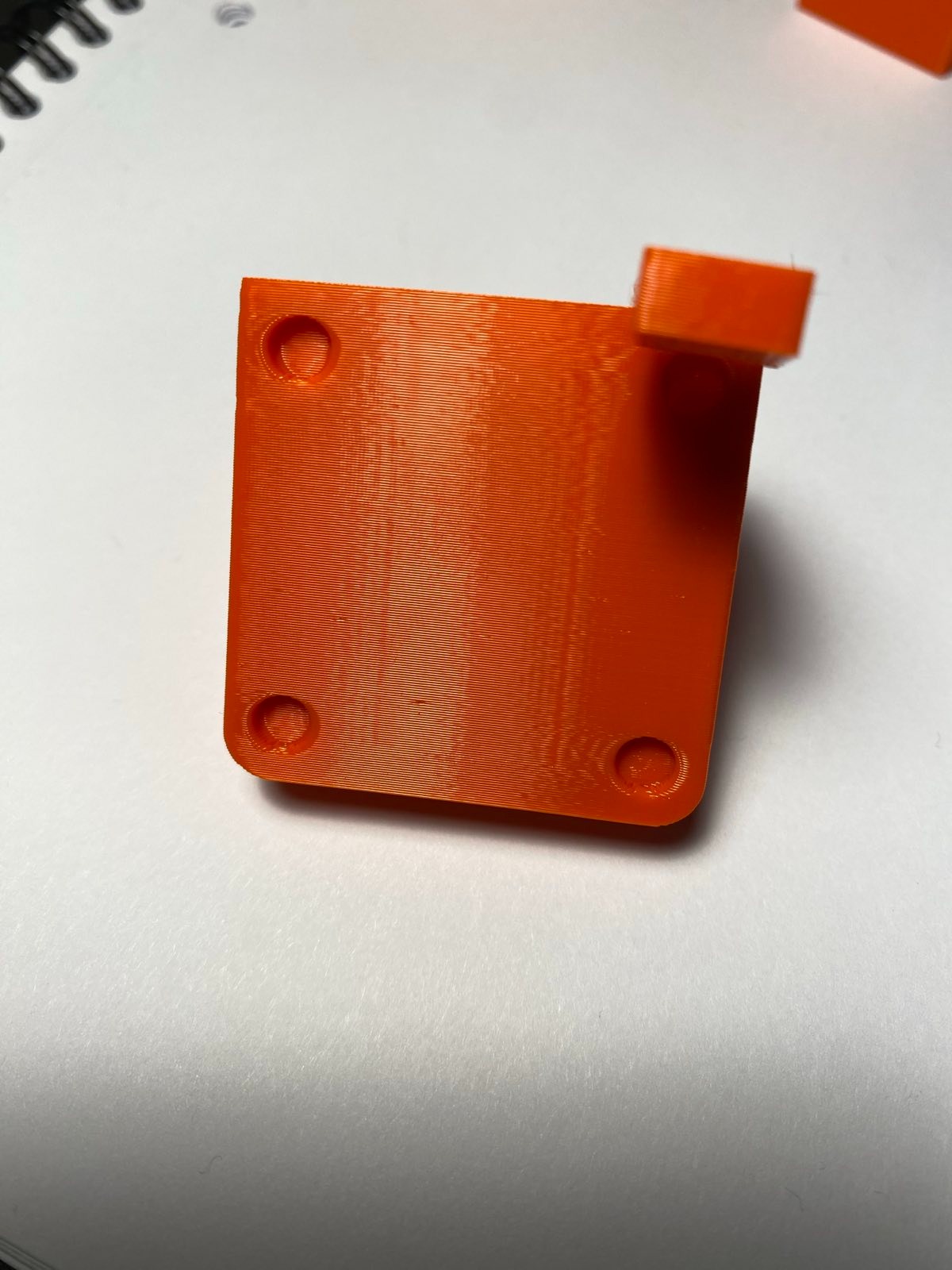

I contacted support, and they asked me to print a spiral vase g-code. It came out terrible, and i was told to dry the PETG and try again. I did this, and there was a big difference(after drying on the left).

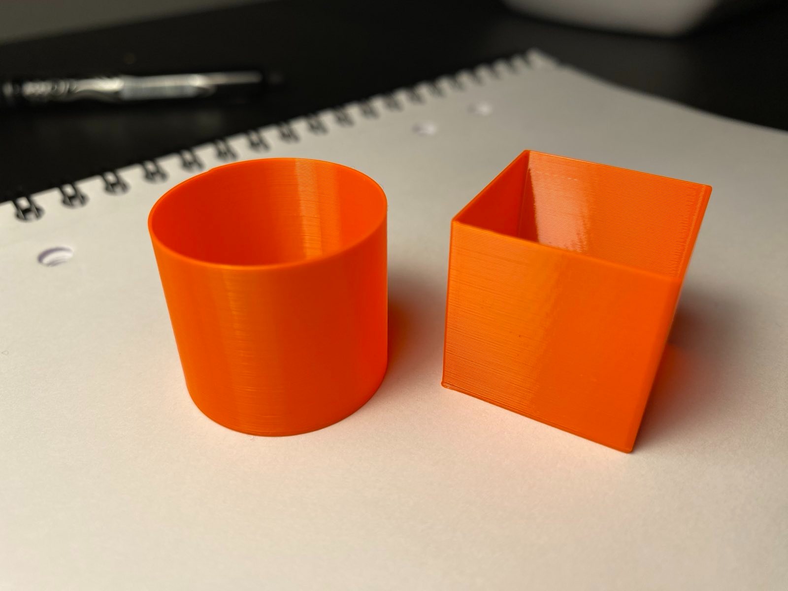

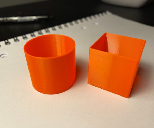

Its a strange, the cylinder and cube Prusa sent me print very nice, they are perfect. But when i print my other print, i get the gaps... Filament is dried, so it is probably something else.
