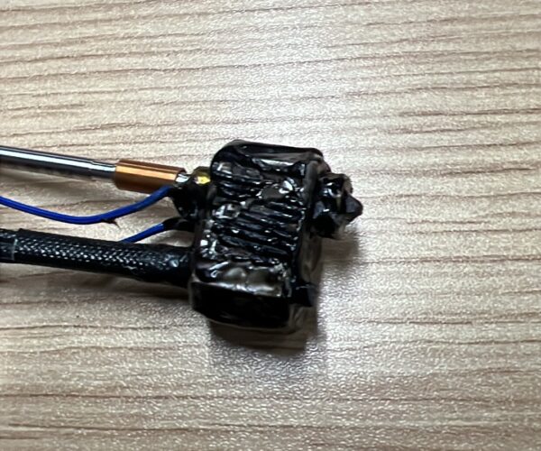

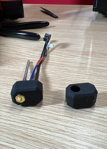

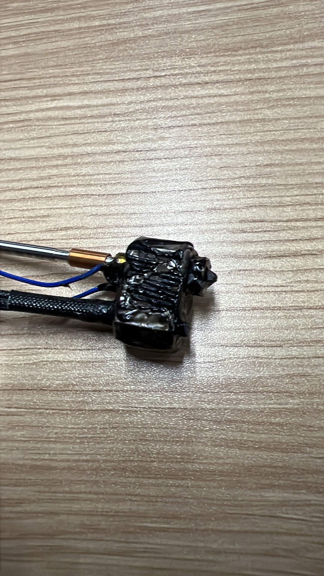

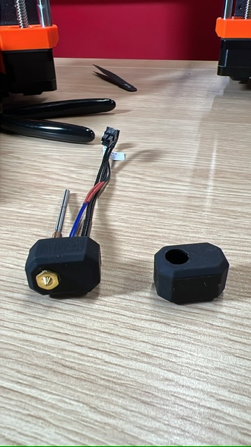

I got a violent blob on mk4 once. Heatgun and preheat of hot end to remove larger chunks of plastic. My blob consumed few wires and x-belt. The condition of hotend is on the video. I did not try to further clean  or repair it - smoke in the video comes from wires overheated by heat block with no air flow. After replacement of whole hot end, the printer keeps working with no issues.
I suspect a print job was started with parts on steel sheet.

Blob surgery:
Replacement part:
