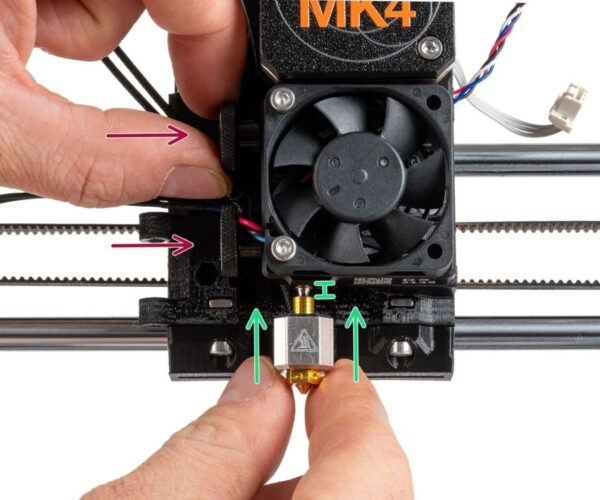

I have an MK4 that prints without a problem, but the z-axis test/calibration never goes through:
When I run it, it seems to be done correctly, but it always ends up with the red cross, with no error message.
I've checked the direction of the trapezoidal nut, as well as the positioning of the hotend, but everything seems fine.
But I get a calibration alert message every time I start up...
I don't understand ...

I'm in the same situation with testing failure of the Z-axis, despite following all suggestion on what to do: Nozzle insertion distance, "correct orientation of the trapezoidal nuts" - silly ! because there is no choice of direction !; sloosing screws ! etc
I think I simple will do as you : start printing.

Just bought a mk4s recently.. and have done all the tests.. i am in the same predicament: z axis  test fail.. tried the trapezoidal nuts several times, but what i see makes me wonder : it checks all other axles as well.. so.. wondering if its anything else failing.. when only reporting z axis?

I had the same problem - just finished my upgrade to mk4s.  This is how I fixed it.  From where the z axis test left off (with the extruder at the topmost z position) I went to control/move z axis and moved it toward the bed until it said zero - the nozzle was not touching the bed.  I then exited back to the home screen and shut off the printer.  With the printer off, I manually moved the threaded rods on the z motors equally ccw until the nozzle barely touched the bed.  Then, I turned the printer back on - the z axis position still at zero.  I could then re-run the z axis test, and it passed.
