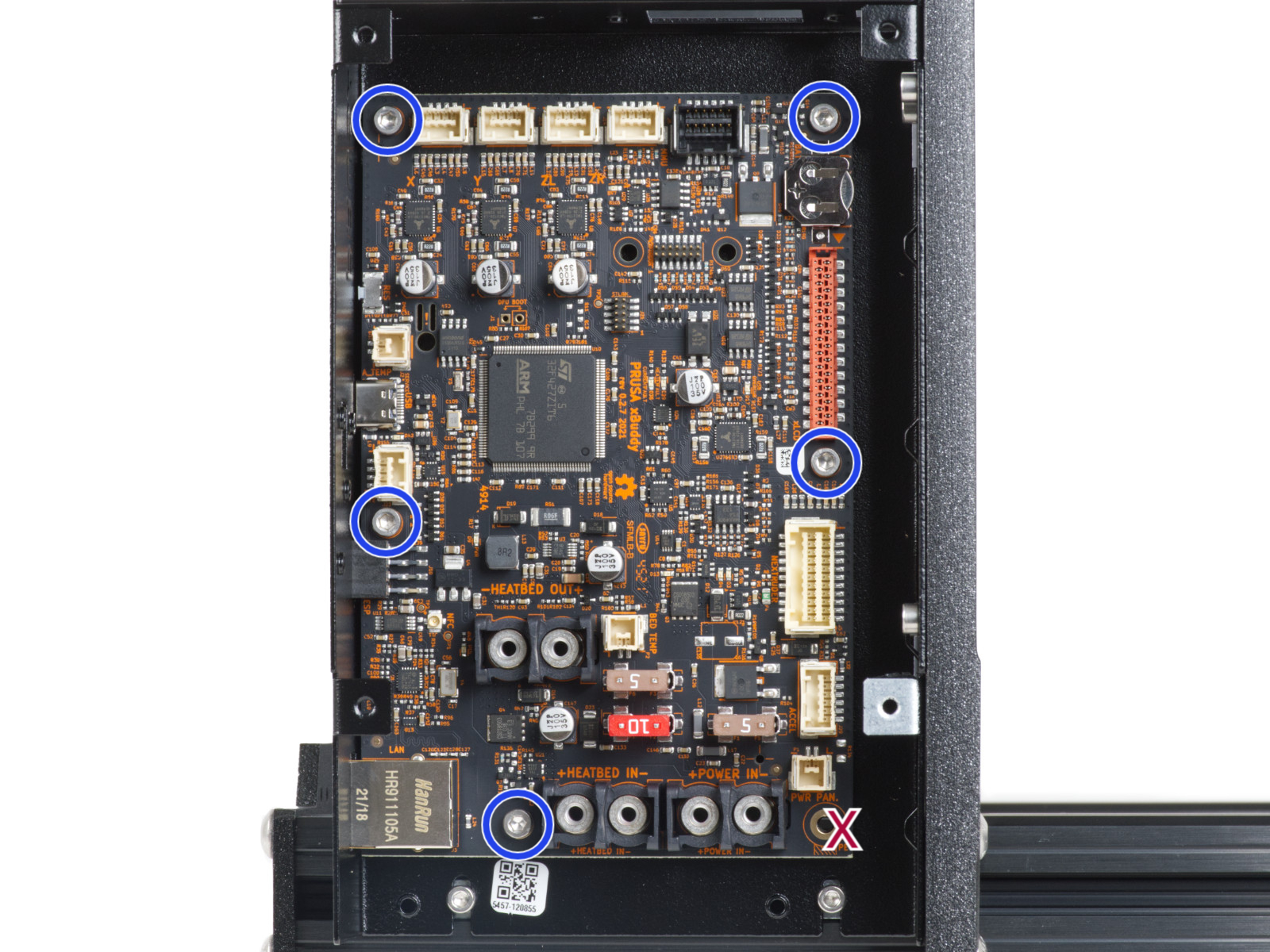

I've been assembling  the MK4 kit. When I got to the step that called for mounting the xbuddy circuit board into it's case I found that the holes in the board and the threaded inserts in the case didn't line up. So I couldn't attach the board to the caee.

Here are 4 pictures I sent to Prusa.
The circuit board is being held to the xbuddy box by one screw in these shots.

Looking at the pictures, i don't think there is anything wrong.
And you can use five M3x6mm screws to secure the board.

Nothing except that the holes don't line up. If I force them in, I will most certainly crack the board or damage something else in the process. Can I enlarge the holes a bit safely? I have a set of numbered drills.

Not really the holes are insulated ground to stop them shorting on screws there's no way yo tell how far the insulation goes

What if I substitute nylon screws in place of the steel ones?

Is the box itself tweaked? Maybe it came with a little twist in it or you tweaked it when you were attaching it to the frame. I would loosen the box screws a little and give it a little torque action to see if you can get it trued up. Then be extra careful when you re-tighten it up.

RE: XBuddy Board assembly issue
As I indicated, there is nothing wrong.
Just use the five metal screws provided by Prusa.
You don't have to worry that this will cause damage to the PCB.
It is made of epoxy and can handle a lot of forces.
Do NOT drill out the holes!
Do not use nylon screws!
(The PCB is earthed to the housing through the metal screws)

I was able to get 3 screws in the board. It seemed to be held in place ok so I've continued with the assembly. By now the board is covered with cables and zip ties.
