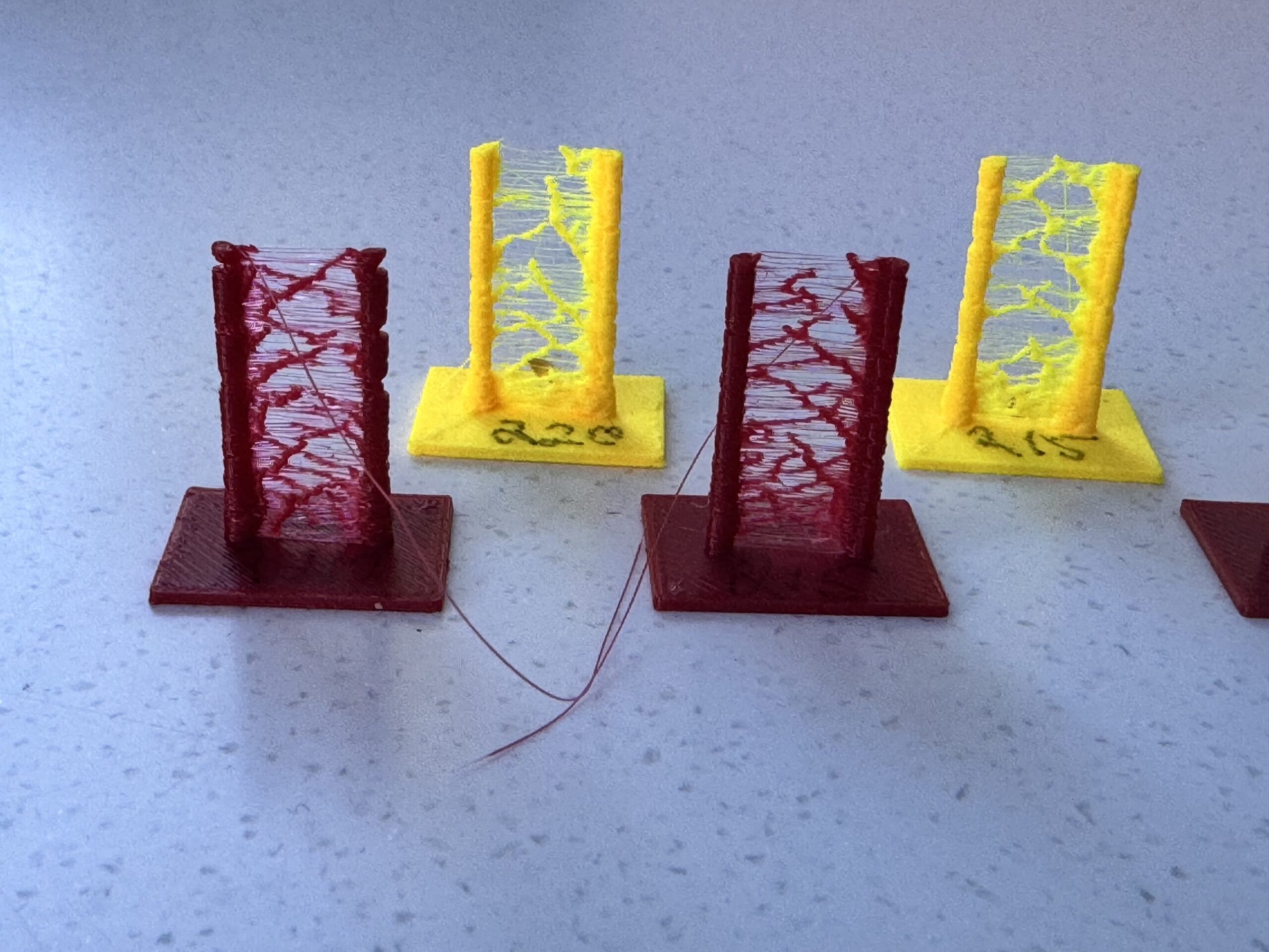

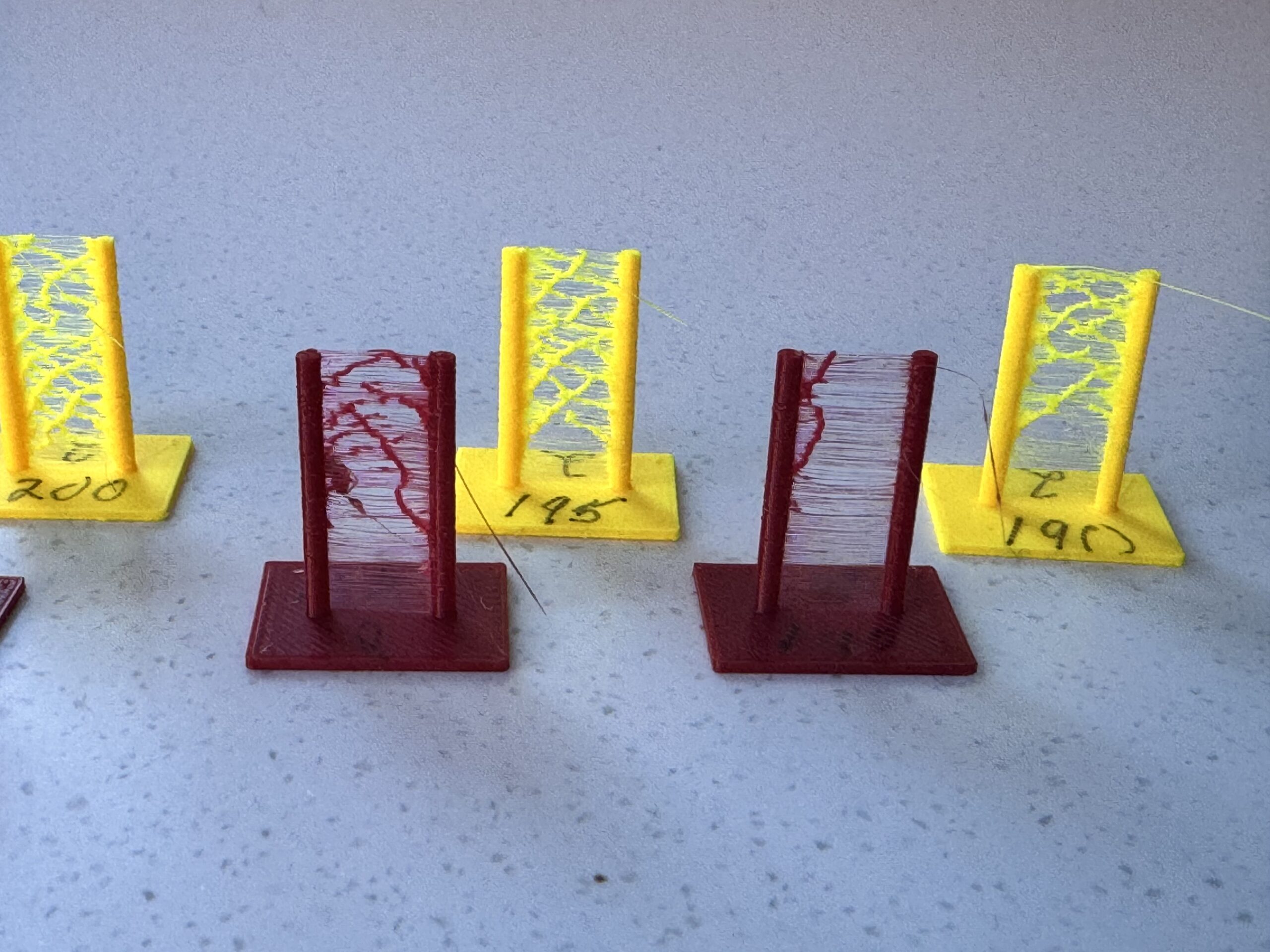

Richy C
(@richy-c)
RE: MK4 PLA Stringing
I spoke with support on this issue and they were very helpful.
I did a whole bunch of tests, using 2 different filaments - Prusament (Red) and Ziro (Yellow).  I did prints ranging from 190 to 220 degrees.
As you can see, there was no major different in quality.  They have kindly send me a new Hotend Thermistor.  I'll report back.
Posted : 10/11/2023 3:52 pm

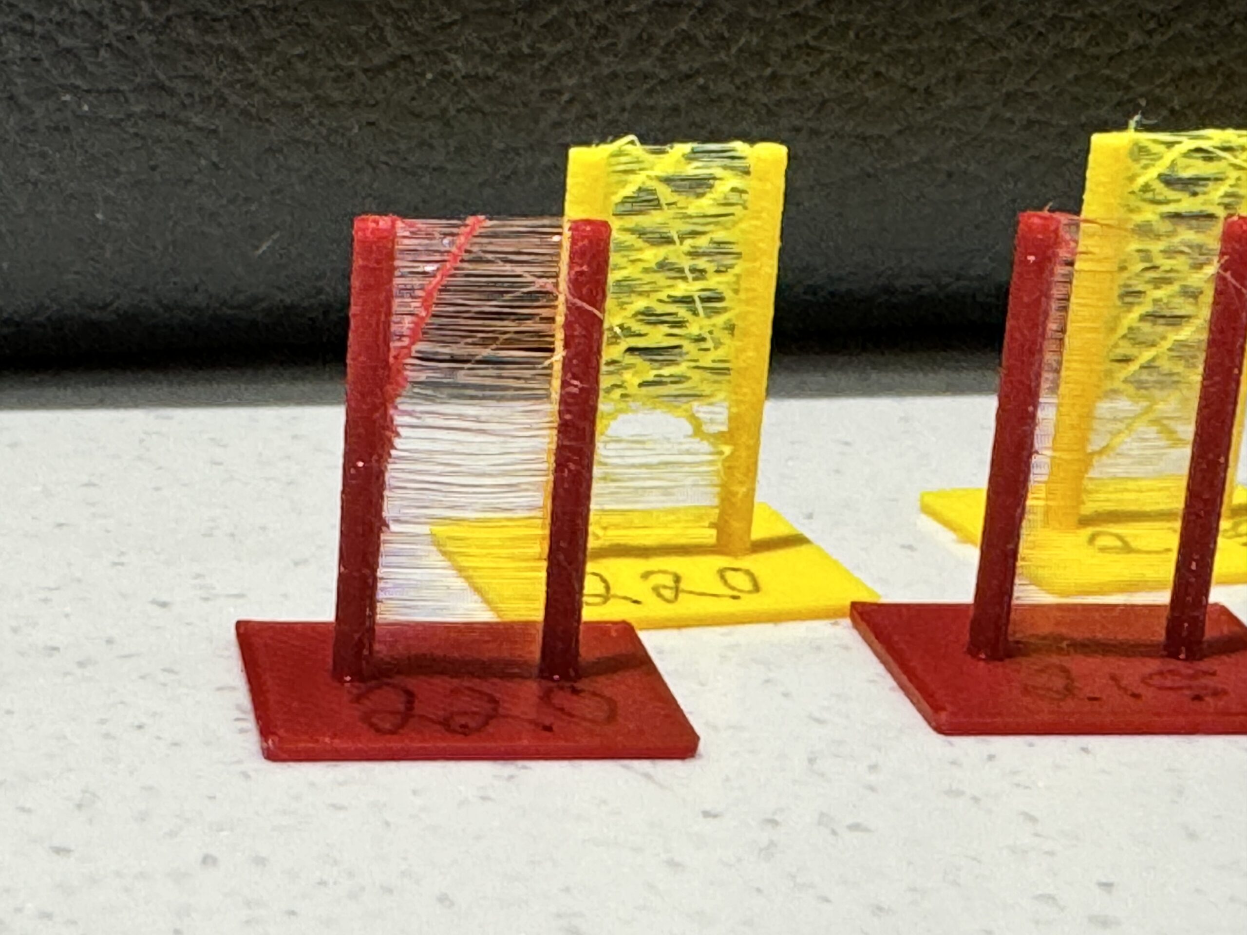

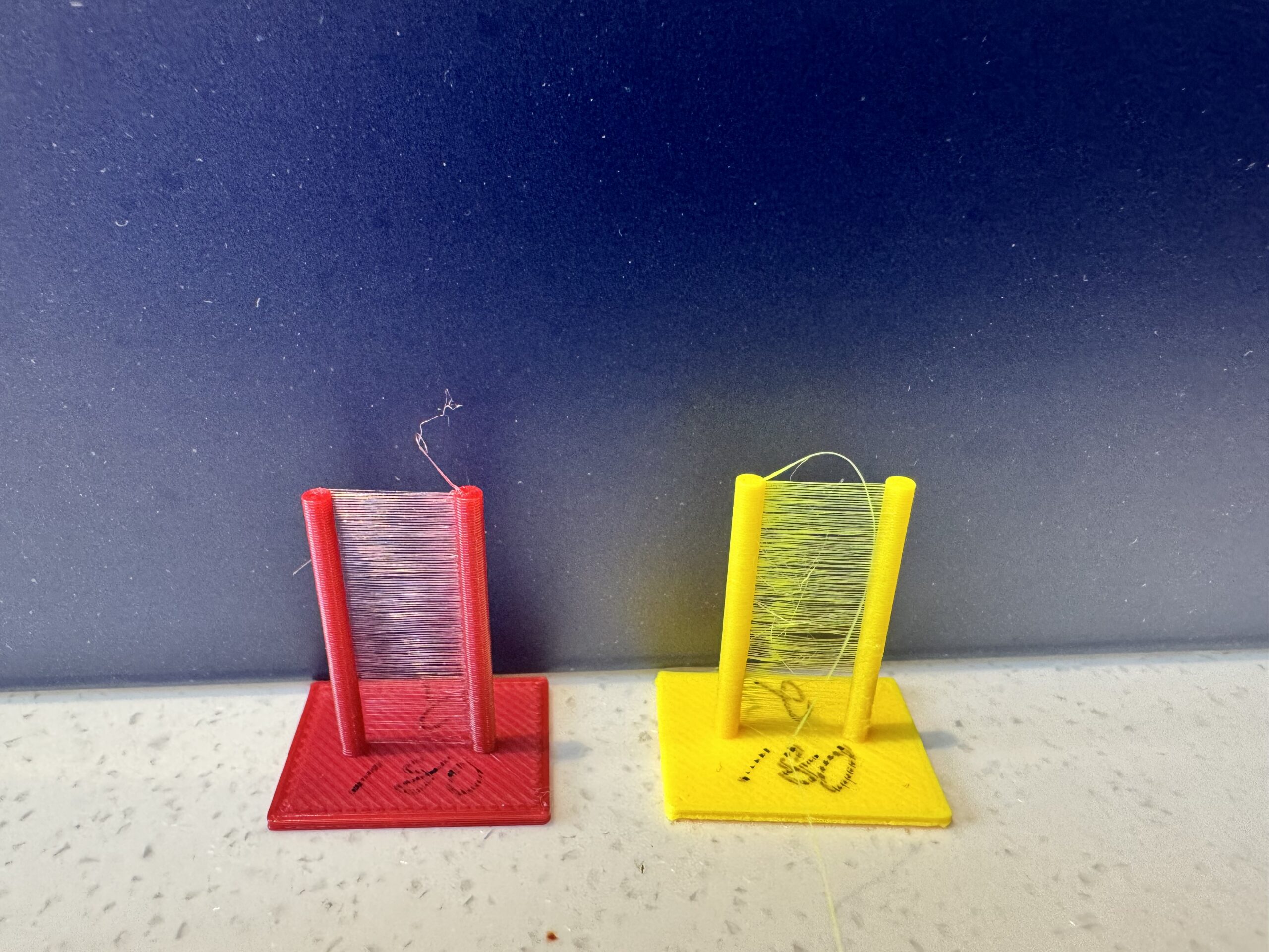

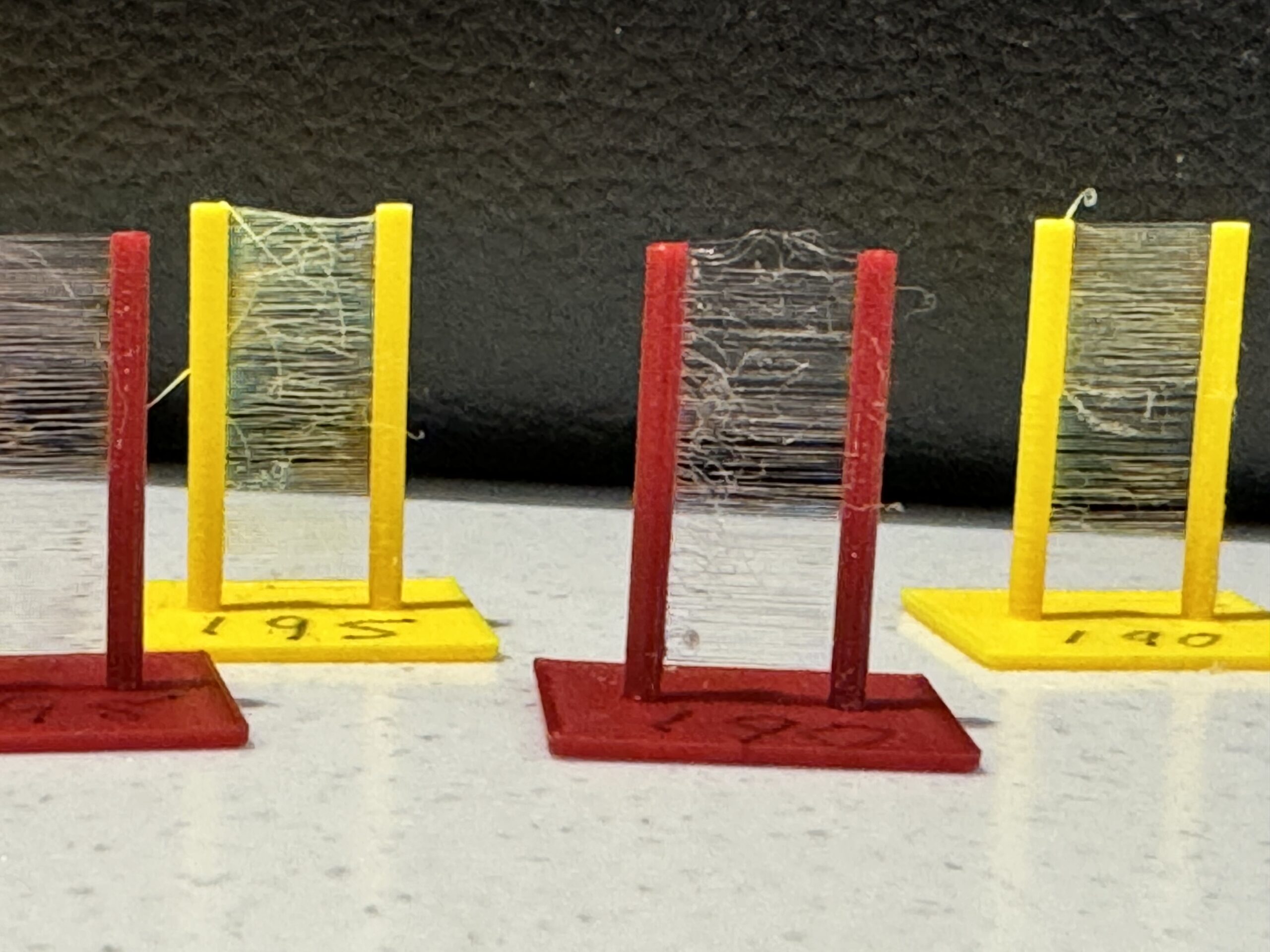

Richy C
(@richy-c)
Update!
Unfortunately, the new Hot end thermistor made things a  lot worse.  Check images.
However, reducing the temperature down to 180 did help dramatically.  However, I am extremely concerned this will affect adhesion.  More tests required 🙁
Posted : 13/11/2023 1:51 pm
