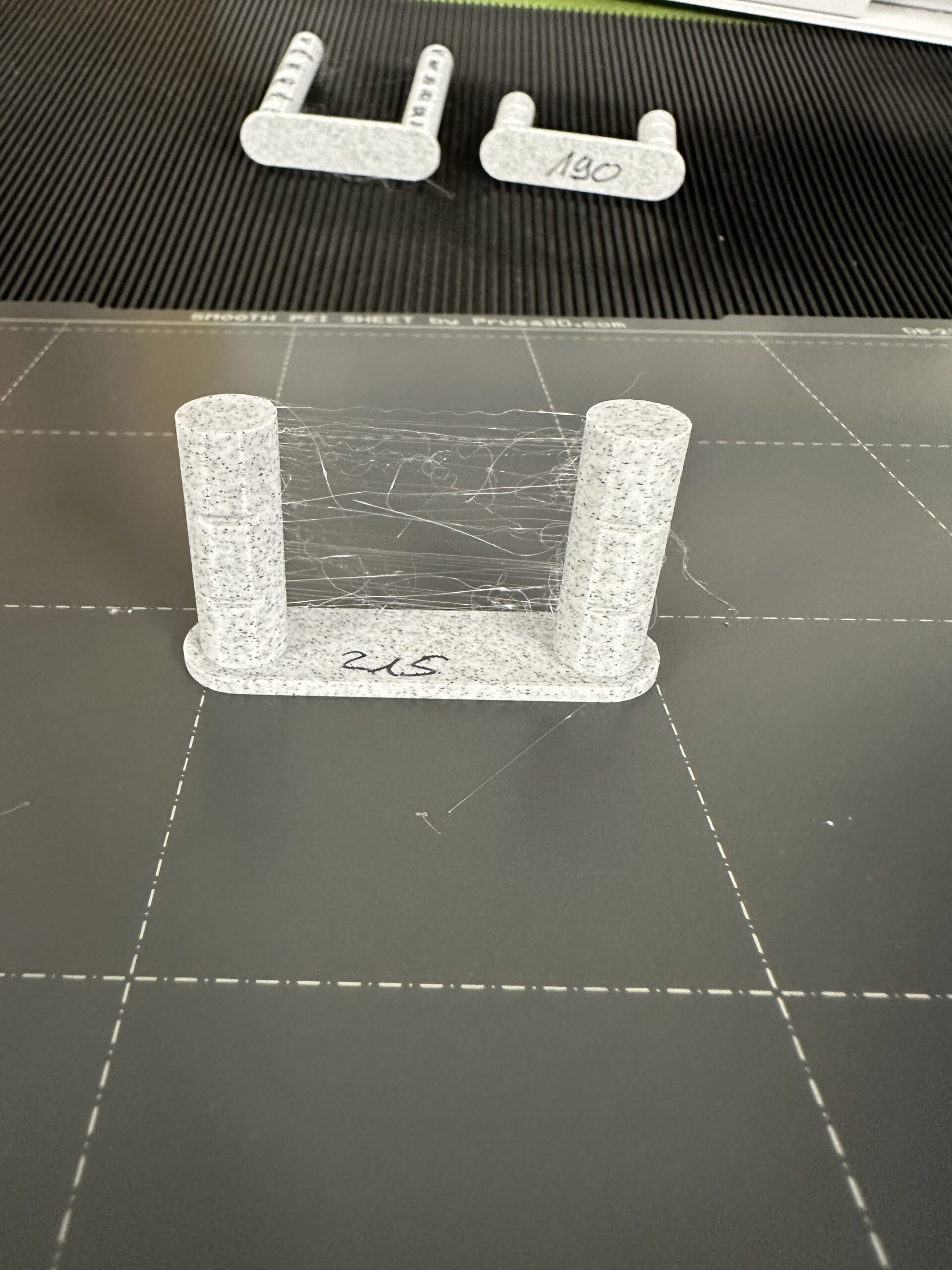

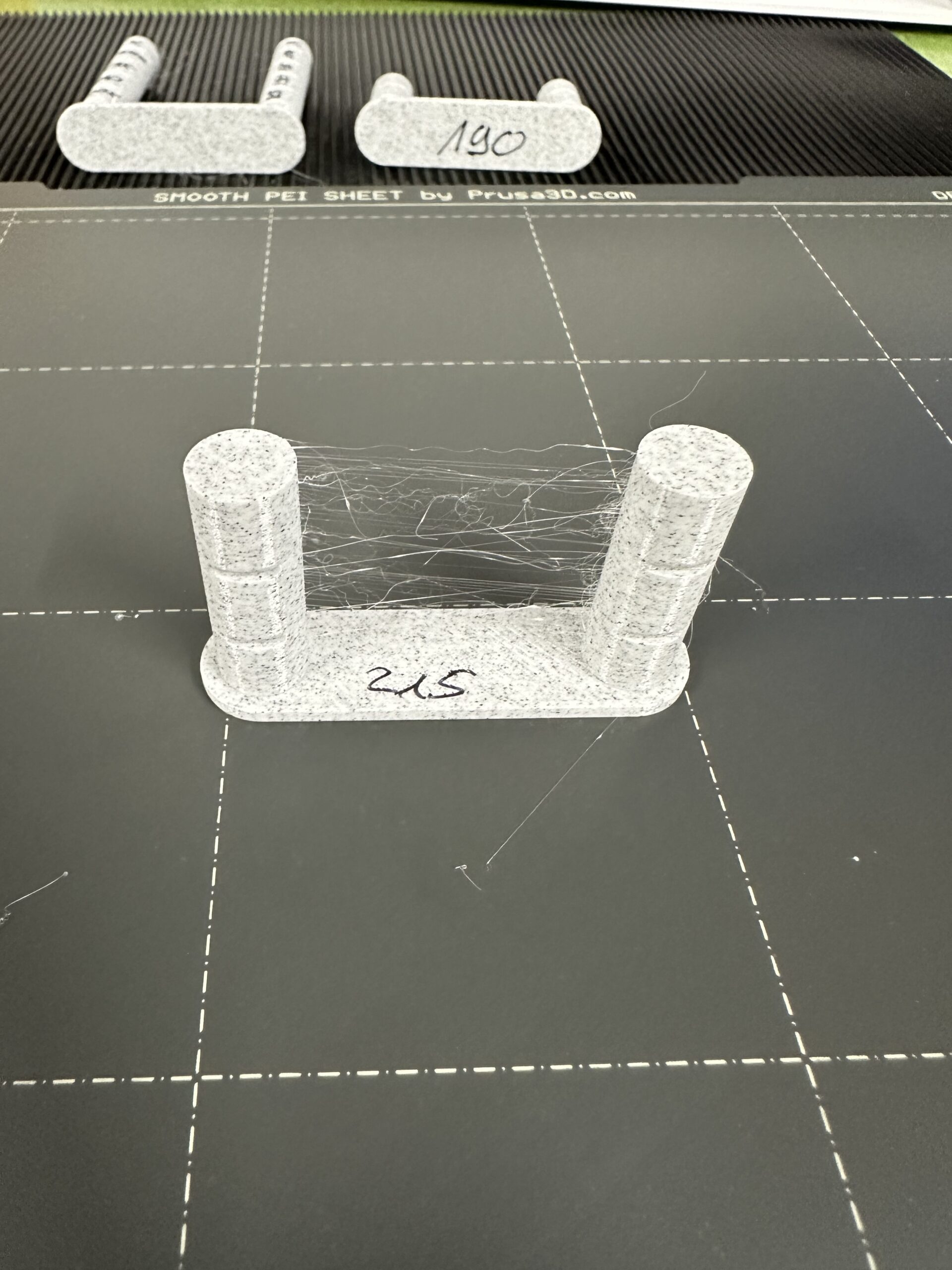

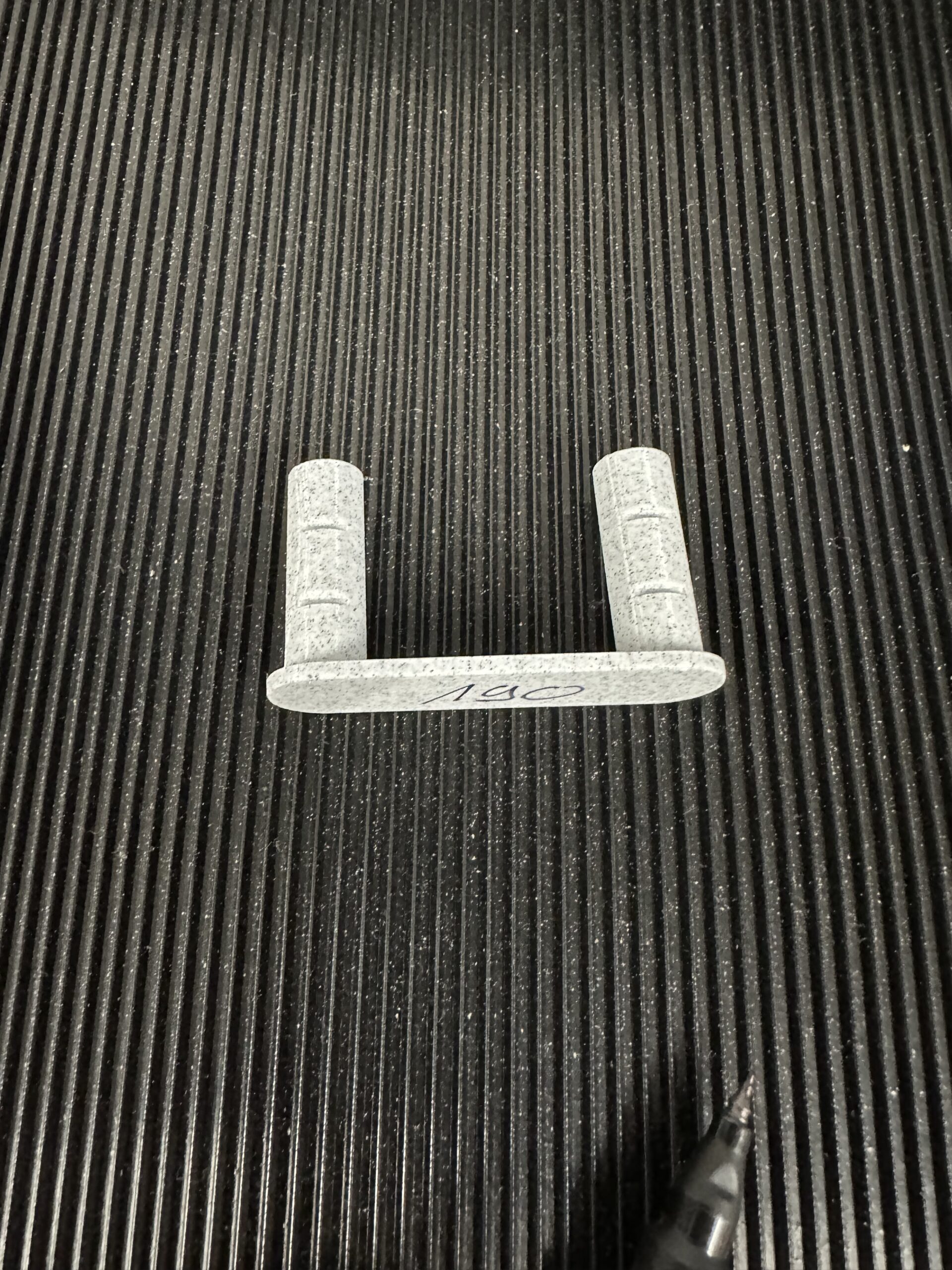

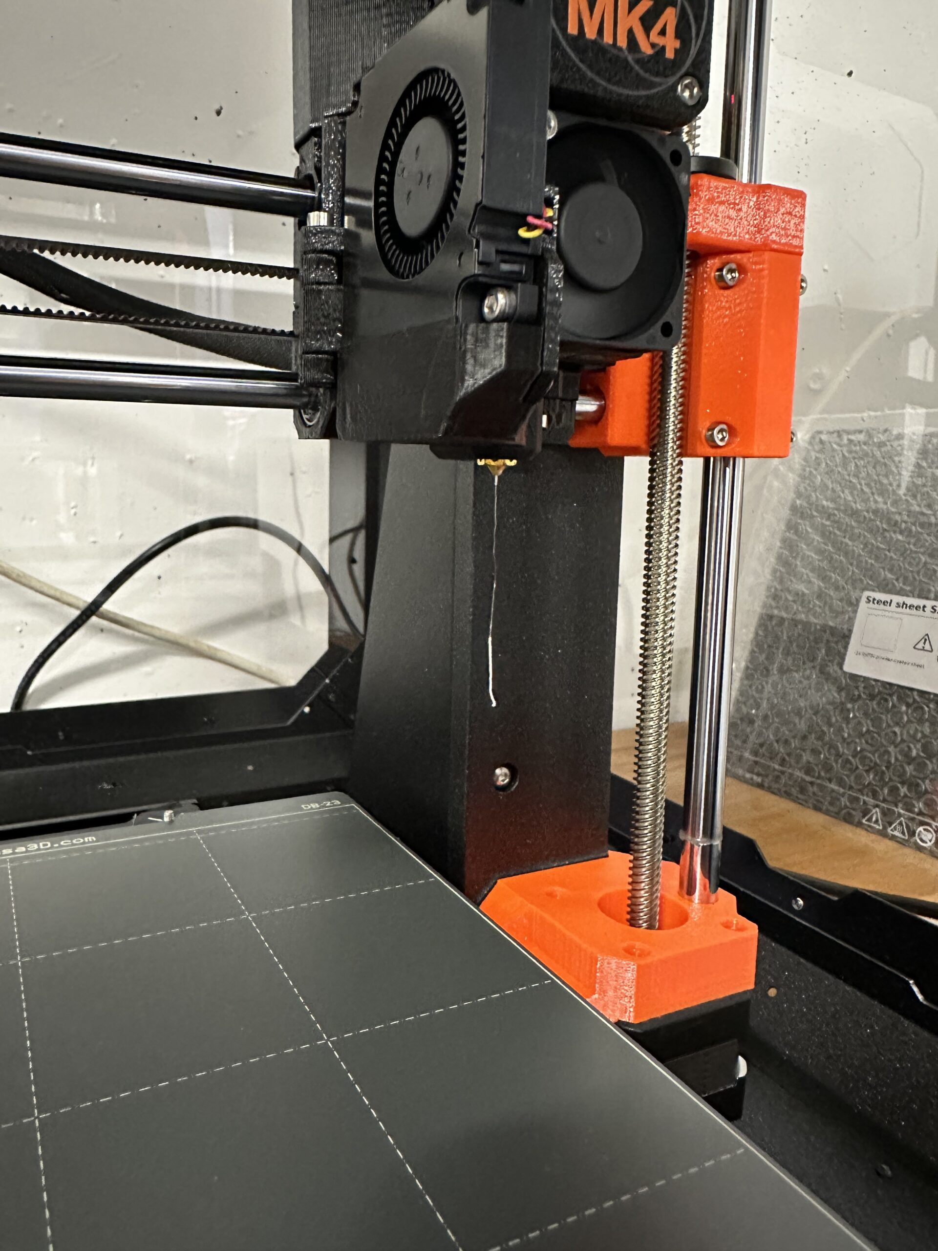

I tried some temp-settings today.
Figured out, that when i reduce the temp to 190degrees the stringing is gone (printing with sock, activated in firmware and std-0.4 nozzle).
When starting with 215 degrees there is a lot of stringing.
As well when homing with 170 degrees there is a lot of oozing/stringing. This even that the temp is at 170 degrees locked. Even though i let the printer preheat for around 7 minutes before the homing.
For me it‘s clearly a sign, that the temp at the nozzle is to hot compared to the value on the display.
Does anybody have a MK3s to test the file and print it with std prusa-slicer settings?

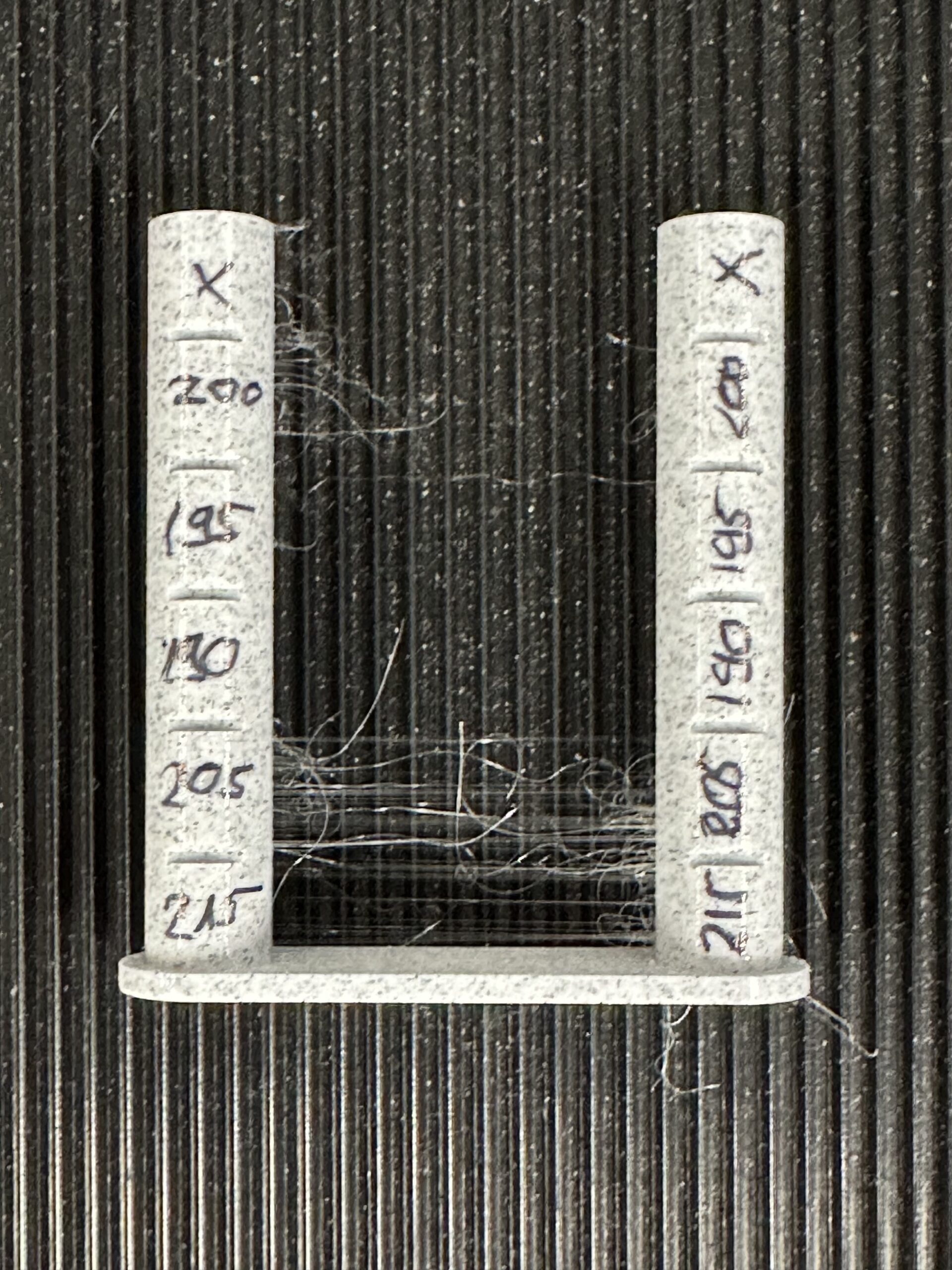

Mines oozes so much the bed leveling fails very often.
 But when I do temp towers, at 190, there’s clear under extrusion and layer adhesion issues.

If you have such doubts snd evidence  then there is the possibility that the temp sensor on the hot-end is out of spec. Its a simple thing to change. Order a new set of temp sensor, heat block and heater cartridge and  change it over !
If you speak nicely to PS there even the possibility to swap it under warranty.

RE: MK4 PLA Stringing
Please attach the file, and i will try with both printers (MK3s and Mk4)
I attached the 3mf-Files for both printer.
If you could print it and send me the pictures i will try to contact Prusa Support again.
Hopefully they find a solution then.

Do you have a picture of the underextrusion?
I couldn't figure out some weakness in the testfile after printing with 190 degrees. It was even pretty hard to break the towers in pieces.

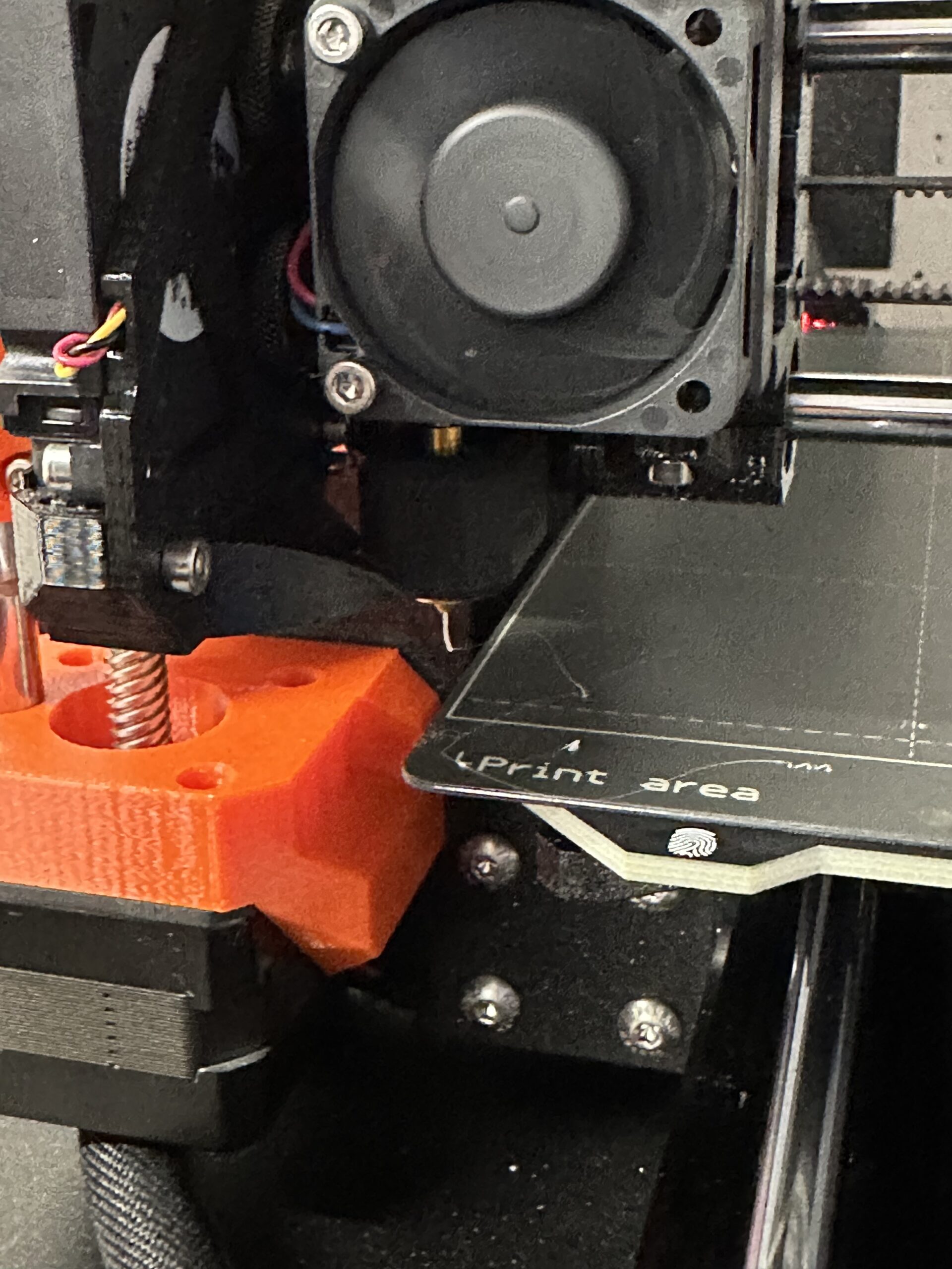

Did anyone tried to increase the heatbreak cooling increasing the heatbreak fan speed?
The nozzle/ heatbreak construction of MK3 and MK4 are different.
MK3 nozzle and AL heatbreak are connected indirectly via the AL heatblock where the filament is shielded by PTFE tube from the heatbreak. The filament has a chance to stay solid above the nozzle. So, the retraction can work efficiently.
The MK4 filament runs through metal tube (fixed to nozzle)  the whole way to the extruder gears with no shielding by any ptfe tube. If the connection between the heatbreak module and the copper part of the nozzle tube, the tube is not cooled properly, so the filament can start to melt before it enters the nozzle. It can result inthe larger oozing and the retraction being less efficient. If that is the case, then there is some issue of the MK4 nozzle HW design and there will be a difficult way to avoid the stringing.

Sounds like a great hypothesis, but fails on the fact most are having little or no problem. including me.
Also I think there is some misunderstanding evident in the quoted post on the theory of how the Nextruder hot-end system is designed to function.
 The whole of the long metal tube acts as a “heat break”, cooled by firstly the heat sink and secondly by the hot-end fan (on the front of the extruder). The key is in the material that tube is made from, which would be a metal having higher heat resistance. Its all about control of the rate of heat dissipation. The tube will have a gradient of heat from bottom to top.
Also key are the two knurled screws holding the tube in place. If not tightened correctly then heat transmission from the tube to the heat sink will be less efficient. Also look at the heat sink itself ensure it has nothing impeding air flow.
So, to those having this issue I suggest investigate installation of the hot-end into the extruder and check that its fully inserted and secured properly by the two knurled screws. (When I checked  mine, I found the top one was slightly loose.)

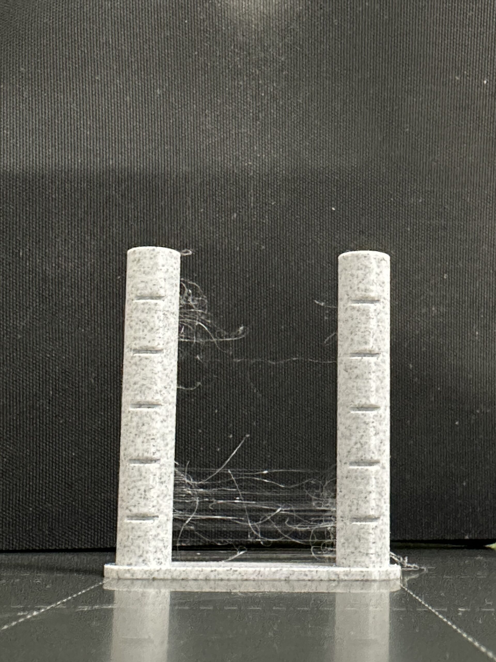

Well, it seems that *something* has been improved...
Today I´ve installed the new 5.0.0 release firmware at my MK4. After updating I´ve perform a factory reset, doing all tests again, works fine.
Now I´ve printed a temp tower using Prusament PLA and standard profile for MK4 Input Shaper "SPEED" with 0.2mm layer height. I´m very happy about the result at the very first try:
210 degrees looks good for this template using Prusament PLA.

This picture is all I kept. The 190 part of the tower separated as I was flexing the bed sheet to remove the print.
