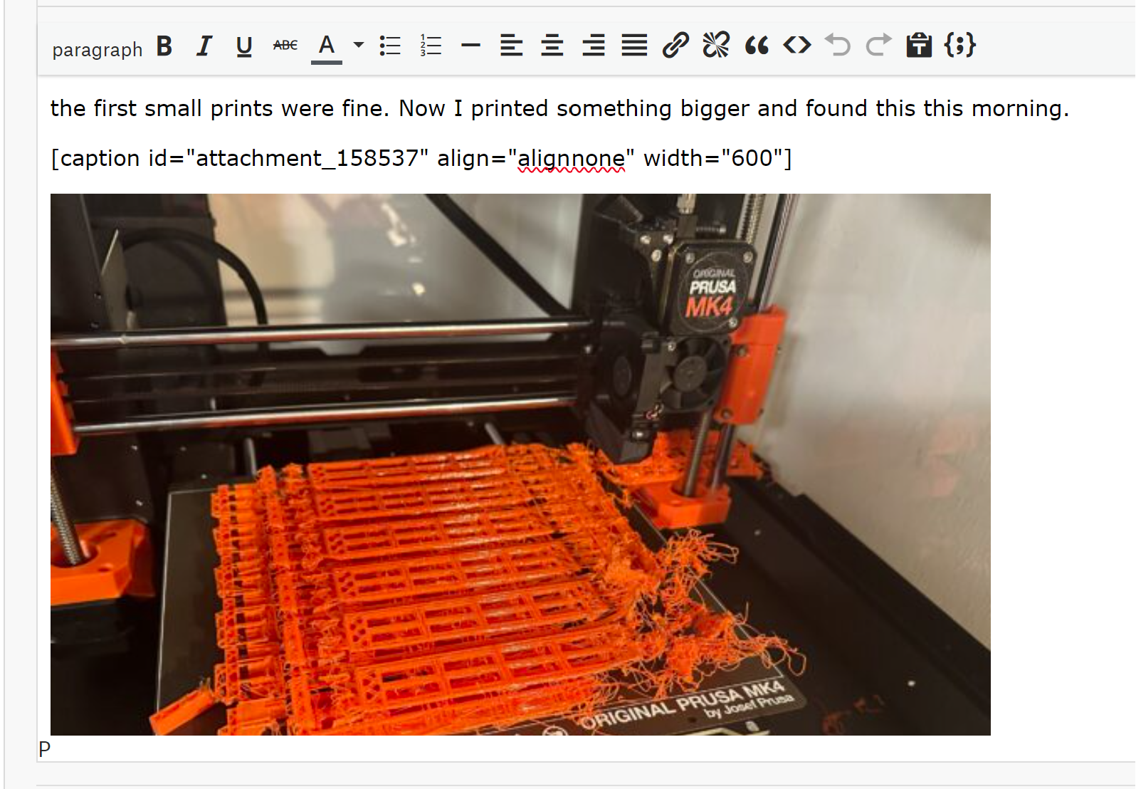

the first small prints were fine. Now I printed something bigger and found this this morning.
Mess while still printing
Mess Closeup
In the last days I had a similar issue when printing a spool part, but thought it was because of a problem with the filament, which wasn't pretty tightly spooled. Now I'm not sure.
Another comparable error in the last days
So: the first layers seem to be ok, then for some reason something gets messed up.
I was printing Prusament PETG both times on the TXT sheet, 0.4 nozzle, 15% infill and 0.2 or 0.15.
Unfortunately I don't have a cam set up yet so I don't have video or timelapse.
What is likely to cause these issues? How can I prevent them?

Please confirm - this is either a bed of multiple parts printing together or a single large part with several start points, effectively multiple parts until they join higher up ..?
If so, it looks like one of them lost adhesion and then crashed the print head and other parts dislodging some and causing the print head to lose its homing position.
(It's possible but *very unlikely* that a part dislodged and then restuck in a new position.)
In which case the commonest cause is a dirty print sheet - fingerprints and stray lubricant would be first suspect.
Next, if it's a single large multistart part, is a fractionally off-level base so that when one side is firmly stuck the other is tilted, say, 0.1mm higher and so only loosely attached.  To fix this case use the Place on face button.
Posted : 21/10/2023 10:13 am

It's multiple parts on a plate to print them all at once.
I actually cleaned the sheet with IPA before printing.

Clean with IPA between prints.
At the first hint of a problem, use dishwashing detergent (Dawn/Fairy) and HOT water.
If this is not enough rub neat dishwashing detergent into the sheet, wait a few minutes then rinse clean with VERY HOT water.
If that's not enough use acetone: *On the smooth sheet only* - not the sheet in  your pictures - once or twice a year at most.
All this assumes fingerprints, perhaps stray sugars or light lubricants but if you are using aerosols, sprayers, laser cutters, welding kit or similar in the same workshop then there might be other cleaning agents required. The sheet must be clean.
