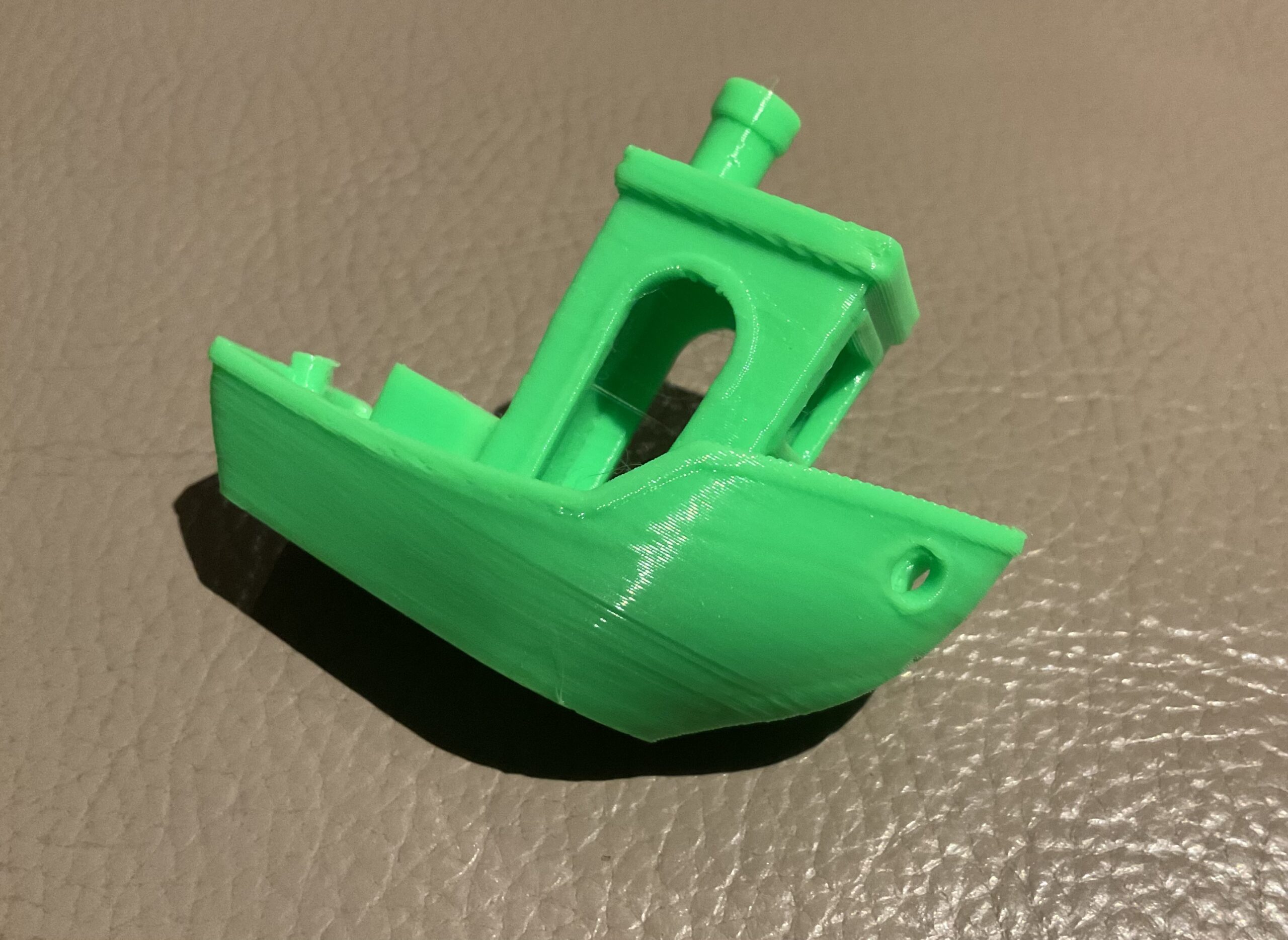

Today, I stumbled upon a solution for my problem. During the initial calibration, I put some weight on the z-axis when it started moving down (using two fingers on the left and right ends of the x-axis assembly). With this, z-axis moved beyond the 1/3 point and finished the calibration using the final approach with the load cell.
All this seems a little bit odd to me - I have reassembled the z-axes once, checked the rods and have found no points with elevated resistance or friction.
Currently, the printer is working - I have to get some minor flaws sorted (see the benchy below), but right now, I’m very happy that I can print!
Maybe a similarly simple solution appears for your problem, too?
