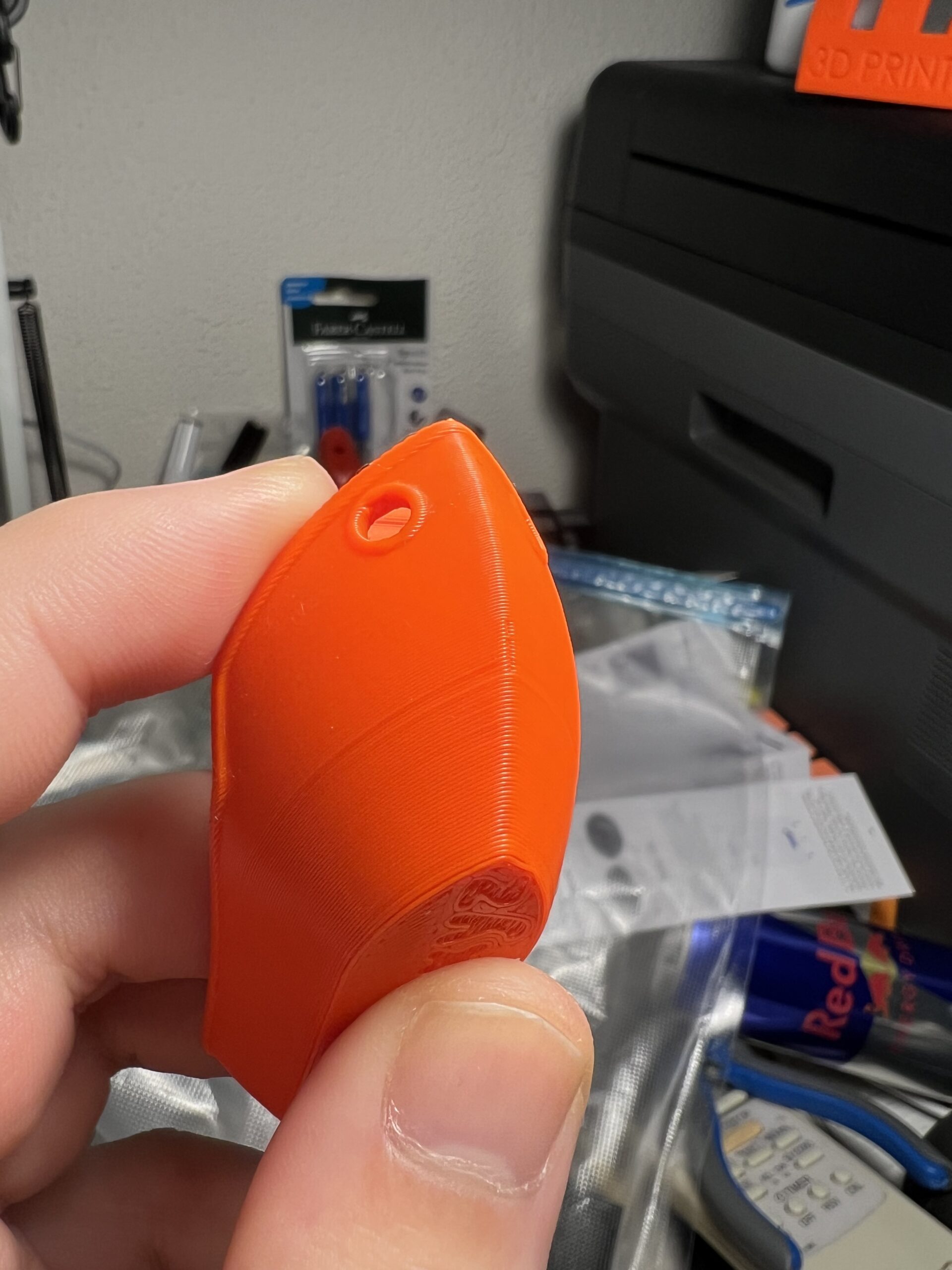

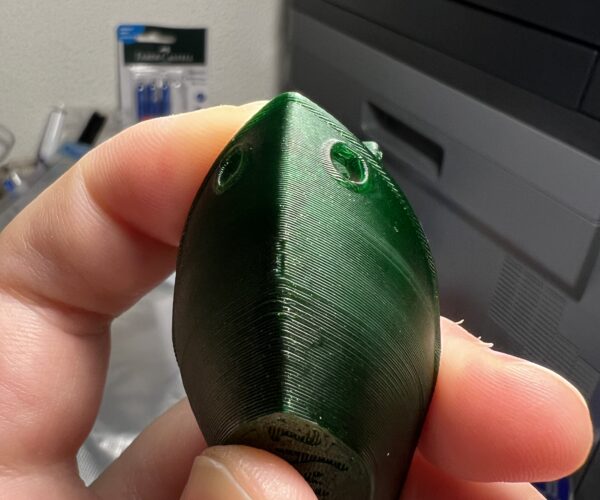

After more than a month of excellent-quality print in the enclosure, I've seen big troubles with corners. Doesn't matter: PLA, PETG, new or old spool.

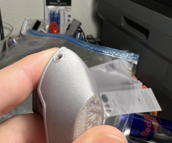

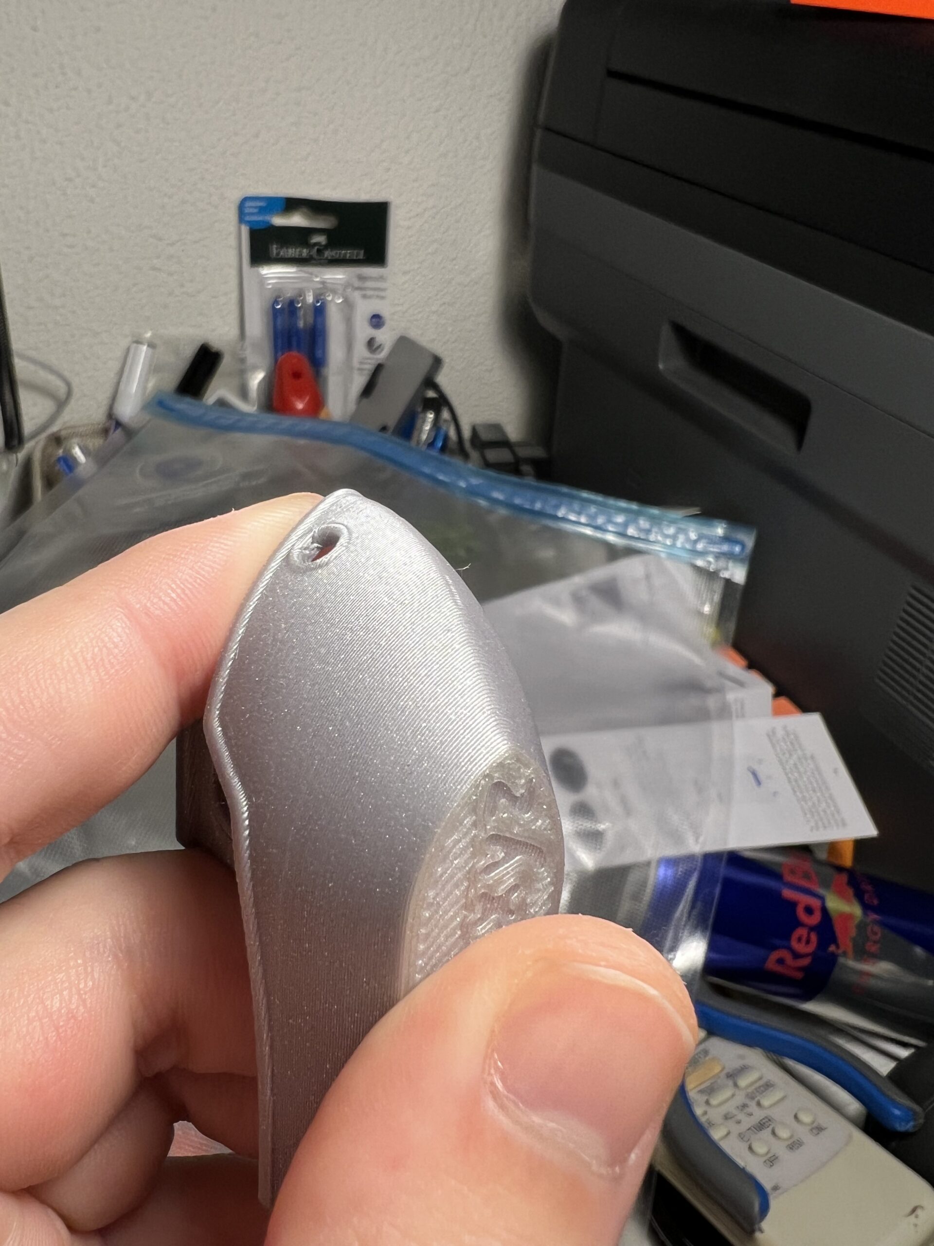

3d Benchy before:
PLA
PETG
Excellent print, without any issues. Enclosure with closed doors.

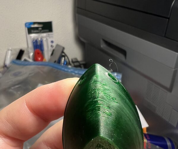

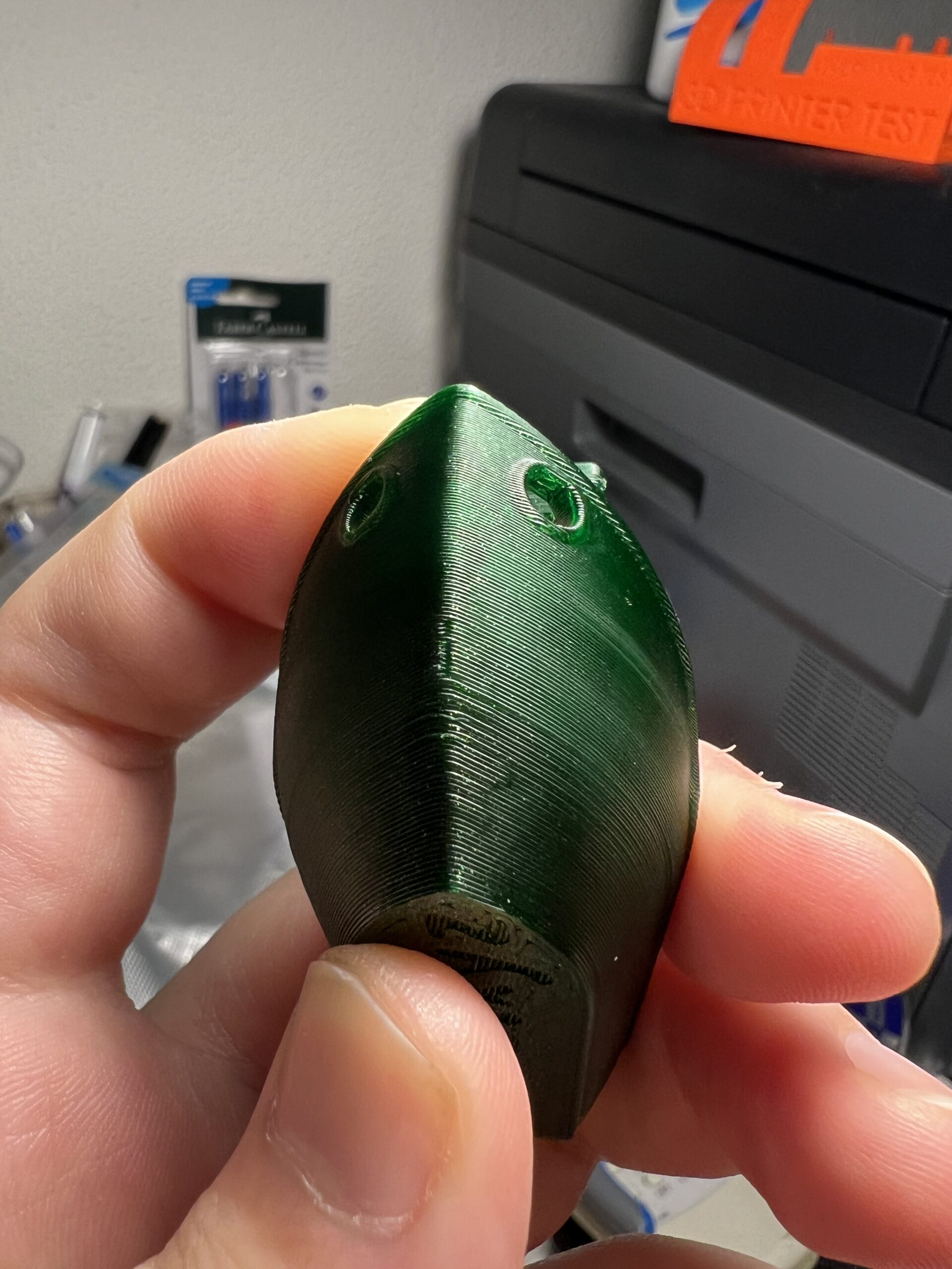

And now:
PLA with closed doors
PLA with open doors (you can see a little swelling on the nose)
PETG closed doors
Nothing changed in setup or configuration. The ambient temp increased from 20 to 22 degrees.

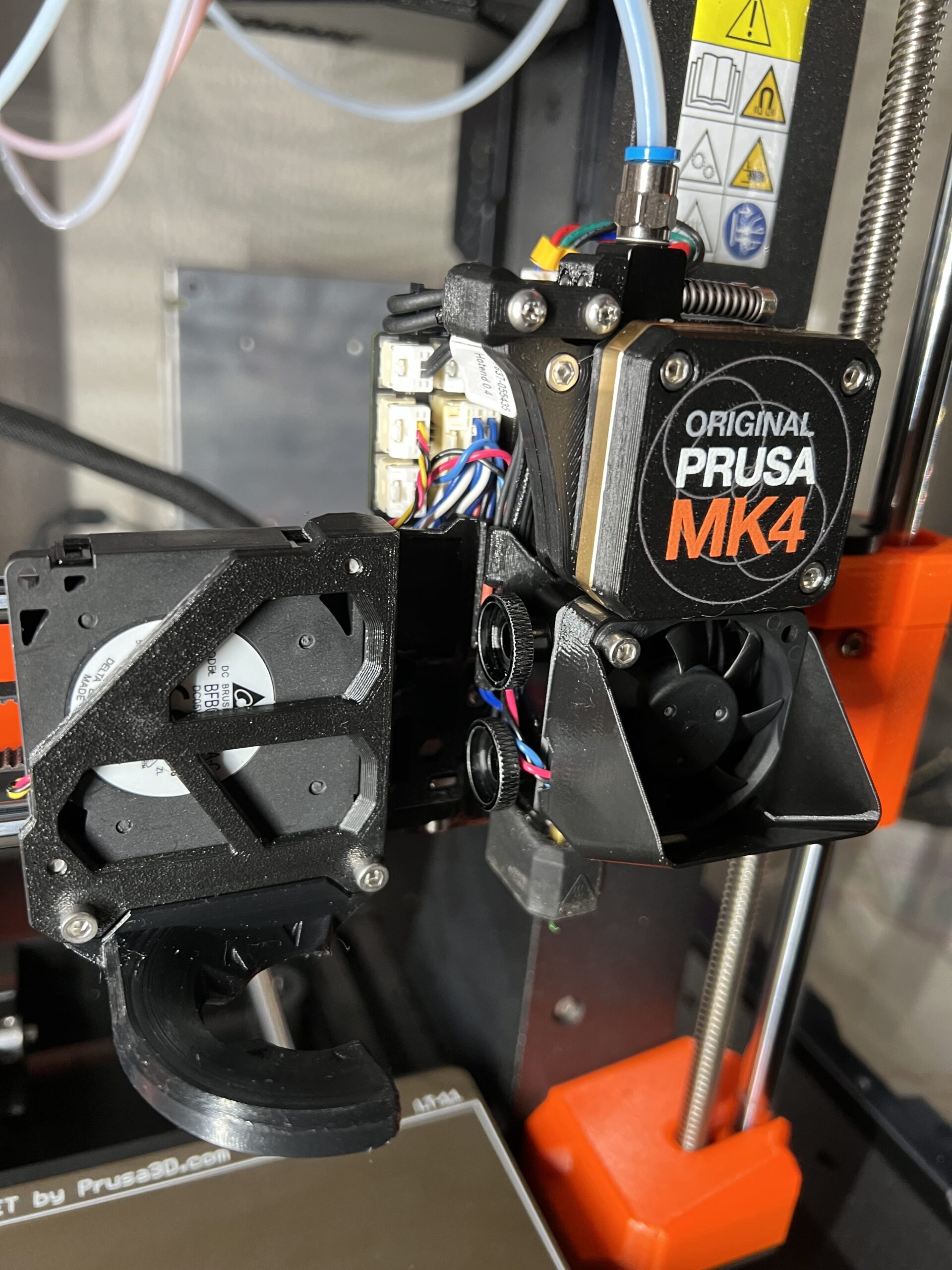

I did full maintenance of extruder, checked tightening belts, checked all wires, made a cold pull, and checked all bolts.
Additional working together with tech sup:
  • Remove printer from the enclosure
  • Measure of resistance and voltage of electricity (thermistors and heaters), all passed well.
  • Checked first layer test
  • Hard reset with write FW (5.1.3)
The problem reproduces with the new spool of PETG, with other spools of PETG, with PLA.
Tech sup thinks that this is hotend thermistor(despite normal resistance) and sent me another one. I'm waiting for this now.

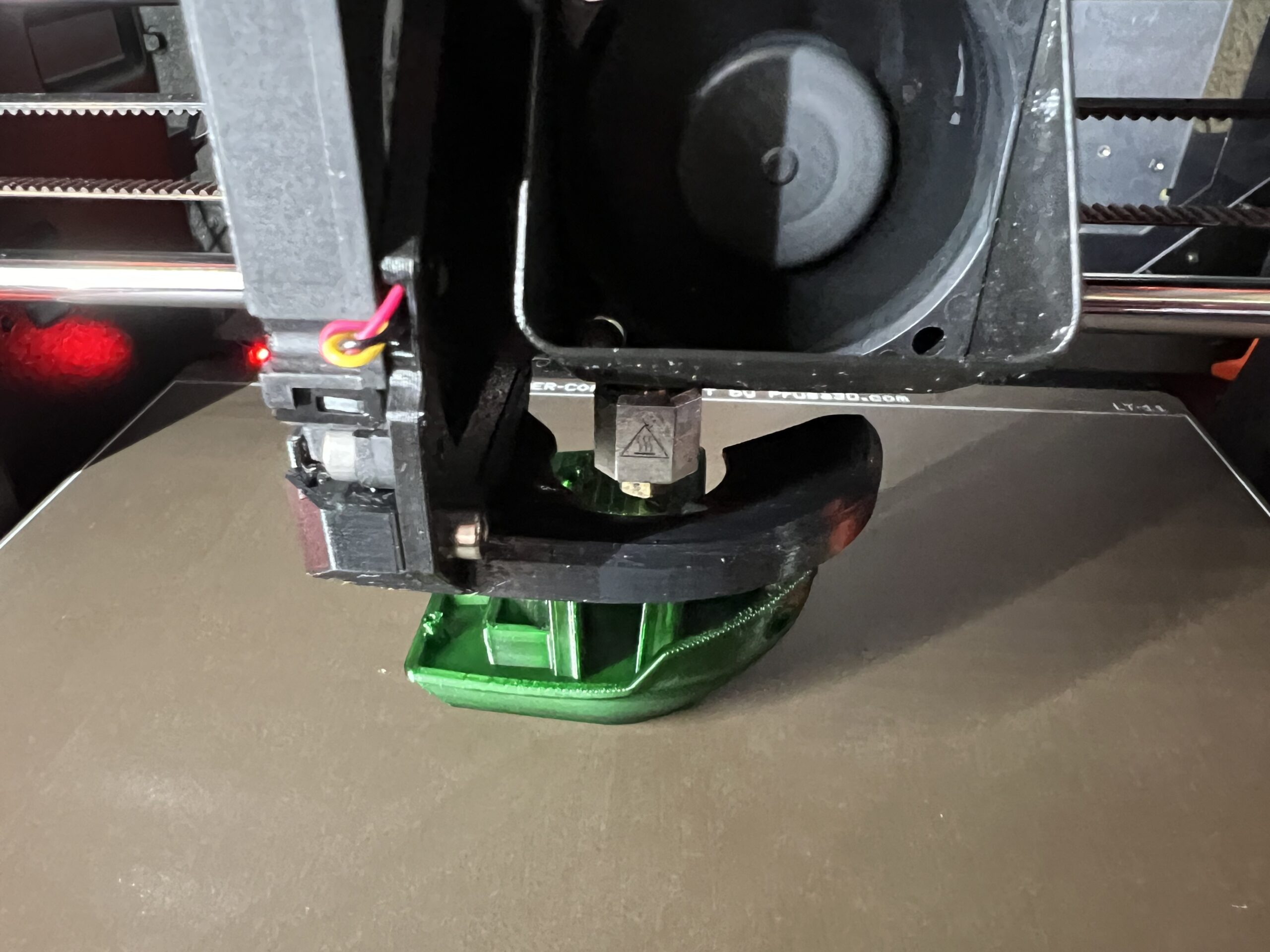

In general these images look very much like a weakening of part cooling for whatever reason. This can be either because the enclosure is now warmer than a few months ago, or that the fan might be a big clogged by dust or weaker for whatever other reason. There are special radial fan combs on printable with which you can pull out the dust from the radial fan. That can help a lot, if a lot of dust has accumulated.
In general, whatever the cause, what you can do to improve overhangs is:
Increase part cooling fan power (if not already at max)
Slow down at ovrehangs or in general.
Orient the steepest overhang towards the partcooling fan shroud.

Actually, this is not the optimal orientation for overhang cooling. For the Mk4 the optimal cooling orientation is a bit less clear than for the Mk3. I would think the front of the Benchy should look diagonally towards the left front corner, maybe straight to the front.
I would assume that the default settings are optimized for printing without enclosure. You have to be aware that in enclosure ambient temperatures will be higher and therefore cooling more demanding. For every filament other than PLA higher temperatures are actually something you want but they do have some downsides and cooling is one of them.
Thats why we have test prints. To calibrate settings for the very own setup. Of course, that doesn't explain the deteoration in overhang printability in your case.

I checked the print fan, it's clean like brand new.

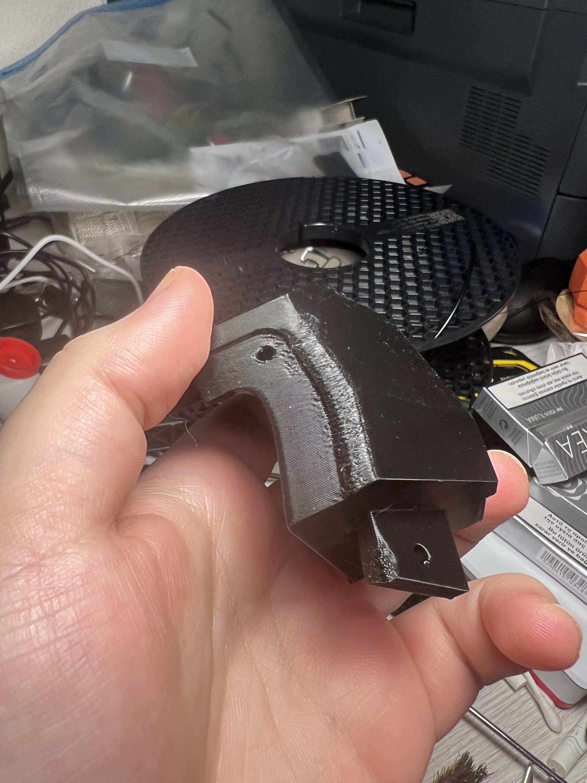

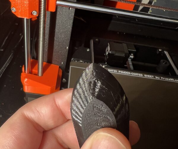

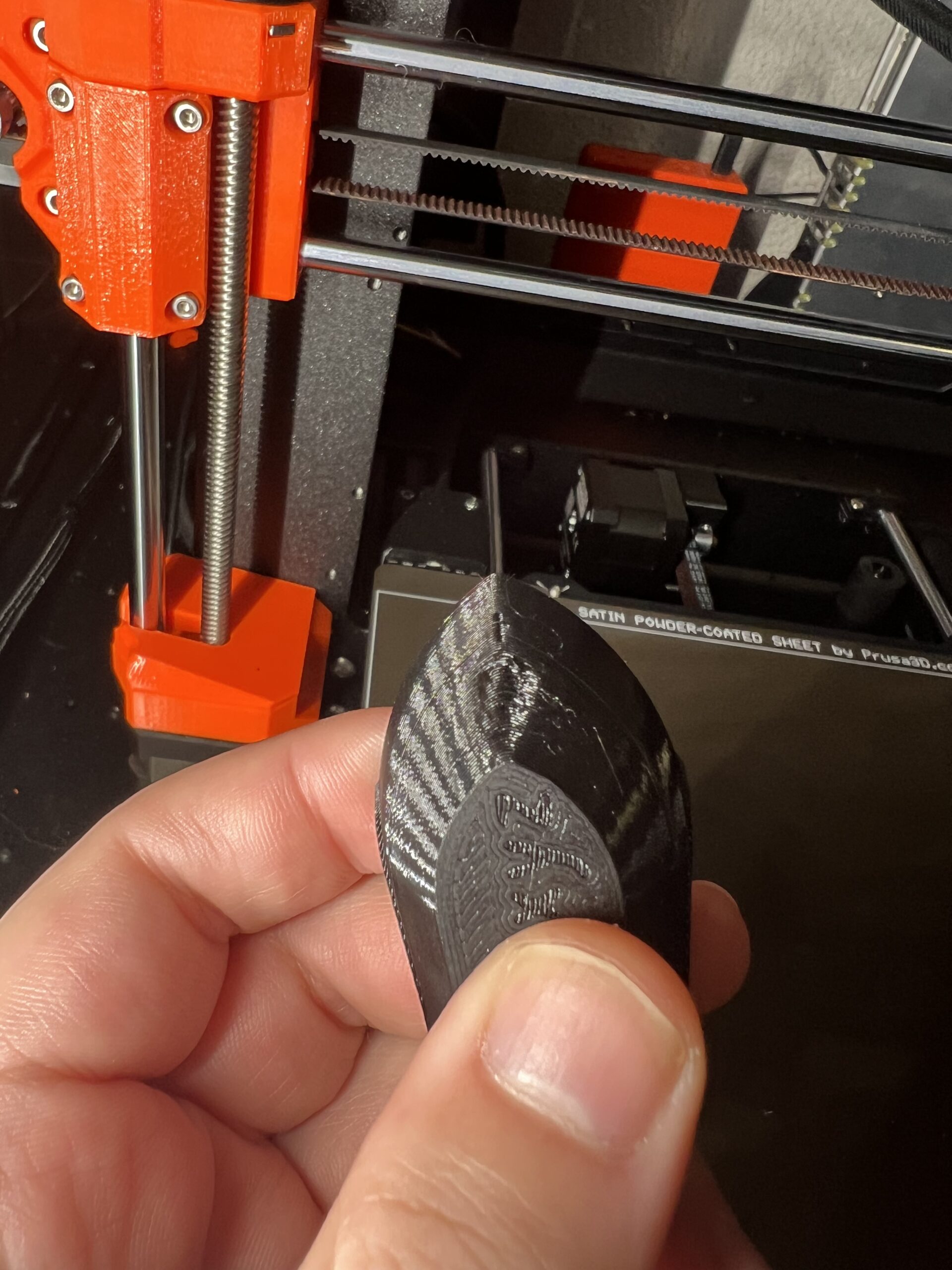

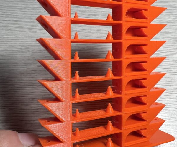

For now, I try to print only with open doors, PETG\PLA. The problem is still here: 56b3d2e3-img_5685-scaled.jpeg
I found the problem when trying to print this detail (PETG):
Many tries with different angles. Quality is not well(
I hope it wires from a fan or a thermistor.
Is that one of the corner pieces for the (Un)original Drybox?  The one I printed yesterday in Prusament PETG Jet Black looks almost identical!  Especially those indentations at the same level as the screw hole.
Exactly 🙂
The sides printed perfectly, but problems started with the corners.
You can try to direct the flat part(where the fastening strip) to the backside, that can help.
After a few tries, I've seen usually problems with left-back corners. After research, I reproduced that problem with 3d benchy.
Made a comparison with old prints and saw a difference in quality.

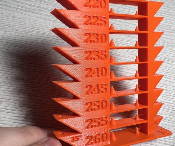

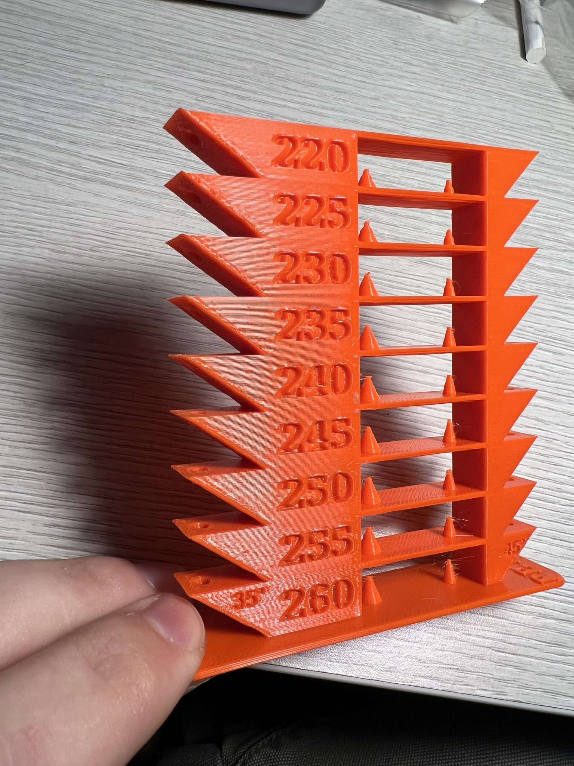

Did you optimize the hotend temperature yourself? In any case, doing a temperature tower with max part cooling would be helpful. Check if you are printing at the optimal temperature in regards to layer adhesion and overhang quality.

So, the next part 🙂

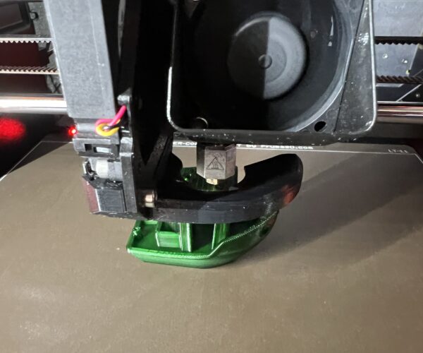

I changed:
  • hotend thermistor
  • print fan
  • nozzle to obxidian (have the plan to use carbon fiber later)
The problem is here.

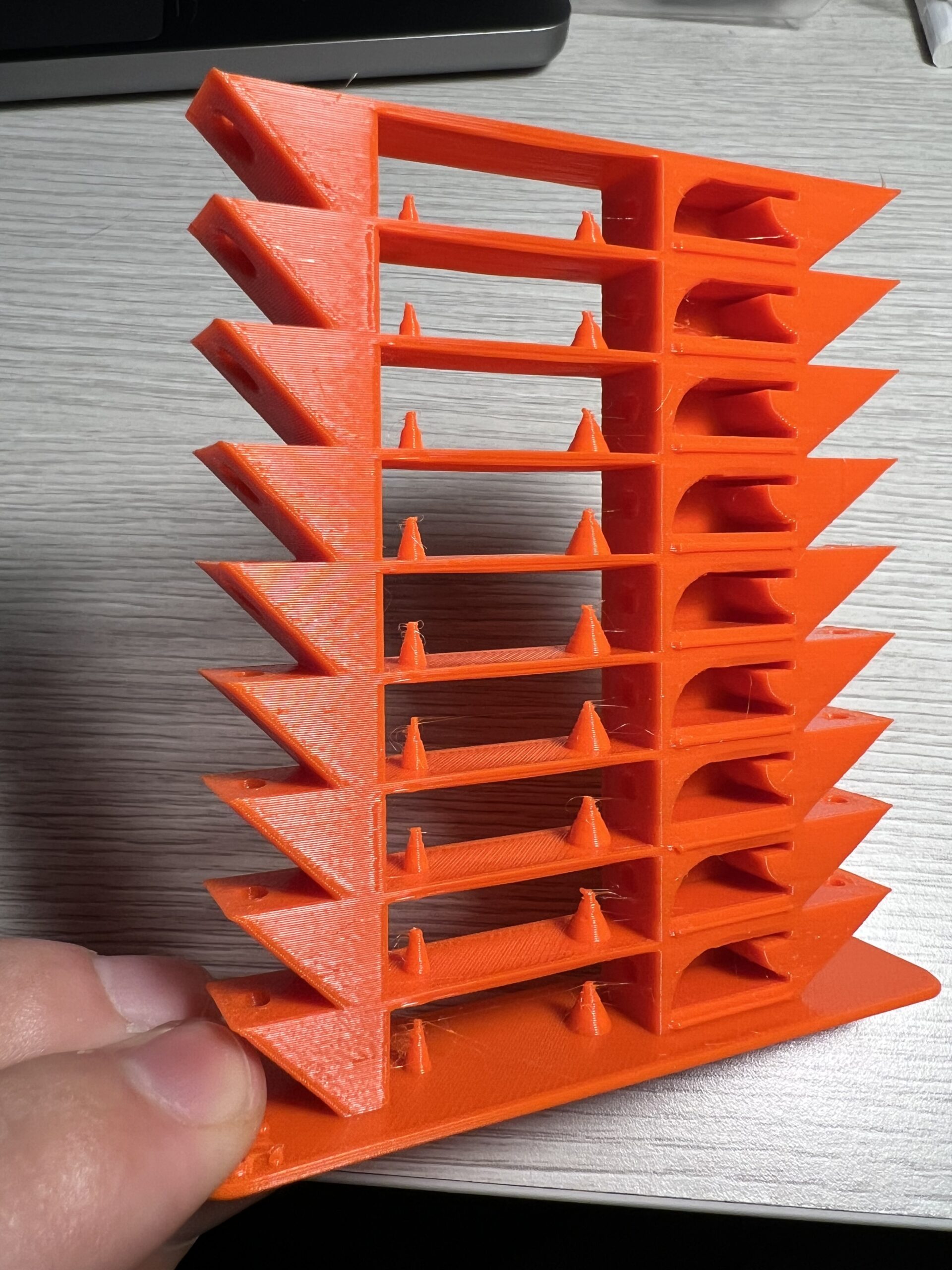

I tried to print temp tower (with closed doors), but to be honest, I don't see the big difference:
