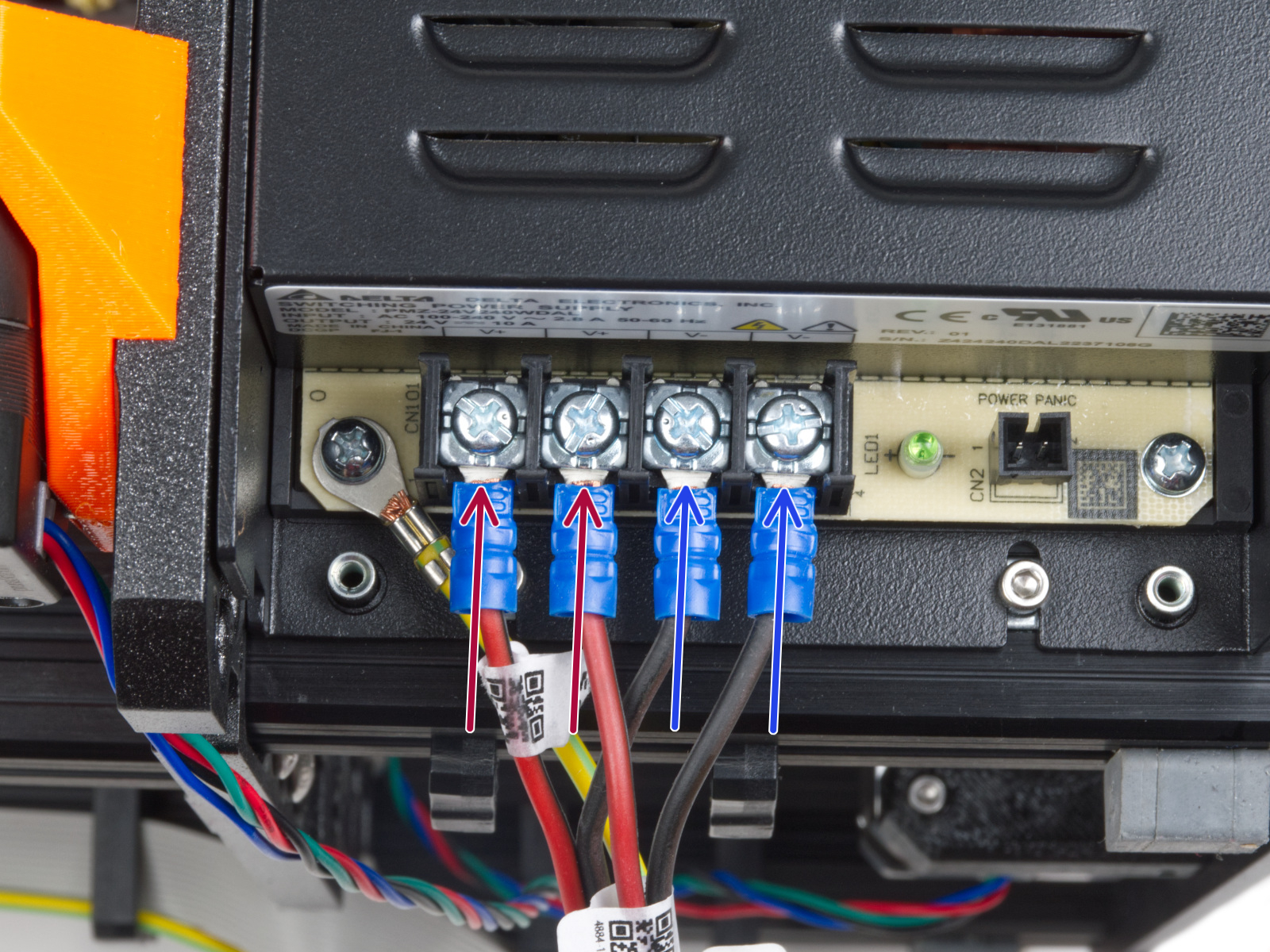

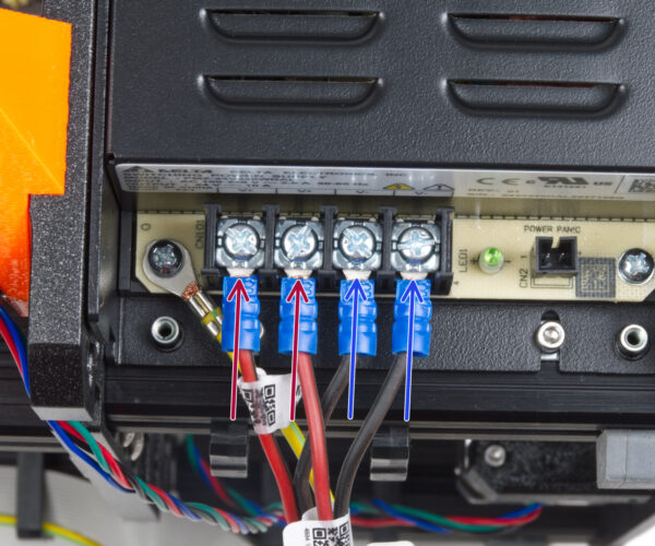

Hello! Recently purchased the MK4 Kit. I finished the assembly and finally reached the step of connecting the power supply unit, but there was no power running through the unit. I tried multiple outlets and double-checked the unit setup and connections. Has anybody else run into this issue/have some suggestions? I have already reached out to PRUSA but am still waiting to hear back.

did you connect the power supply correctly?
https://help.prusa3d.com/guide/6-xlcd-assembly_437030
step 26

Thank you for responding. Yes, can confirm that they are in the appropriate location.

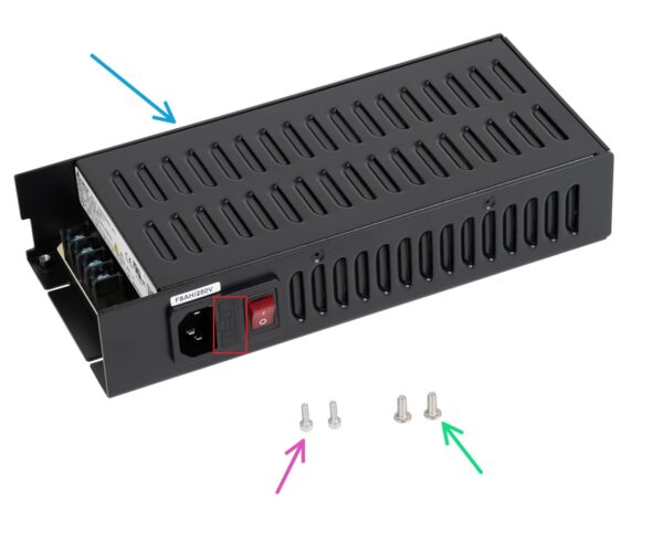

Check if the mains is powered.
Also check the power supply fuse. It may have protected itself.
If you have a DMM voltmeter check for the proper voltage at the screw terminal.
If present, check for continuity to the controller board and then the fuse on it.

Can you describe how I can check the Delta PS fuse?

 First check the power conections like joan said. And check the power supply fuse the one next to where you plug the lead in. If your in the eu check the fuse on the plug too.

Hi fuse location is red marked on picture.

Just wanted to say thank you. I was able to replace the fuse and got it working. Much appreciated 🙂
