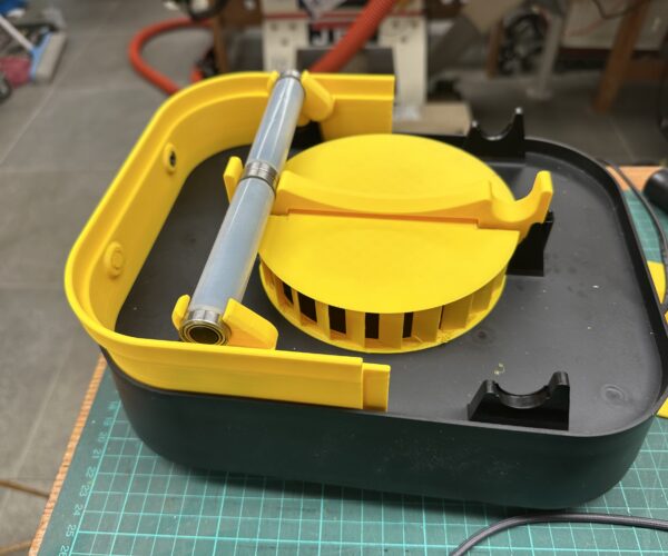

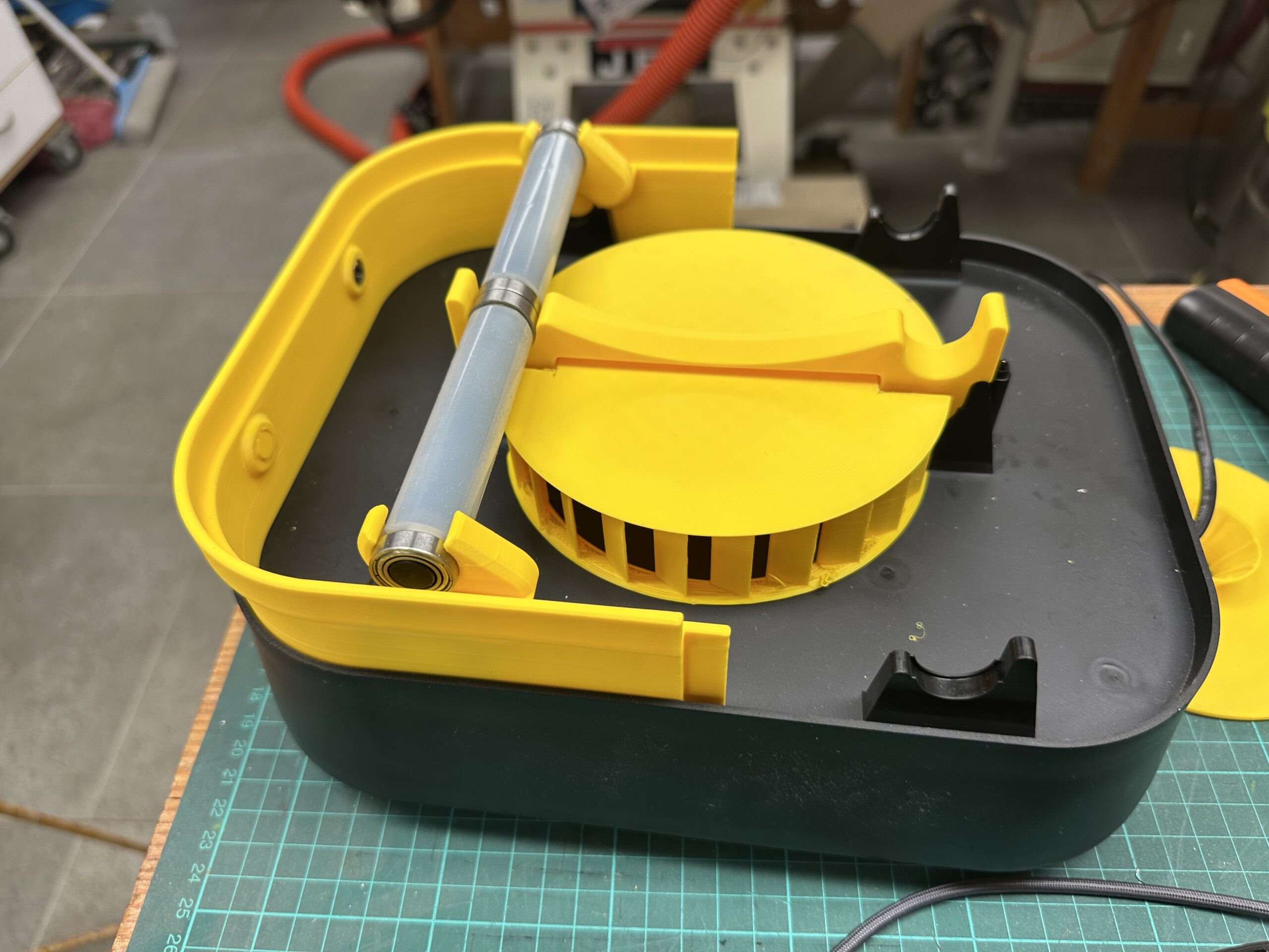

I hadn't seen the thingiverse riser,  but I've gone a little overboard I guess.    Initially I made a set of gears to turn the spare spool while the other was printing, while that worked mechanically it just meant I had two spools on the rotisserie!
It's driven me mad I have to say - so I bought a really cheap food dehydrator and it works really well, but it spurred me on!
The dehydrator has a finned diffuser that forces the hot air out horizontally and in a swirl.   It wasn't too big a step to make one to sit over the existing vent, I had to make a 35mm riser to make it work but that fixes the filament feed problem too.    The image is an early prototype, the thermistor will be raised 35mm and hopefully out of that initial blast of air.
I am waiting for some PC filament to arrive, but I am hopeful!    I would normally not share until I've thouroughly tested, but if anyone is interested let me know.
