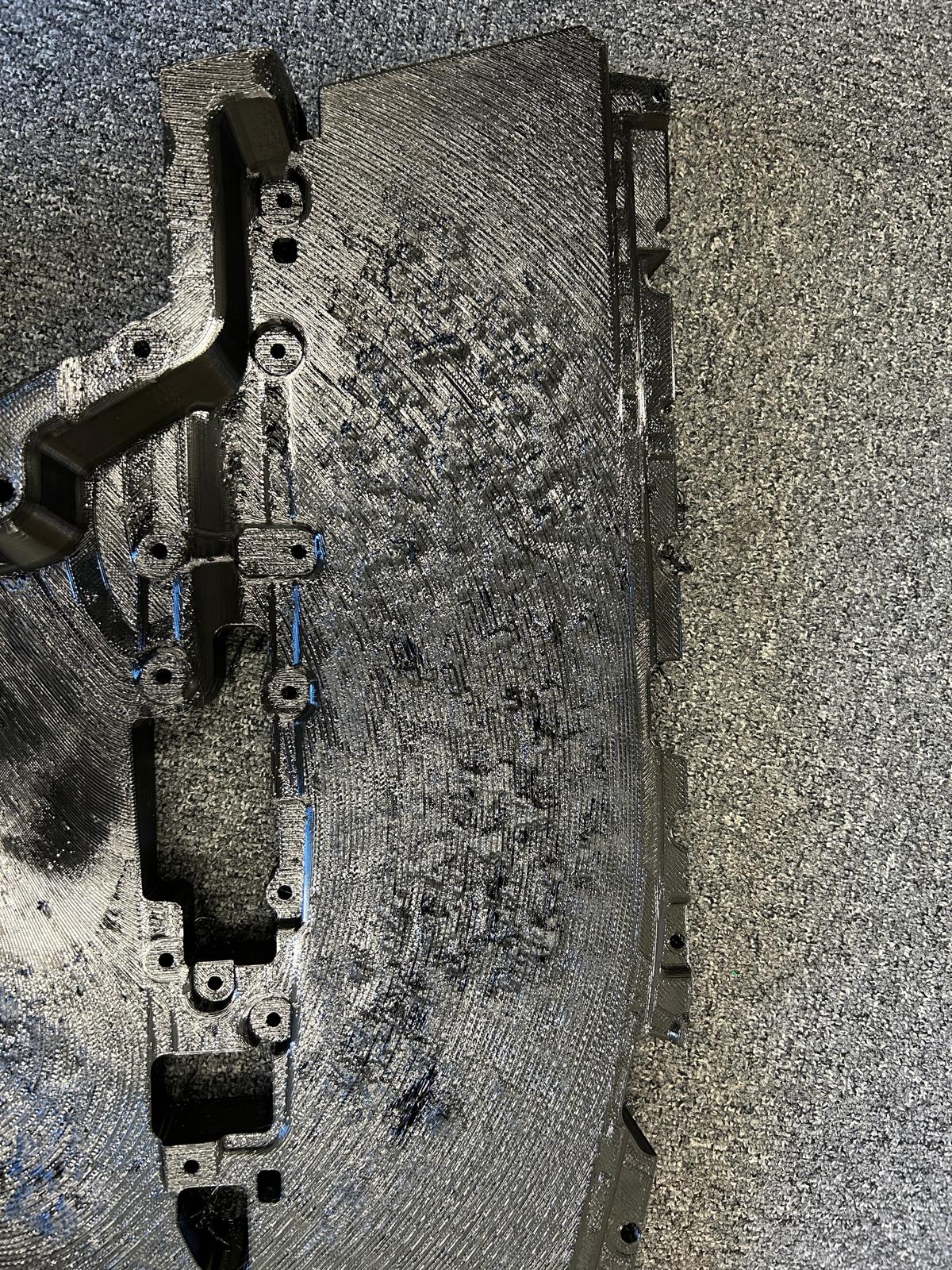

Hello all,
I'm new to the forum, although I’ve been lurking for a while and learning a ton from the advice and tips posted here – big thanks in advance to all the contributors and gurus!
While I don’t have a Prusa, I’m hoping someone here might be able to help me dial in my Creatbot D1000. It’s been a bit of a nightmare out of the box, but I’m determined to make it work. I’ve already made some key improvements – particularly to the bed setup.
The print volume is 1000 x 1000 mm, split into four 500 x 500 zones. Unfortunately, the build quality isn’t great, and bed levelling has been a major challenge. I’ve now added a 4mm thick tempered glass sheet, which has helped tremendously – I can actually get prints going now without immediate failures, which is a huge step forward!

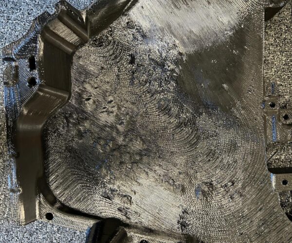

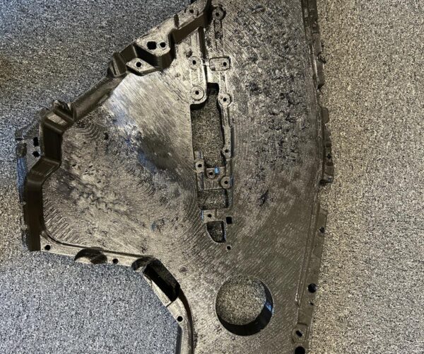

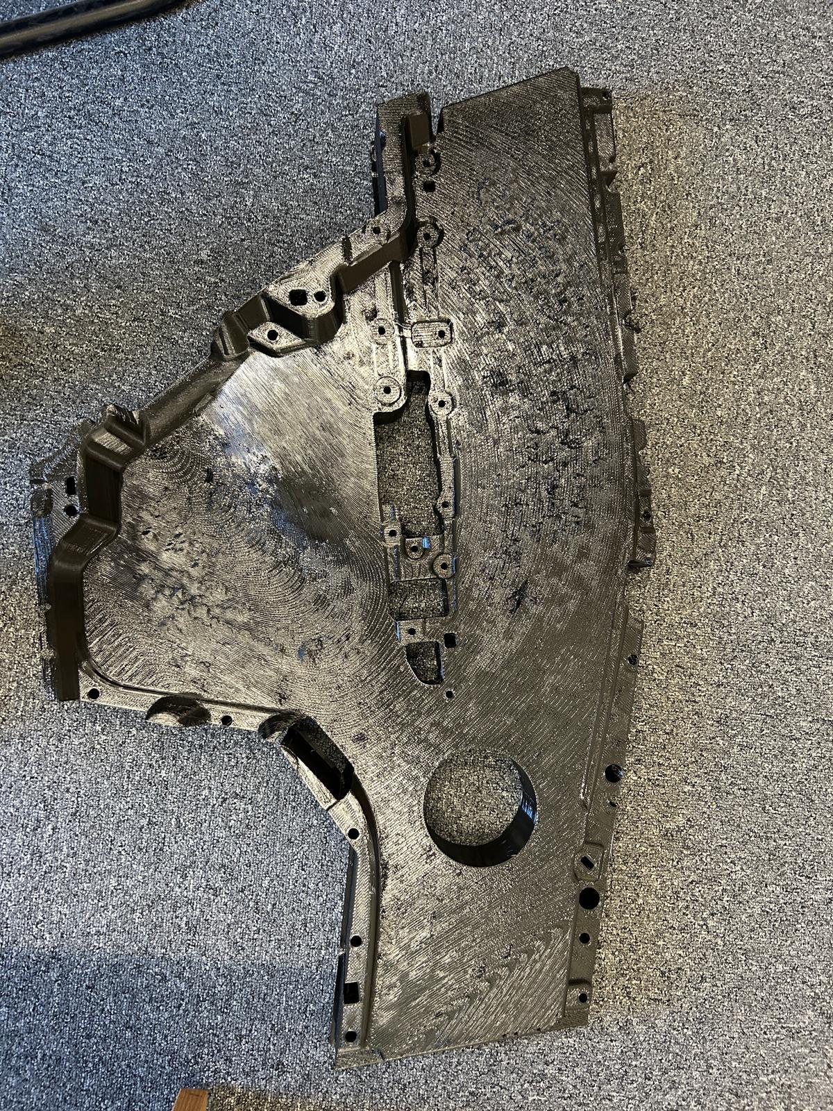

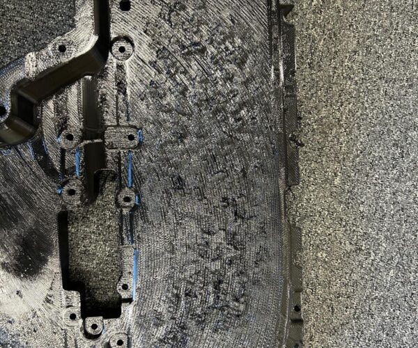

I’ve just completed a large print, and while it finished successfully, I’ve noticed serious issues with the top surface quality. There are missing areas, visible bumps, and poor finish overall – although oddly, some other areas of the print look fine.
Here are my current print settings:
Nozzle: 0.8 mm
Layer height: 0.32 mm
Infill: 15%, Cubic Subdivision
Perimeters: 2
Top solid layers: 3
Bottom solid layers: 2
Speed: 60 mm/s
Retraction: 2 mm at 40 mm/s, minimum travel after retraction 1 mm, “wipe while retracting” enabled
Material: PETG
Temp: 240°C nozzle / 70°C bed
Filament diameter: 1.75 mm
Extrusion multiplier: 0.95
Extrusion width: 0.96 (calibrated via test prints)
If anyone has experience with large-format printers, PETG settings, or issues with inconsistent top layers, I’d really appreciate your thoughts. I’m not sure whether this is under-extrusion, cooling, or something else entirely.
Thanks in advance!
RE: Surface Issues on Large Prints (PETG, 0.8mm Nozzle)
Looks like generic pillowing to me. So add more top layers and maybe increase the infill density some.
Agreed, there is an underlying pattern to the flaws that suggest it is related to the internal fill structure.
More top layers, perhaps combined with a fill that increases density near the top should fix it. Eg, try adaptive cubic fill.
