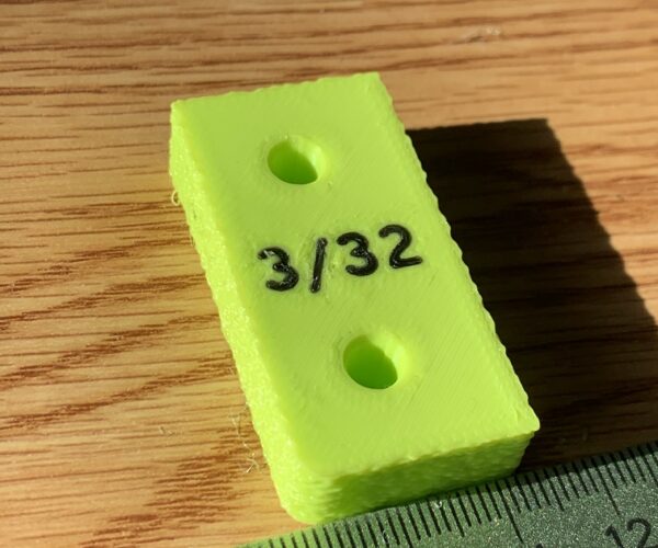

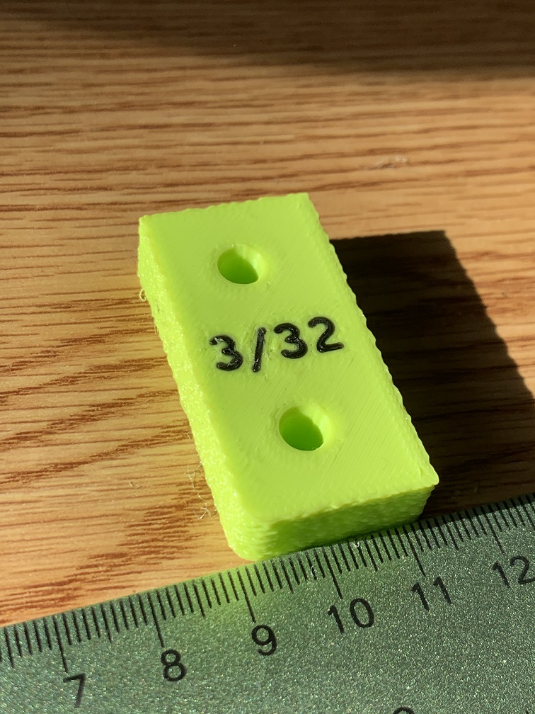

Thank you (@teque5) for doing this research.  I tried out the Overpass font in bold with 16 points in Solidworks and it worked great.  It gave me clear and crisp numbers that were 5.2mm tall and two print lines wide.  I used PETG with 0.2 layer height and a 0.4mm nozzle.
I was also able to make my lettering flush by turning off "merge result" when extruding the lettering in Solidworks.  This allowed PrusaSlicer to split the lettering into separate parts.  Which allowed me to select a different color / filament with my MMU.
