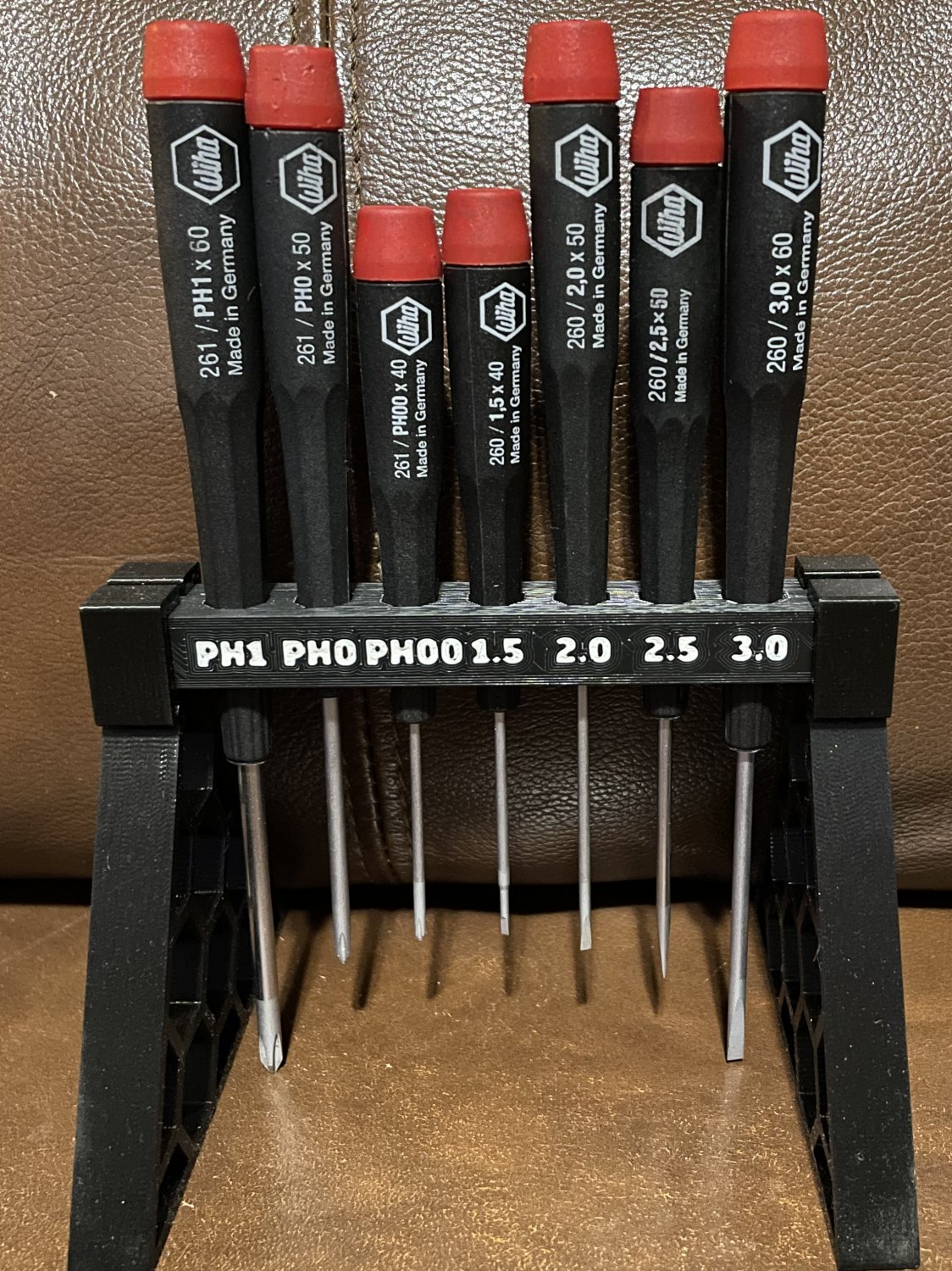

I have been using embossed (or sunken in) text in my Fusion 360 designs, but I needed a way to fill them in with a color to make them pop. I don't have an MMU to print multiple colors. I bought a syringe pack and tried to carefully inject paint into the recessed text, but that didn't work at all. The paint was absorbed by the print and it made a total mess.
Then I tried rubbing paint over the text, but that didn't work, it just made the whole thing white-ish.
Then I found some of my kids modeling clay next to their paints and tried rubbing that into the recessed text, and it worked great. When I was googling around for ideas, nobody mentioned modeling clay. I bought some at the 99 cent store and you get 12 colors for a dollar.
You rub it in, then go over it with your finger or a paper towel to remove the excess. I'm posing a couple of pictures here of the result.
The Bear logo is printed in yellow PLA, but the text is filled in with yellow modeling clay. You can't really tell the difference.
Yellow modeling clay
I downloaded the side mounts off thingiverse, but the cross-bar I made myself in Fusion 360 to match the screwdrivers I had. Here, the modeling clay shows up a bit too much in the perimeters around the text. Maybe if I printed the bar with the text facing up it would look better, I'm not sure.

I've found painting to be very difficult and unforgiving.Modeling clay, on the other hand, is really easy to squish into the debossed text and it cleans up great, just run your finger over it to collect the extra clay. I think my pictures show that you can get really nice results with clay, but with paint, it was a total disaster for me.
