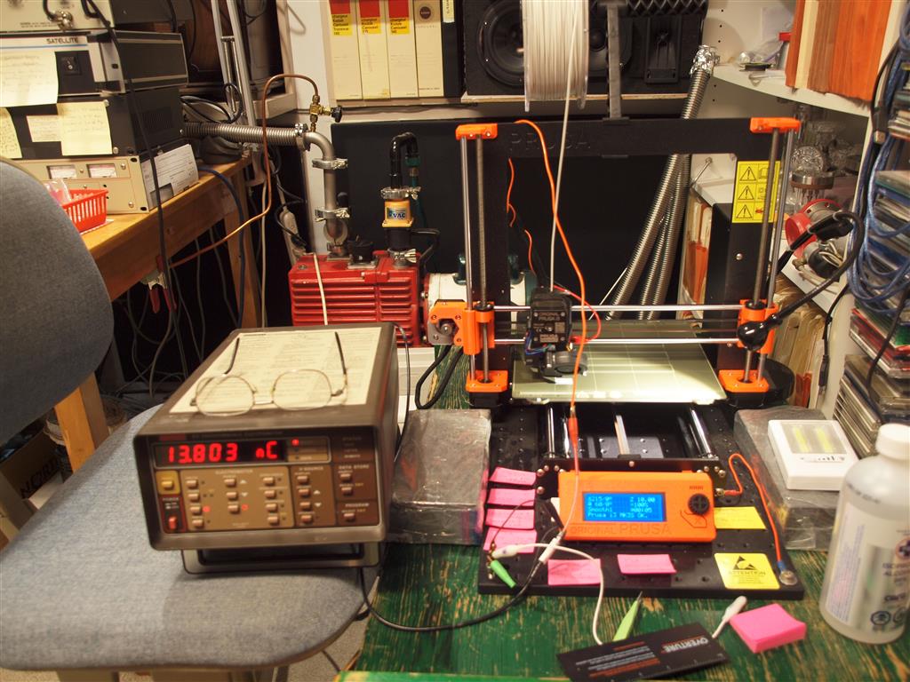

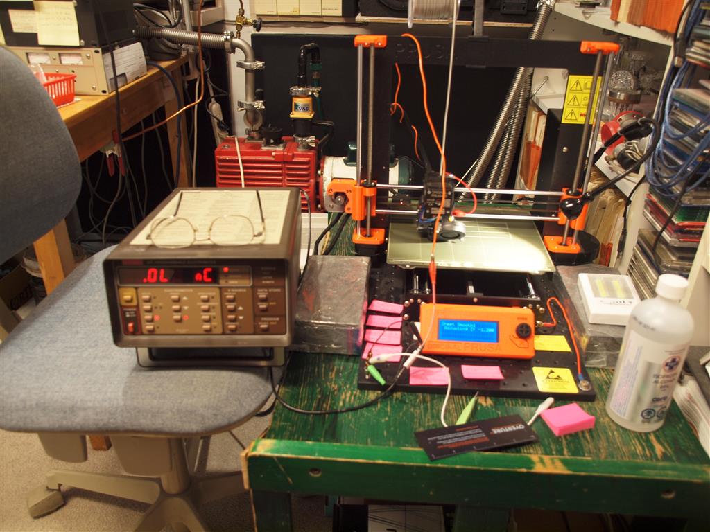

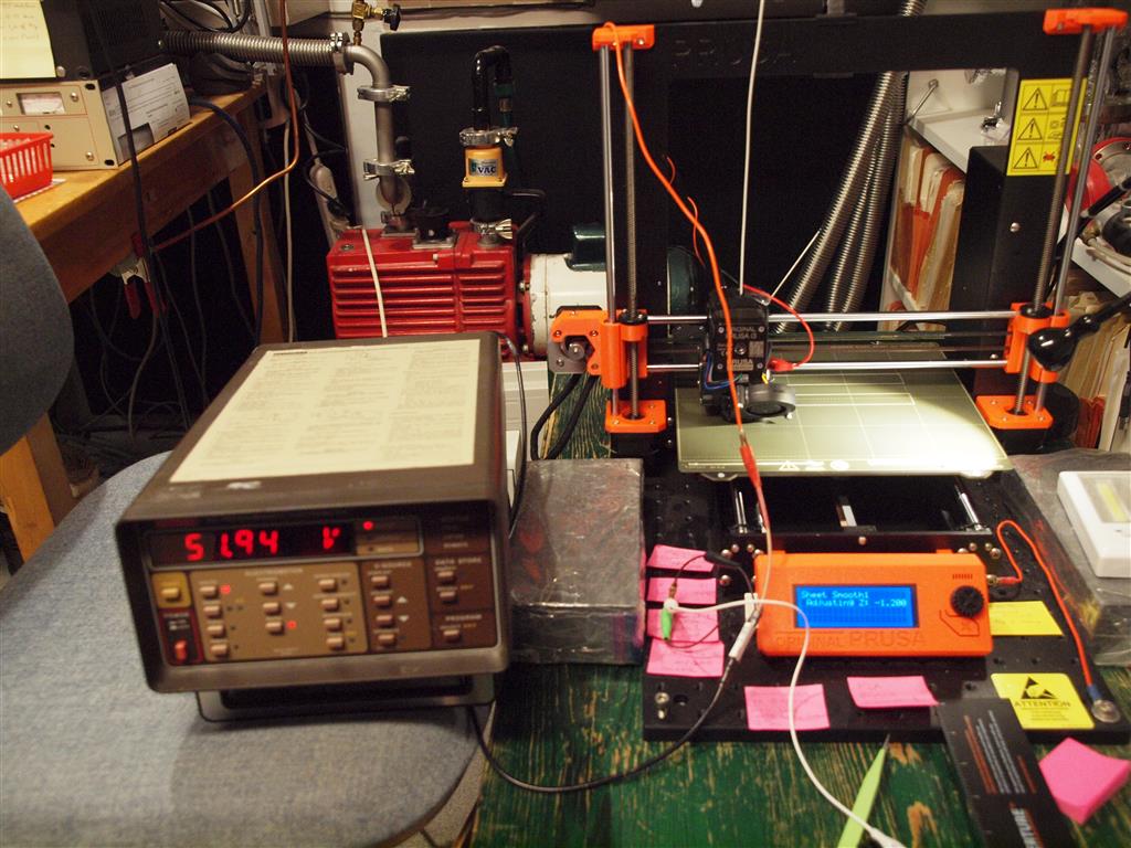

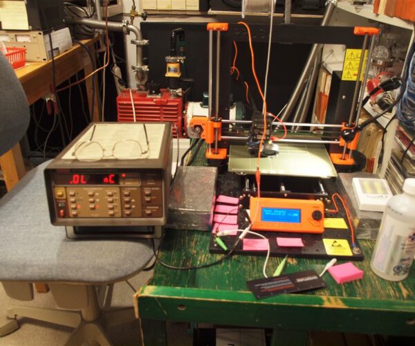

OK. Just did a quick experiment with a Keithley 617 electrometer.
I connected the extruder cooling find with a flexible wire following the ombilical from the controller board to the 617 input.
I used the first layer cal to test. So one layer only with the zigzag and the stamp.
There is of course some fluctuations near the zero point but no real changes during the bed heating and extruder heating up.
There is no difference during the levelling pinda process either.
However the moment it started to extrude the filament things happened in both nanoCoulomb mode and in voltage mode.
In Coulomb mode it went overflow half way through and with an extra 10nC for a total of about 40nC.
In voltage mode it went to about 50V and to >100V in another.
Putting my hand on the spool (PLA) or rubbing the filament greatly increased the readings.  Looks like the filament accumulates electrostatic charge and delivers it to the floating head to accumulate.
Could it be that with dry filament it is possible to have a high enough voltage to cause a spark to conduct an ESD to the control board via breakdown in the thermistor or heater? On a long print this might cause resets or errors at random intervals.
