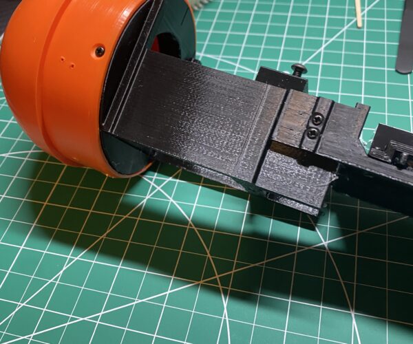

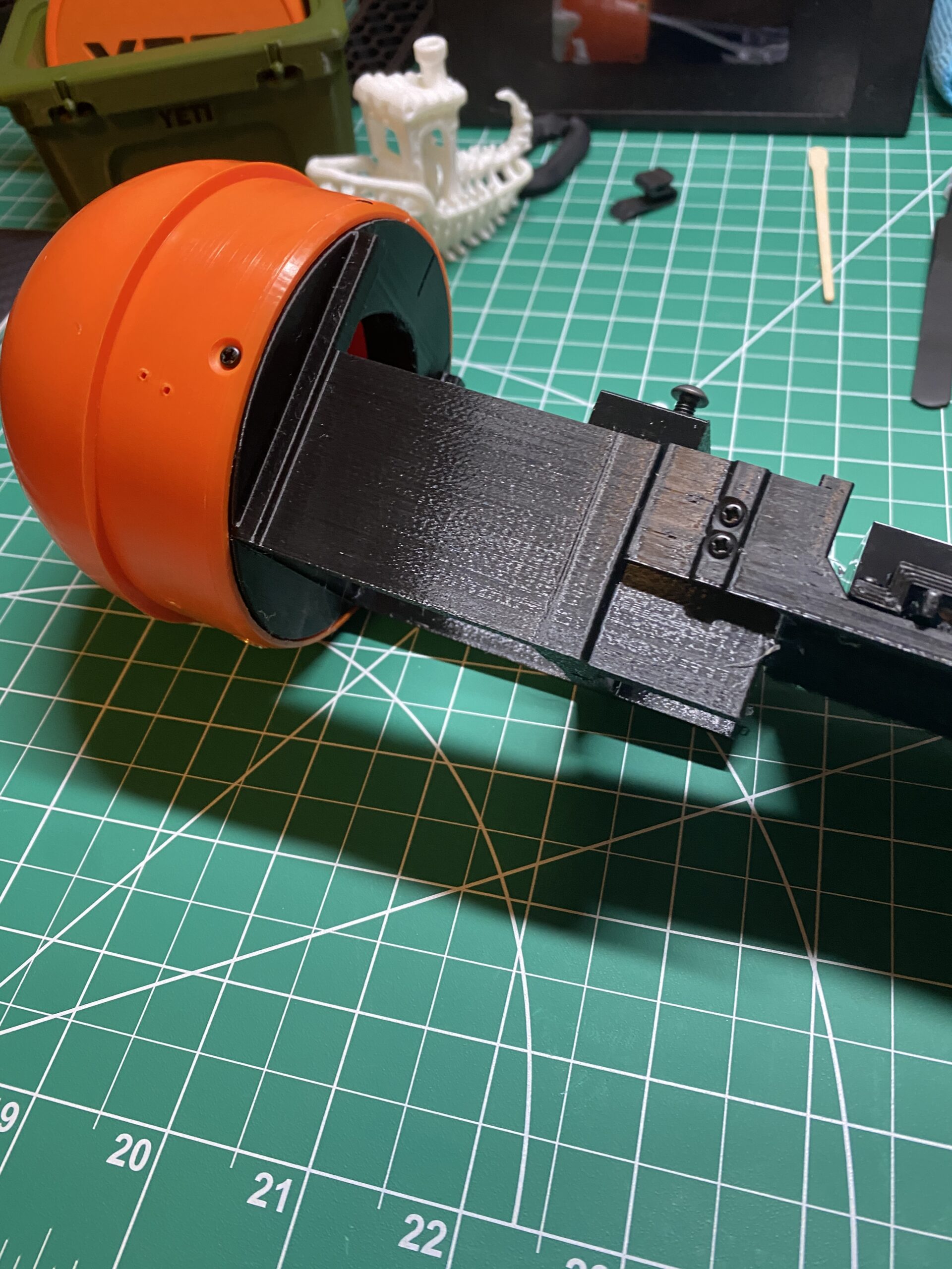

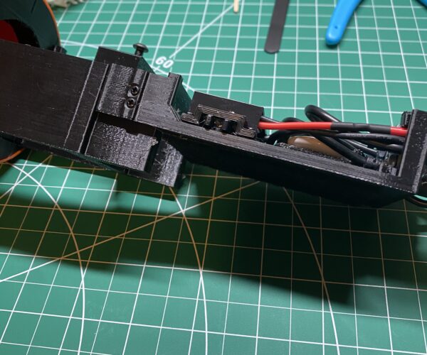

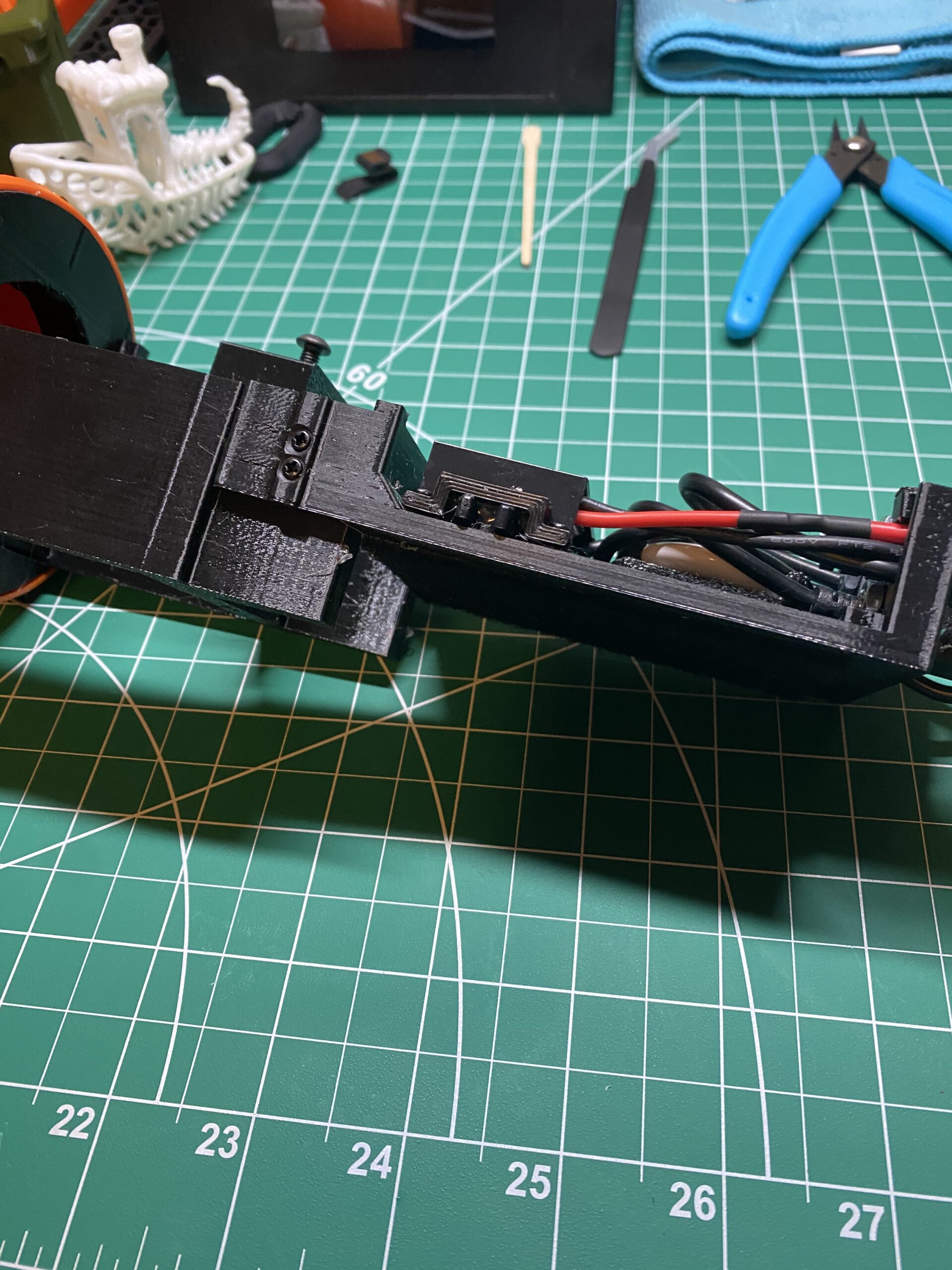

These are photos of the parts I need to make. The black part houses a camera, wifi box and a battery pack.

Whatever design software you use your best friend is going to be a set of callipers for something like that.

I have calipers for the measurements but I was looking at using TripoSR, Meshi.ai or something else that I can take numerous photos of and see what the output is. I'd love to try and create/duplicate this in Blender (import the photo and draw to detail), but I've only been able to create simple stuff in Blender and again...I'm not that proficient with it. It's not a rush project but the owner does need to have the original back in a week and then I can have it back. I went to the website this item was purchased from and emailed them asking if they sell ONLY the internal parts or if they are willing to sell the stl file but I haven't received a reply in 3 days which is what I expected. It's pretty much creating a few cube meshes and extruding some parts and collapsing others. I will give it a try but I know it will not turn out like the same. Thank you all for your inputs. I was trying to see if there was some software out there where I could get the output I needed.

OK,so the original was 3D printed by someone who was happy to trade speed for cosmetic quality and used slightly damp filament ...
You might do better to ask for a step file - or ask for 'step or stl', as that's likely to be used by most engineering shops - PrusaSlicer is happy to use either.
To make your own the first step is to reduce the part to a set of drawings with accurate measurements for everything.
To reproduce?  Almost any 3D CAD package, Almost because it really needs parametric design as your first prototype will probably need tweaking and it's easier that way so I would not suggest TinkerCAD.  FreeCAD could do it though, there are plenty of tutorials on line.  OpenSCAD as I suggested upthread would be suitable as would Blender 'though not for a beginner; most of the other software will be expensive - including Fusion 360 if this is any sort of commercial service (free is for hobby use only.)

I also noticed on the internals it appears to be 2 main parts glued and screwed together with some other smaller brackets that hold the cables and battery pack down. It might be easier to try and take it all apart and see what all shapes/designs actually need to be made. That might make it easier for me to try and recreate. Thank you for the advice and I will first try this in Blender as I'm comfortable with extruding and some other minor tasks. If I can't do it, I'll try FreeCad. I was just reading the past few days of these programs where you simply take a ton of photos of an object and import them and it kicks out the object.
