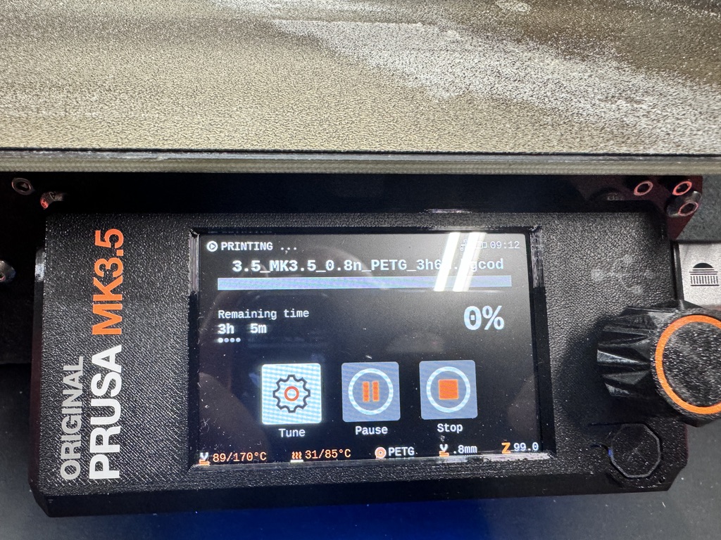

e.g.  The display of the MK3.5 is identical to the MK4, but important information is not displayed. (Maybe @fuchsr would be so kind and post a photo showing this information on a MK3.5 display ! without PrusaLink/-Connect).
Rotates between time spent, remaining time, time at end of print, and I think time to next change (but I'm not sure about the last and too lazy to go to the workshop).

@fuchsr: thats new for me as I never printed from USB-Stick.
Why I can't see this while printing via Octoprint ? How does the printer get and update these informations ?
By analysing the G-Code in its firmware, or they are included in the received G-Code and the printer only displays them ?
