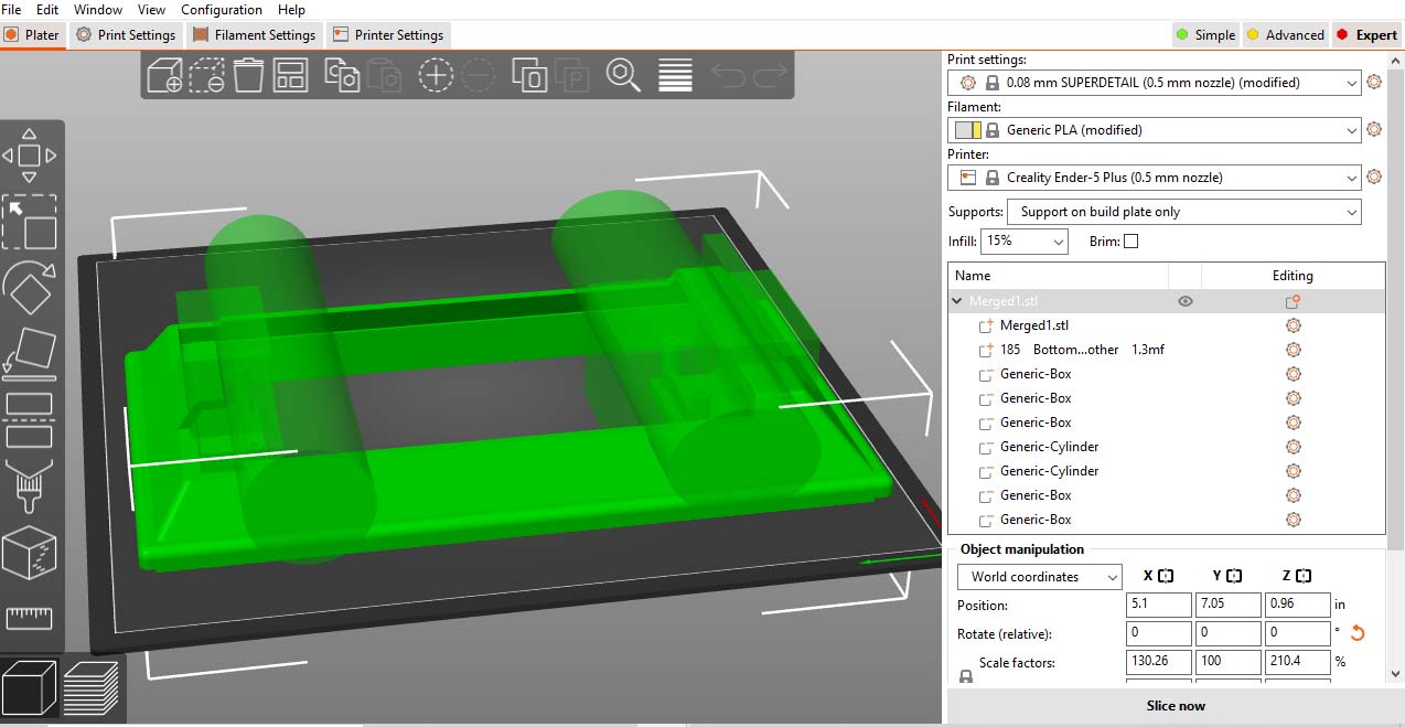

I've been trying to work out an issue and didn't know it it's something that could be done in the first place so I didn't report it as a bug.
I've used a file and have edited it using the Negative Volume to take out things I didn't want in it.
When trying to save / Export the STL  Export Plate as STL/OBJ I get the Error below :
ERROR:Unable to preform boolean operation on model meshes. Only positive parts will be exported.
It does save the STL , however ALL of the Negative Volume areas are removed and it's like I never added any in the first place.
Am I doing something wrong or is there a way to save a file as an STL with all the Negative Volume areas removed.

That is what it is. It does not save stl with negative parts. The best you can save is the project as an 3mf file.
to get an stl like you want you have to use other software, like a CAD program, blender.

A STL file is just a pile of triangles. It doesn't support any distinction between positive and negative volumes, or any actual notion of volumes. Generating a new mesh with the negative volumes removed requires doing boolean operations on meshes, which is very complex and something that I'm entirely unsurprised that they don't want to mess with. The same operation can be done much more easily in 2D during slicing, but the output is of course not a mesh.
If you need a modified STL, you are better off using an actual mesh editing program to do the job, not a slicer.

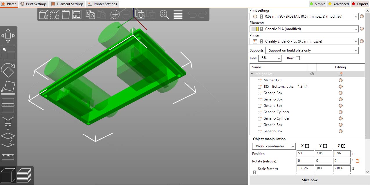

Thank You for your response.   And I too have 100% No Idea on how this works.
The file I'm working with , I've already printed it a few times.  I'm bracketing it to get the size correct.  And when I print it , I load the STL , it shows the STL ( of course ) but it also still has all the negative volume areas in it.  I'd like to have a way to save the STL with the the negative volume areas removed from the STL itself.
Still working on it by trying other programs but that is where I also get the boolean issue...

As far as I know, the only way to (kind of) work with negative parts of objects, is when the cut tool is used. These can be exported. I did not see any working examples (as said by fuchsr) yet. Would be interesting to study such examples to understand what makes them work.
So what I did (to help you a bit further):
- In prusaslicer:
1. Turned all the negative objects into positive objects.
2. Split the part into objects
3. Merged all the "Generic_***" objects into an stl
4. Same for all the non "Generic" objects (your original stl) into an stl
Exported both as stl (what is easy because both are positive parts now)
Imported them into Blender (but also possible in Freecad and many other apps)
- boolean operation
- where the "negative" stl is subtracted from the "original" stl.
- apply
- delete "negative" stl
- export "result" stl.
All included in attached zipfile.

BTW: There is also a way to do this in PrusaSlicer:
- Turn all negatives into positives (see above)
- Create a "negative" stl by merging these objects.
- Export that stl
And then the new step:
- In Prusaslicer go to add object, scroll down, choose gallery, import the stl into the gallery.
Now you can use the stl as negative part
Maybe you have to move it a bit around to get it on the right position.

Trivial example: Add a box to the plate. Add a cylinder as a negative volume. Reposition it so it cuts a piece of the box. This you can export as an STL and reload it. It works for trivial stuff like this but not for more complex geometries.
Posted : 02/06/2024 12:49 pm
Tried it. And yes it is possible. But also right on: trivial stuff. I could not do anything functional this way. So for daily practice not usefull at all.
