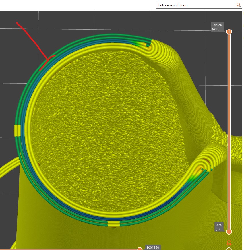

Prusaslicer Perimeter Space
As you can see there is space between the two outer perimeters which are an overhang. I need these perimeters to touch each other or even overlap. I have tried every setting I can think of so either I haven't found the proper setting or this is not able to be overridden.

Imagine that! With "Thick Bridges" on the perimeters get thinner.
So, Thick Bridges was the problem. This explains why I did not see this problem before. I forgot that I checked Thick Bridges.
Weird isn't it? Why would Thick Bridges be thinner?
